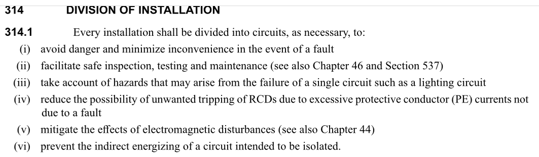

Quite so. It's that bit of 134.1 that Harry quoted (about 'minimising inconvenience') that results in most of the debate and differences of opinion - since one man's 'serious inconvenience' is another man's 'trivial annoyance, once in a blue moon'.

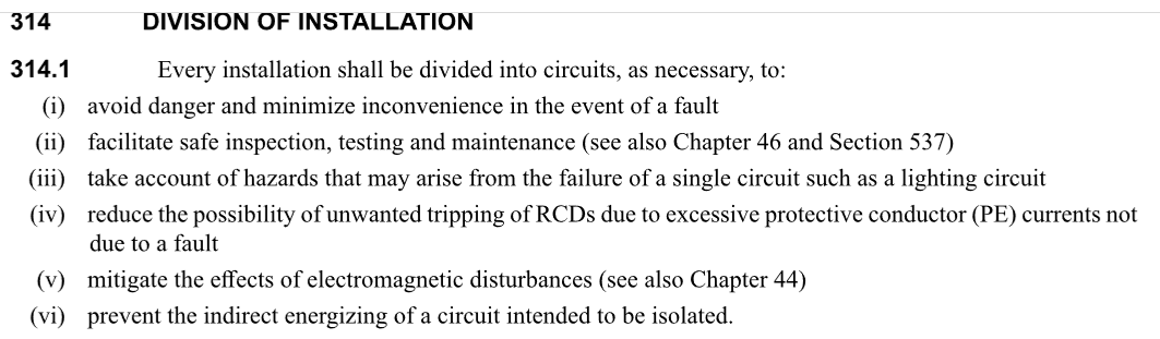

.... 314.1 (iii) such as a lighting circuit.
Just an example, there are many others which could be listed..
(i)..minimise inconvenience.
It's very inconvenient, if your fridge, or freezer circuit develops a fault, when that circuit is a shared one which includes much of the house. For the normal householder, it becomes a very real problem, if the circuit will not reset, and they have to wait a week to get an electrician to attend, and just hope they have the skills to find the issue.

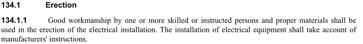

The bit of 134.1.1 which you go on to quote says absolutely nothing about 'minimising inconvenience' but, if you read my post properly, will see is what I was talking about, and what Harry's quote from 314.1 was all about.

It's quite clear to me.
The questions it leaves open are.
1. As others are already discussing how far does one need to go in "minimising inconvenience". If we interpret "minimising" as "reducing to an absoloute minimum" we would need seperate circuits for every item of equipment. Clearly that would be absurd, so either every installation in the UK is non-compliant or we need to take a less extreme interpretation of minimsing.
2. Do we need to take account of the factors in that regulation when designing RCD protection. On the one hand "circuits" are defined in terms of overcurrent protection. On the other hand, my experiance is that RCD trips are similarly if not more common than overcurrent trips, so splitting stuff up for overcurrent purposes but putting it on the same RCD seems kinda pointless if your goal is "minimising inconviniane".
Personally I find it hard to belive that the installation of split load CUs is compliant but the fact is that huge numbers of them are installed all the time by sparkies who are registered with industry schemes. So either the schemes are failing to police their members or they consider the use of such CUs to be acceptable practice.
As I've said, you will probably get as many answers to that question as people you ask, because 'inconvenience' is in the eye of the beholder, and will there varying considerably between individuals
As you imply, it can't be intended to mean that, even though that is probably what a dictionary would say. The 'absolute minimum' inconvenience due to things not being on separate circuits would be zero (if every load and every socket outlet was on a separate circuit) so the word would then be 'eliminate', not 'minimise' - and, as you say, what would be necessary to 'eliminate' would be just plain silly.
I think that's what people always do, isn't it? There have been countless discussions and debates about spreading circuits across RCDs, but never that I can recall about spreading them across MCBs (which, in general, we do anyway?
As above, I don't think you'll ever find a black-and-white answer as to what is, and what is not, 'complaint' in this respect, because the regs are too vague and interpretations and views so varied. I think that some common sense has to prevail. As you say, there are not only millions of dual-RCD (or 'worse') CUs in service out there, but qualified electricians who are members of schemes continue to install them. I say "or worse" because, for example, the house I am sitting in as I type this (which is not 'my home') has a CU with a single RCD protecting all circuits!
If you intend to continue trying to find fault with everything I write, please at least try to get your facts right first. Thanks.
It was 314, not 134 and as you like things to be correct I pointed out that fact. But it was actually post #42 and again in #48 where I quoted the regulation.
134 was what YOU posted. I was just pointing out that 134 has nowt to do with it and you were wrong.
Good grief, again - you don't give up, do you? It's a long way away, but perhaps I should buy you a tooth comb for Christmas.
Yes, it was a typo on my part (I suppose you never do typos?). However, it was surely very clear that I was talking about 'minimising inconvenience', and that that was what 314.1(i) is about, and that is what Harry had quoted in his message that I replied to.
