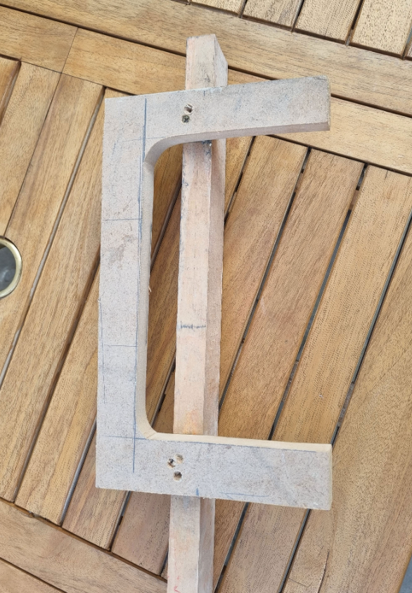

I agree, just make one. I get a bit of board and screw a batten about 1/3 from one edge. Make a cut in the board a bit bigger than the hinge cutaway. Clamp the batten to the door, and with your router and chosen bit, set the bit against the hinge cutaway needed and mark where the outside of the baseplate is on the board on all three sides of the hinge cutaway.
Now cut the jig board cutaway into a U to the baseplate marks.
You now have a jig that the baseplate will run round the inside of, and the cutter will make the hinge cutout as required.
Takes no time to make and works perfectly. Any old bit of ply or chip will do.
