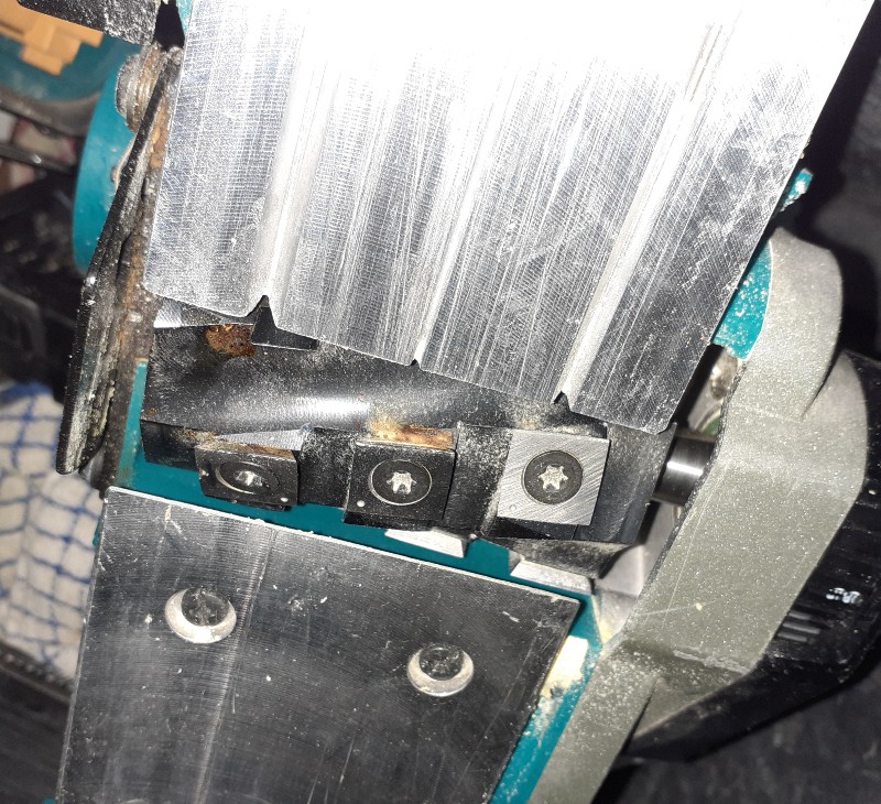

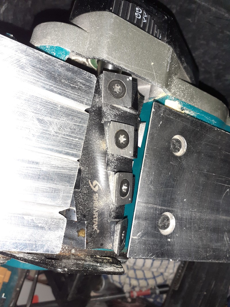

Just to clarify, @opps, here are a couple if pics of the Sheertak spiral segmented block as retro fitted to my Makita DKP181 cordless planer. It sports 14 tips in total, all 15 x 15 x 2.5mm with a 150mm radius edge curve and a 39 degree grind angle
The original cutter blocks are one-piece forged steel blocks with two spiral cutters which need to be ground in situ on a spiral jig (that jig actually rotates the block as you pull the block across a cup grinding wheel secured at the end of the planer tool shaft). Later cutter blocks had two spiral twist tungsten carbide blades brazed onto the steel block. You can just see one (badly abused) block mounted on the sharpening jig in my photo. These blocks have been unavailable for more than a decade and I have been quoted £100 a pop to have copies manufactured in China, in batches of 25 (best UK price wasvobmver £200). This is not going to happen. Fortunately I managed to buy three brand new blocks when I was in the USA about 20 years ago, but TBH I am seriously considering converting the planer to use a spiral segmented TC-RT cutterblock. I have already done a similar conversion on my current Makita DKP181 (cordless) and the planed surfaces are like glass.
Those were not what I was expecting. So you can rotate each "blade" 4 times? And the other side of the block has blades that catch the bits missed by the first set?
Yes, 4 times. The block on my DKP181 has 4 rows of tips in a 4 - 3 - 4 - 3 arrangement (if you look at the two pics one shows 4 tips, the other 3)
