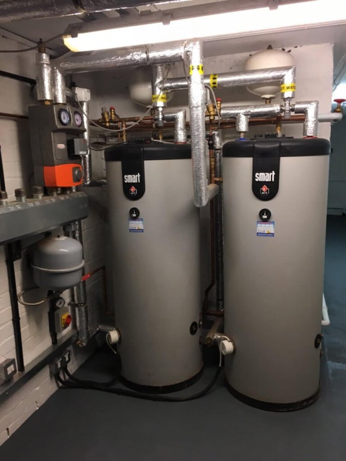

We fit insertion sensors to most UV cylinders. Vaillant cylinders are nothing special. At all.
Best UV might be an ACV. Price puts off most punters. Tank in tank design allows smaller store, faster reheat.
