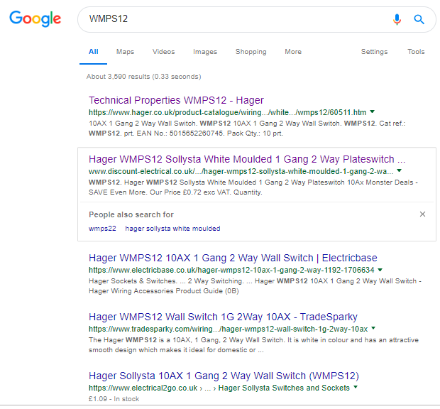

WMPS12 ... doesn't seem to be listed by TLC ... nor any of the chains near my little town
A Google Search for WPMS12 gets over 3,500 hits. Just on the first page, there are several people selling them, the first being Discount-Electrical, who are selling them for 72p+VAT each.

your google is certainly better than mine, then.
even if I spell it right.
your google is certainly better than mine, then. ... even if I spell it right.
