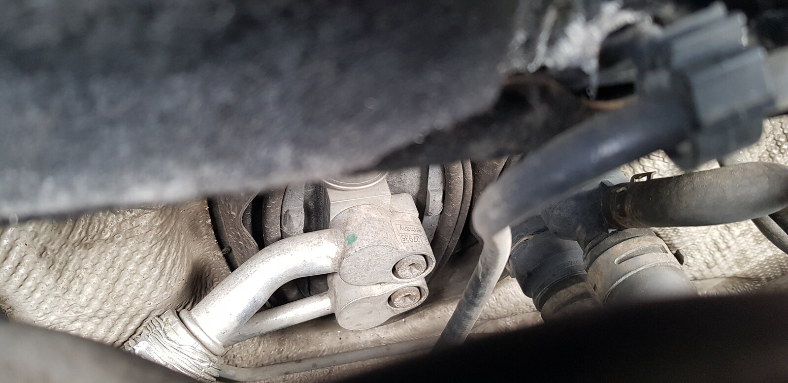

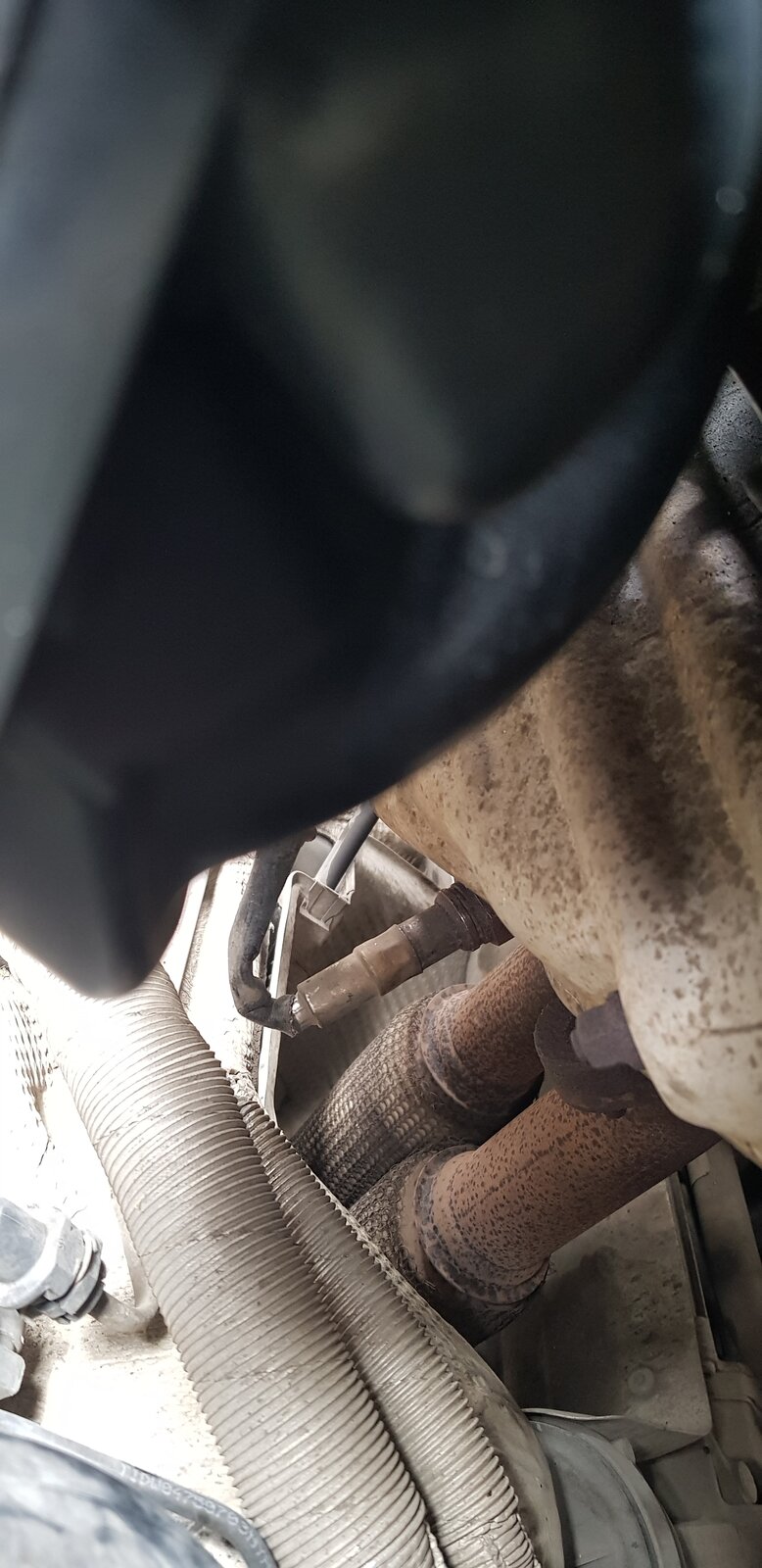

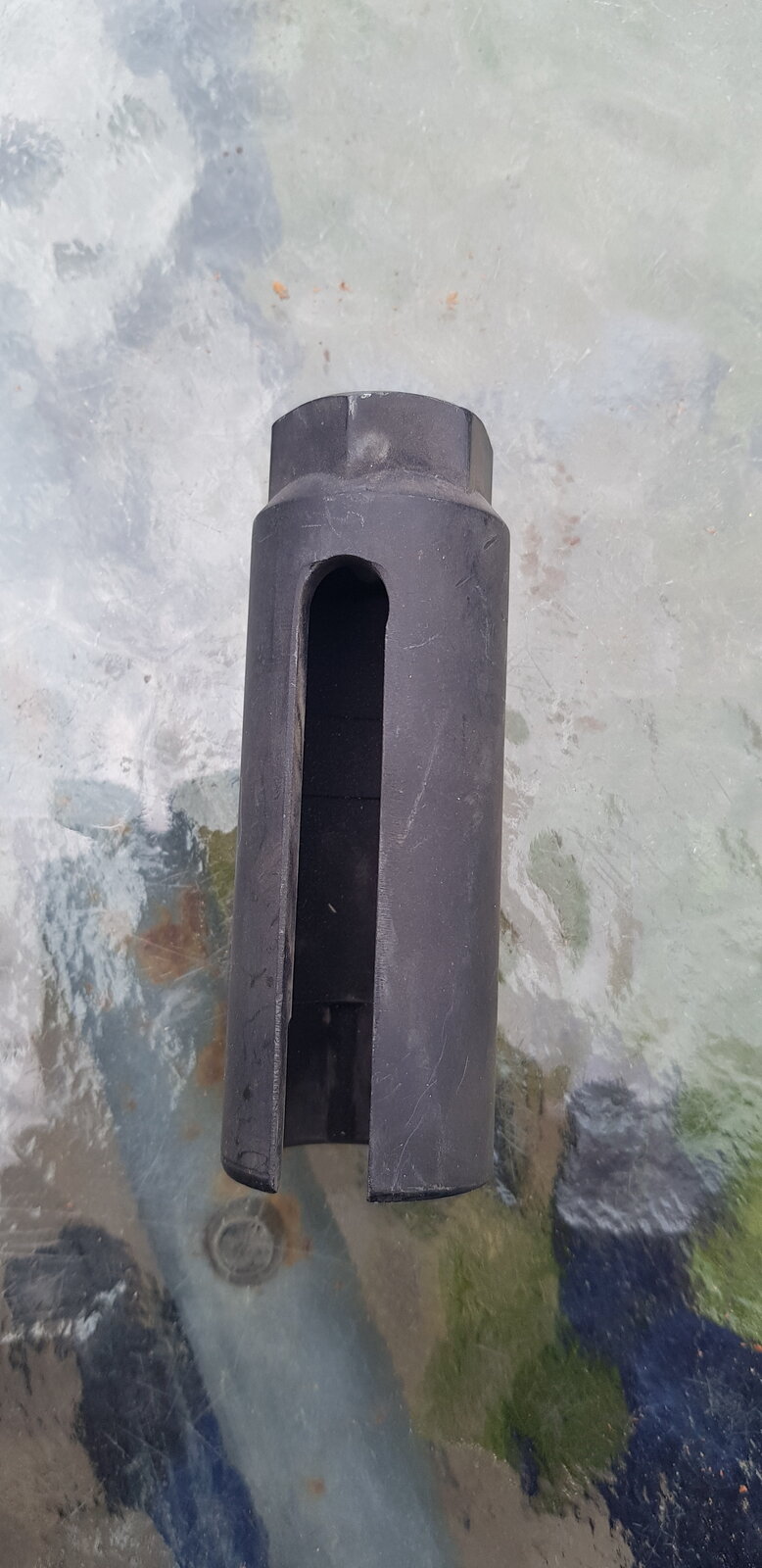

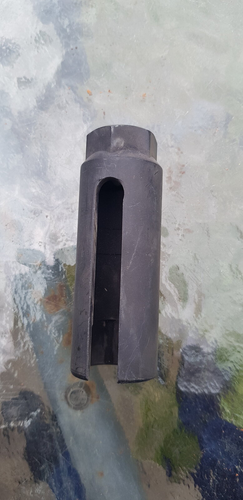

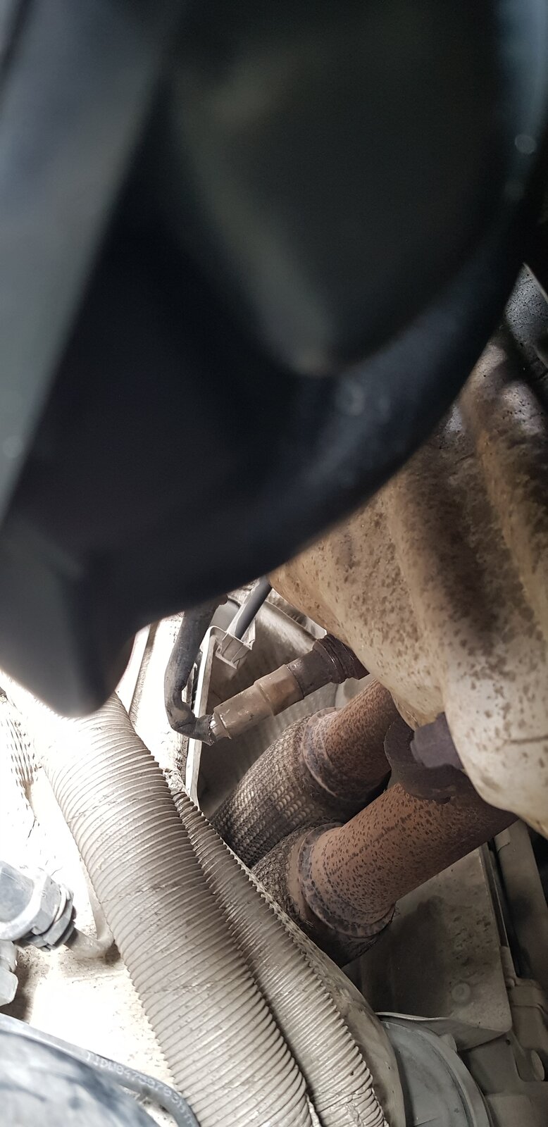

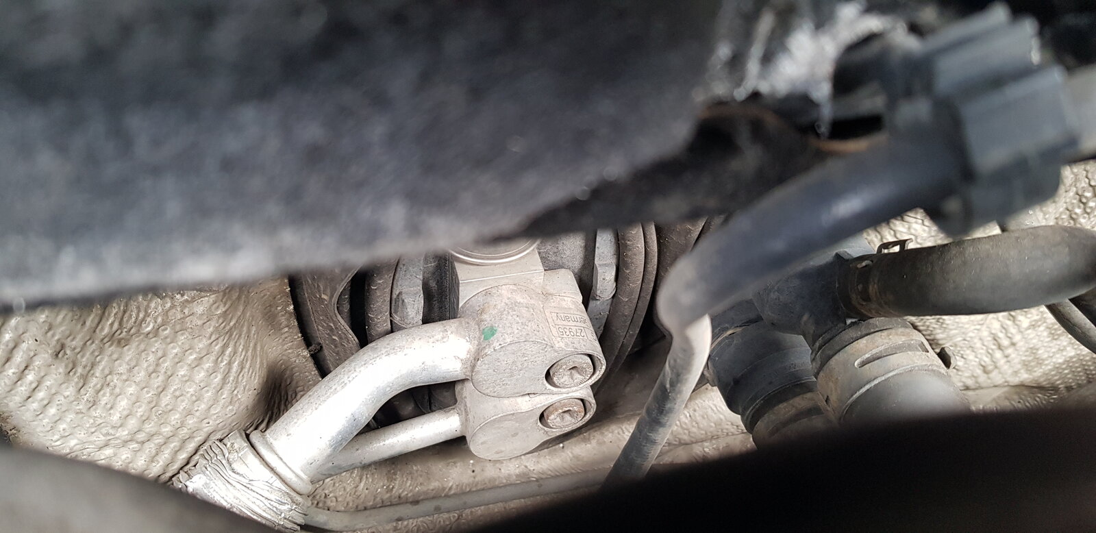

The sensor is in a bitchh position, so to make my life easier I bought the special tool (picture attached)
But, there are pipes in the way and, unless I'm mistaken, they are AC pipes that cannot be disconnected to access the sensor.
Or am I wrong? (I hope I am)
Could I loosen one of those pipes) possibly undoing the bolts in the last picture?

Sorry to say. There are other tools available which should give you access.
Be warned, if its very tight, its easy to strip the threads in the exhaust!!!
Yes, I've seen a few pictures online.
I've been spraying wd40 every day for a week now, so hopefully it will just come out nicely.
I found this tool:
And this:
Which one would you recommend?
