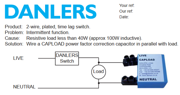

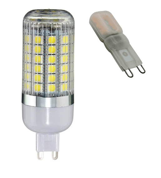

G9 bulbs caused a problem, the bulbs were flashing, so added a load capacitor load-capacitor.jpg but also a shimmer when used with Energenie wifi switches, the small bulb G9-comp.jpg was replaced with one tungsten which stopped the shimmer, then wife found the larger bulb on the internet, of the 5 fitted, one did not even last 24 hours, so ordered replacement and prized open the faulty bulb to see how it was made, the smoothing capacitor was larger then the whole smaller bulb, also found dry joint which was repaired and it was returned to service. Wife wanted fancy lamp so we got a pair of colour changing smart GU10 bulbs, tested on in kitchen lamps, which failed.

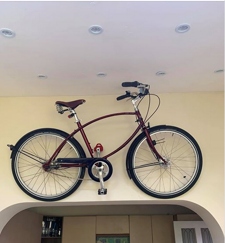

So now nearly all LED with only around 4 lamps failed. However son when he moved into my old house replaced the LED tube with an array of GU10 down lighters from toolstation, Kitchen bike.jpg and he has had a lot of failures, he blames cheap bulbs, but same room where the 5 foot LED tube failed, and no SPD fitted in my old house.

The load capacitor may also be damping surges, and also the smoothing capacitor inside the bulbs. Having an aerial supply or under ground supply can also affect if prone to spikes. Likely my toroidal transformer also reduced any spikes reaching the bulbs.
