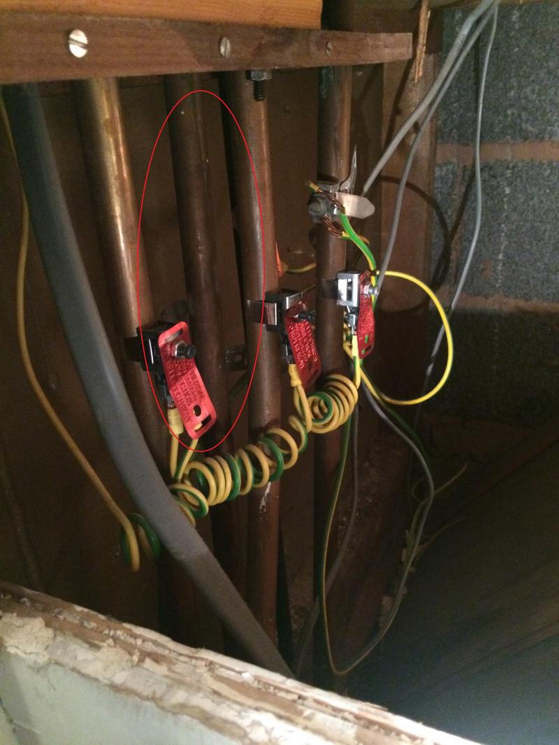

Want to get one fitted buy thought I'd check which is best to go for. I've seen magnaclean, fernox tf1, and spirotec magnabooster
Also I am unable to fit on return pipe to boiler due to pope work and location (back boiler), and other option is on the flow before the pump

Just need to check there is enough space before pump to install
Not much space as its above the stair slope, and typical the pipe i need to connect to is at the back, but may be doable by adding some elbows the bringing the pipework forward, although access is limited
Have also been recommended the trappex centramag

Ended up buying the trappex online. Should be delivered in a few days and I'll try fitting it saturday.
Not looking forward to working in that tight space
