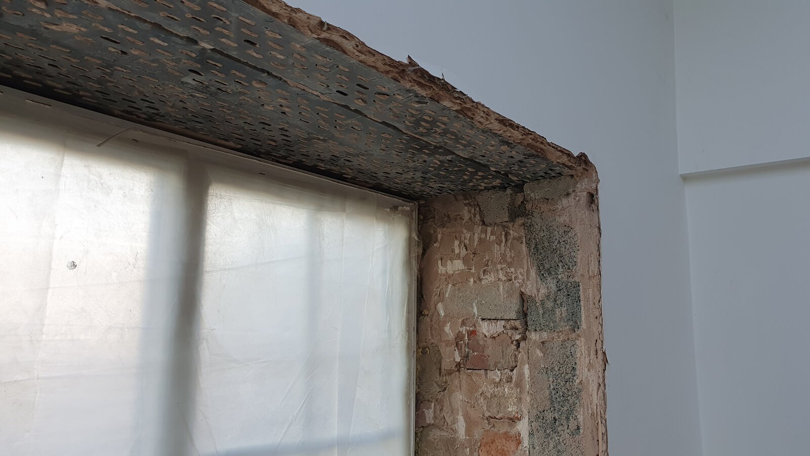

Question for the experts: do these steel lintels need fire-rated plaster/board protection?
My suggestion of e.g. XPS marmox boards, skimmed over, doesn’t provide that.
12 months later:
I filled every gap, every dent, every hole in the lintel with expanding foam.
Then we used 10mm aerogel blanket on the 3 reveals, covered with foil vapour barrier then 6mm mgo board.

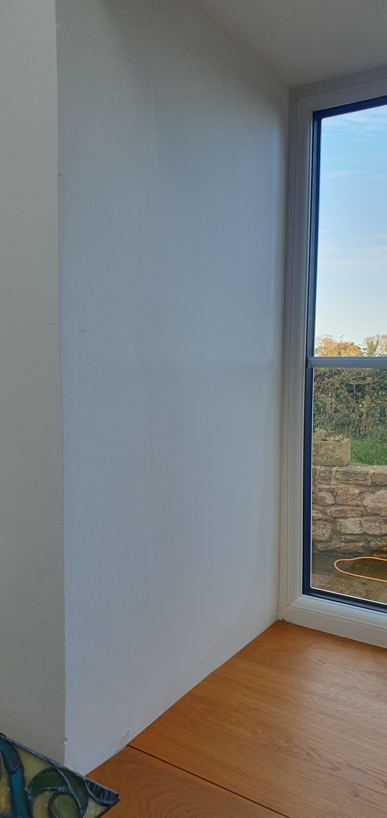

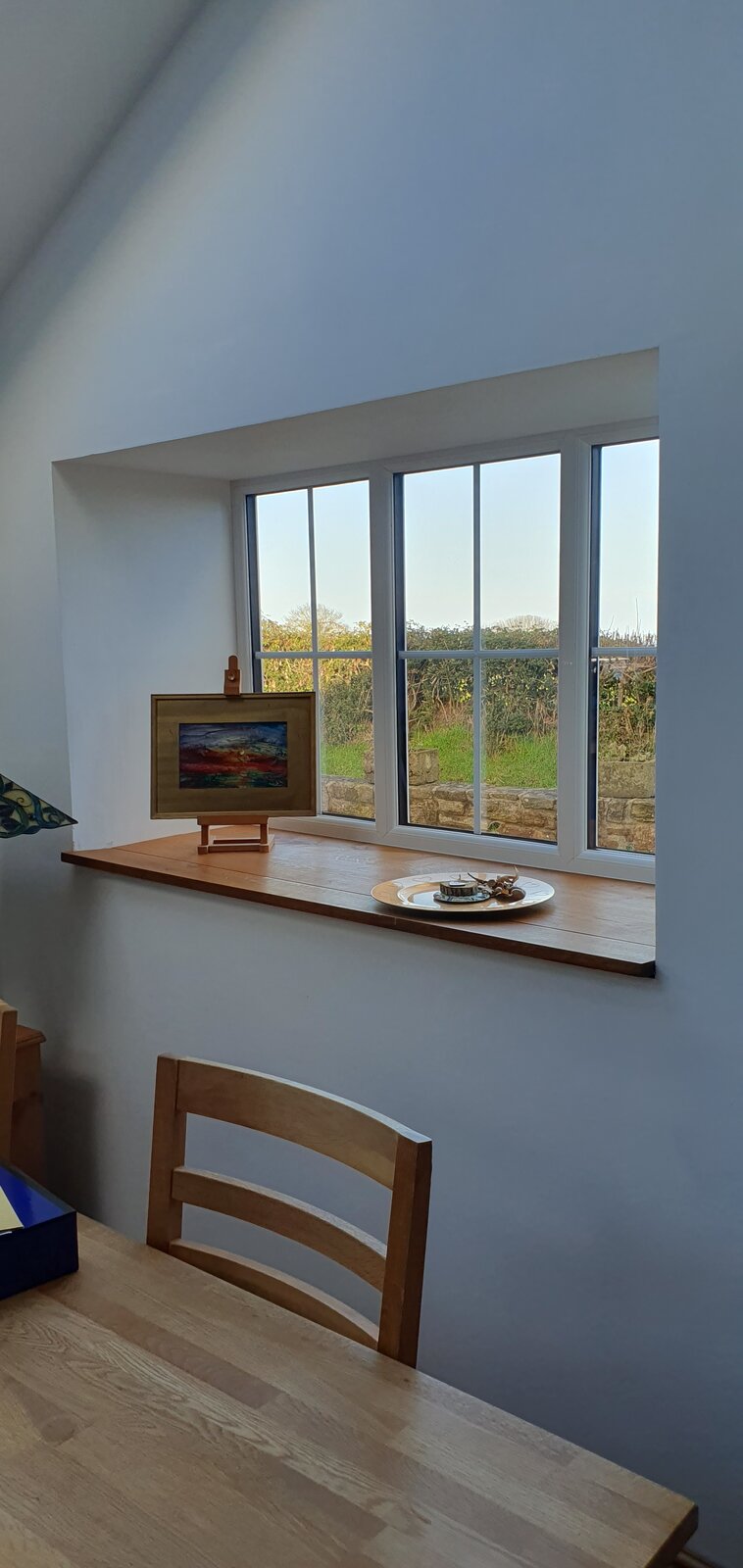

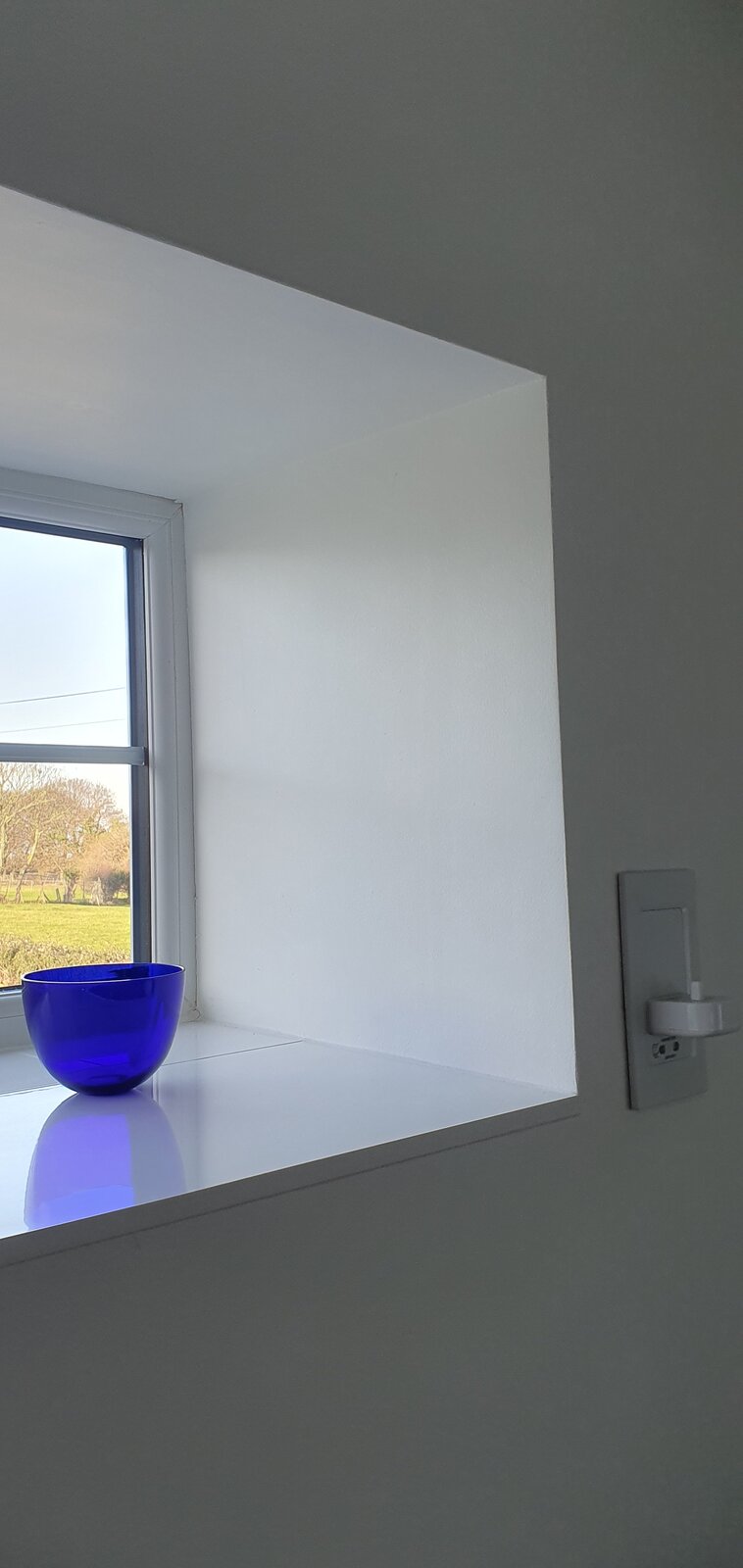

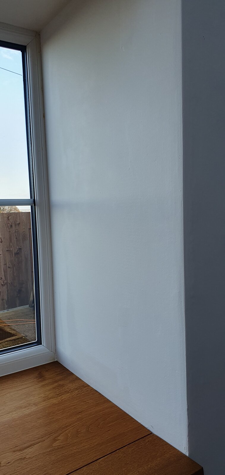

That was nearly 2 years ago, and what a difference it has made. No drops of condensation, no cold air circulation, no mould!

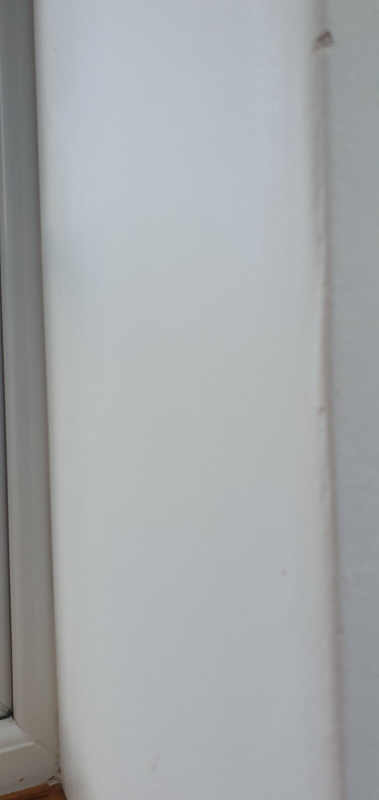

Here are some photos. Not sure they'll be much help though. Maybe they will encourage you to do a better finish than mine! I used paper tape with the metal strips attached on the outer corners and dry lined. Obviously they are not really strong enough for wall corners generally, but they're ok for us.
You can see on the photos how near I got to the window frame. Maybe you can also make out that I only dry lined and feathered the edges and didn't plaster (with easyfill or similar) the whole board. I printed with an acrylic primer/undercoat and then just painted on top.

No, on the external corners I just used reinforced paper corner tape. Eek.

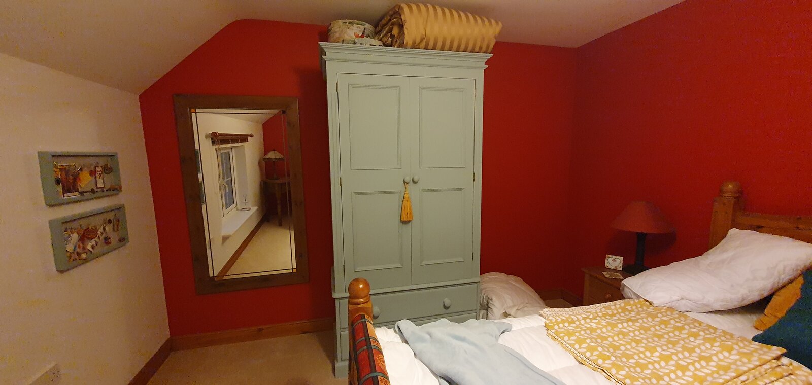

Just in case it's of interest, here is a picture of my first experiment. Approx 6 or 7 years ago. I had plenty of room here.
Spare room, the external wall behind the wardrobe used to get black mould. Had to keep bleaching it clean. Furniture was all 8" off the wall for circulation. And it made the house soooo cold. In the end we just closed the door and let it all go mouldy till the spring.
The plaster was in good condition so after bleaching it clean and scraping any loose paint off I instasticked 100mm of foil backed insulation board to the wall and meticulously sealed all joints, damage and the edges with foil tape to ensure no warm air could reach the cold wall behind. Then I stuck the plasterboard up, dry lined, painted and put the old skirting board back on.
The difference is miraculous. We don't heat the room unless guests are there, but we leave the door open now. No draw of cold/warm air at all and probably never goes below 13° in there I should think. No mould, no smelly clothes, no musty mattress.
And as you can see from the photo, you wouldn't know to look at it.
