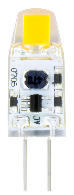

After @bernardgreen post I went to look at what it said on adverts some clearly state AC/DC but others say nothing, although the picture 1688302615779.pngwith AC between the pins does seem to suggest AC only. Yet the use of a chip seems to point to power being rectified and smoothed. But on going to company web site a couple were marked DC only, but nothing found saying AC, and they seemed to be marketing drivers which were DC to power them.

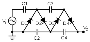

It is possible that the lanterns used a diode pump to produce a DC voltage greater than the RMS voltage of the AC to supply several LED elements connected in series
Diode pumps depend on the supply being AC

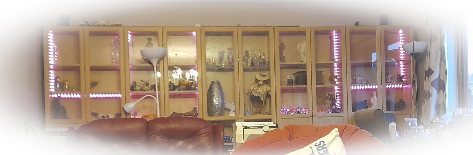

But we the home owners have now got to find a way around the withdraw of tungsten lamps. The chandelier I fitted was because the largest BA22d LED bulb did not equal the amount and spread of light we got from the old 150 watt tungsten, the 100 watt tungsten would just about light the room, but a 15 watt LED just was not good enough, so now 8 x 6 watt LED's. And that is supplemented by the display cabinet lights when required 20230227_170900_1.jpgthere is nearly 58 watt of lighting when those lights are turned up full, three sets of strip lights. So 106 watt with everything turned up full, OK not normally turned up full, but the fact remains the 100 watt tungsten has been replaced with 106 watt LED, how is that a saving?
The problem for most is cost, each strip light either side and there are two was £25 each, the centre strip Lidi was around another £20 the chandelier around £100 the bulbs £16 the plug in ceiling rose around £20 so over £200 to do the lighting, and now about to fit a smart switch so we can turn on lights from the chair when I nod off watching TV and the TV times out leaving me in total dark.
