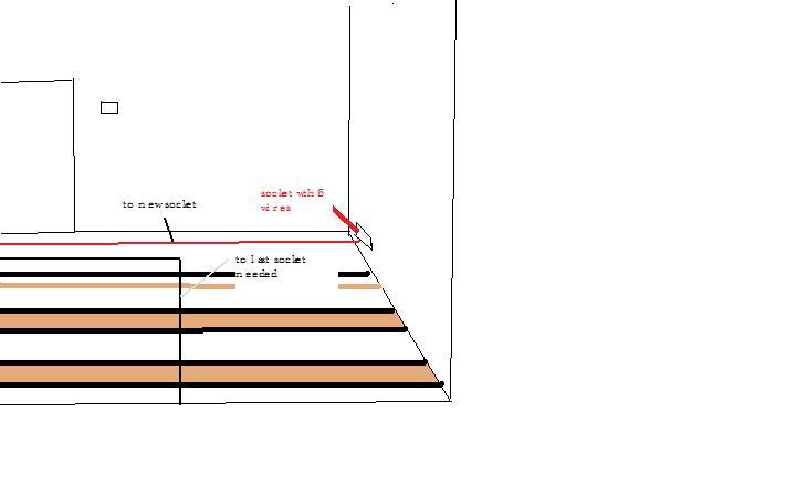

here is a diagram of what i want to do (it looked better in my mind)
[/img]
i guess your trying to tell me im not on the ring main? there are six wires going in but i traced the 3 wires back to an old storage heater so now im left with only 3 wires. so in order to assess that im on the ring main i do a resistance test?

3/6 wires going in to where?

If you don't have a ring arrangement present at the sockets, you possibly don't under the floor either.

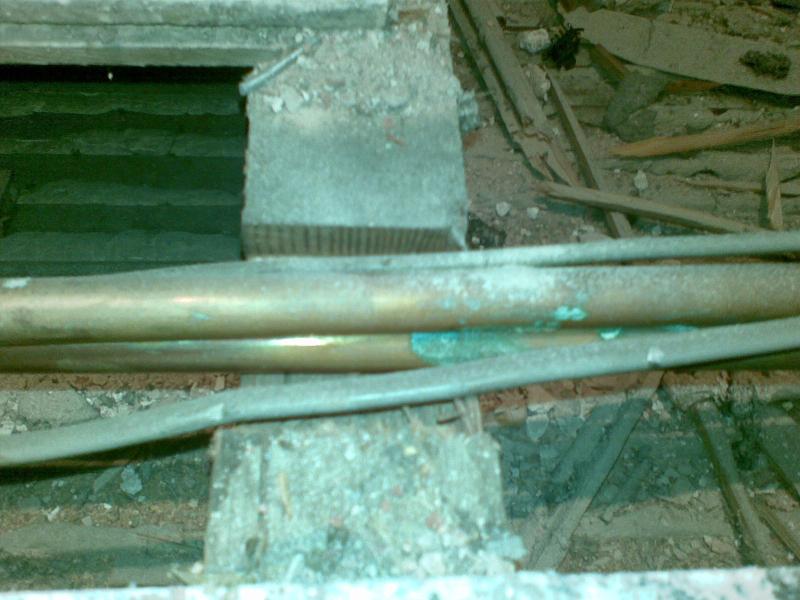

Still have no idea how many wires are in each socket.

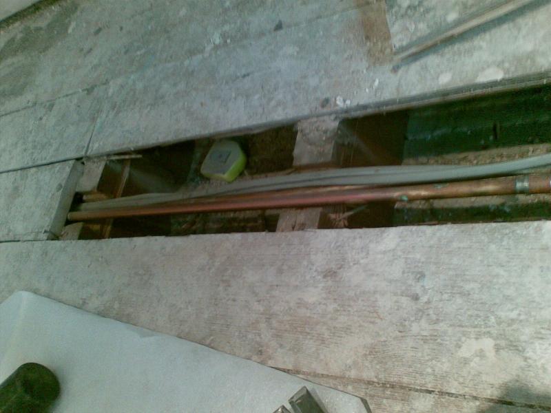

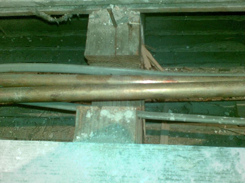

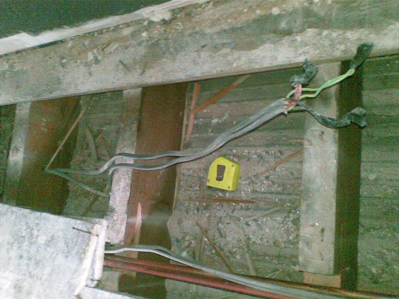

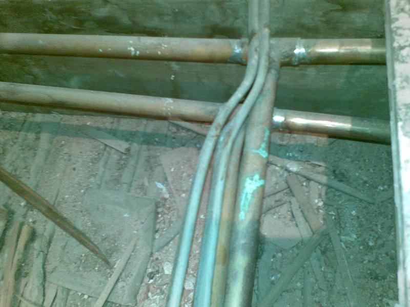

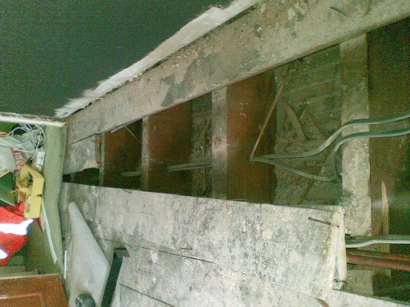

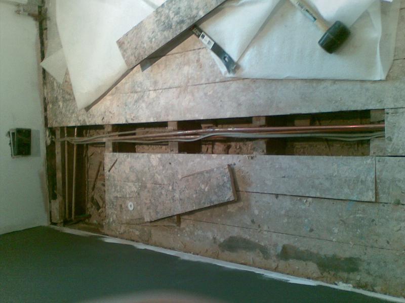

Those cables look damaged. You should think about replacing them & re-routing them to prevent future damage.
They are PVC, aren't they?
there is only one socket in the room at present.
in this there are 6 wires running from two cables, which look to be running from another room but i cant lift the boards there. there is also another 2.5 wire this was supplying the heater as i mentioned. yes they are pvc and i will re-route the under the pipes through the joists.
im at a loss now because i have only 3 wires into a socket which i've tested as working, and all the other sockets in the house also work so its put to sleep my idea that it was supplying another socket somewhere else in another room
here is another picture of the cable that was supplying the heater
