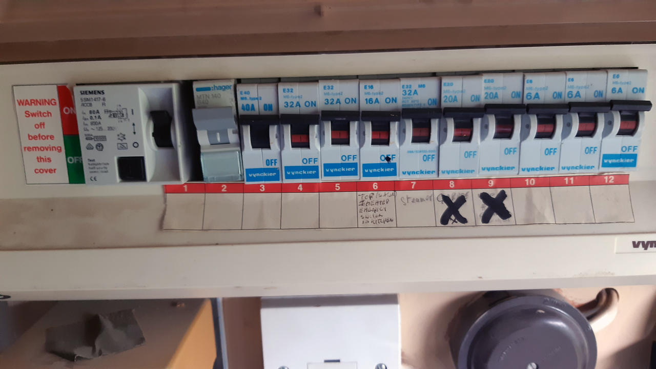

I basically agree although the contactors are too small to supply a CU, as is the wiring which looks to be about 2.5mm/7/0.029" So I'll guess they control the 16ish Amp circuits but only 12 by the looks of it.

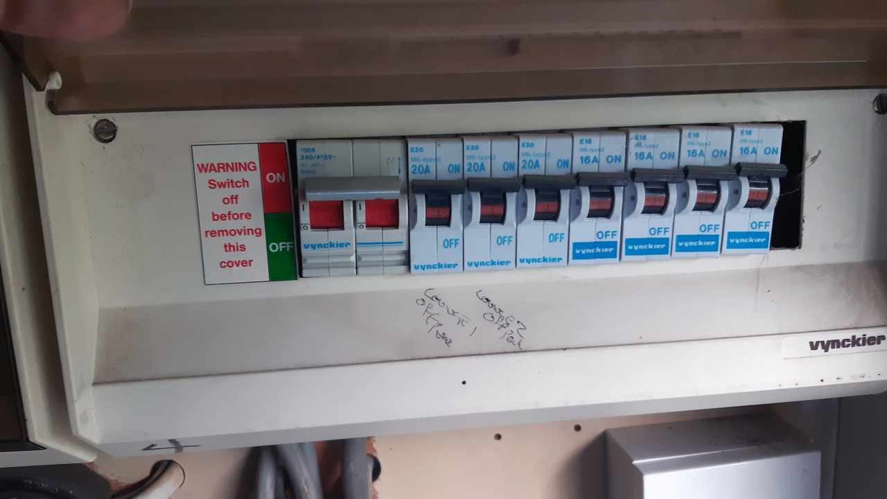

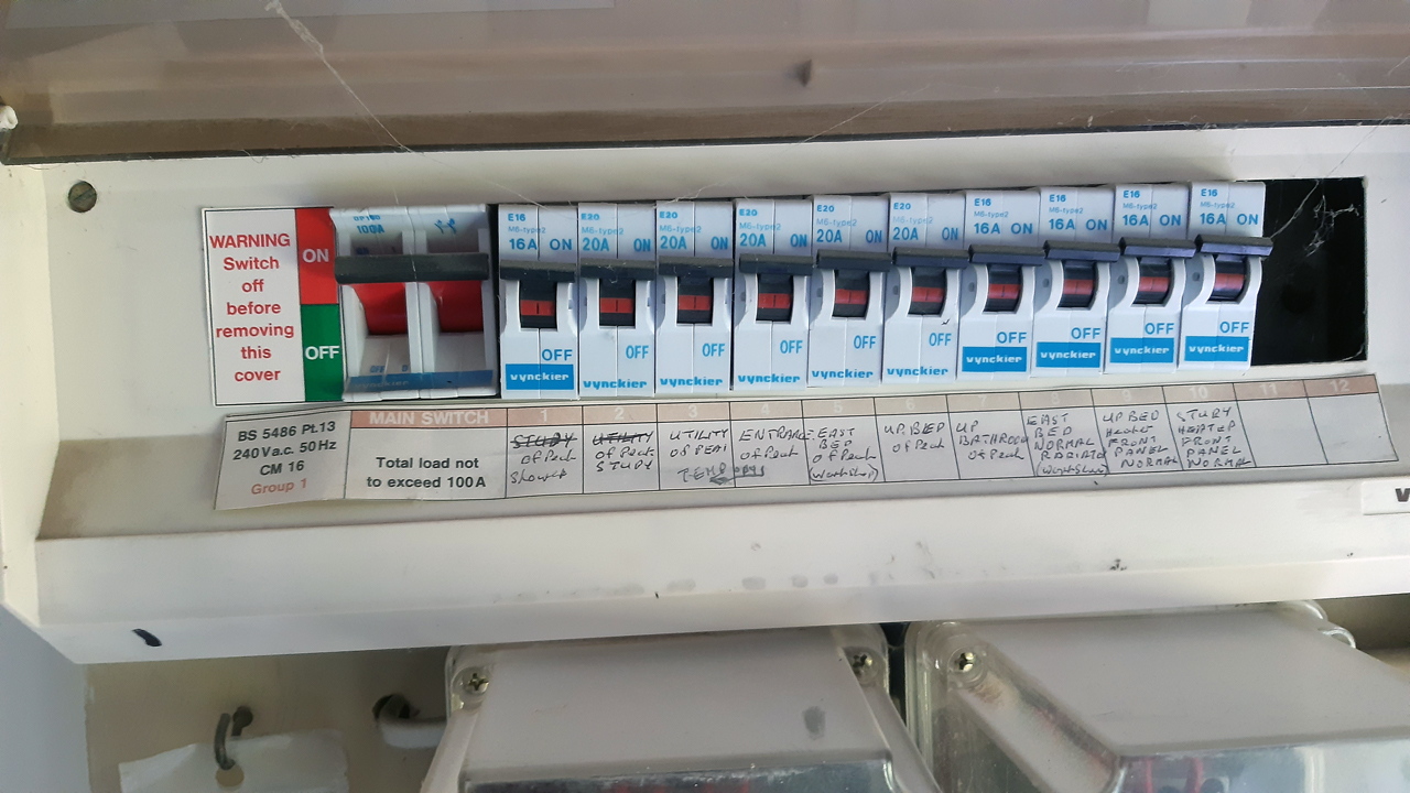

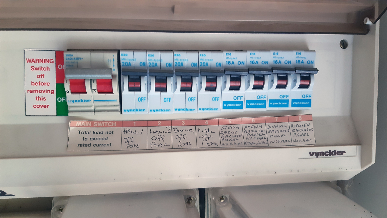

Hallo all again. I took the pictures this morning as requested and they are below. I know it is a lot later now but literally about five minutes after taking the pictures almost a dozen of my partner and I friends turned up for an impromptu house warming of sorts. Apparently my partner had arranged it as a surprise for me which I found rather odd as the house is completely upside down especially as I moved so much detritus from the area of the electrics so I could get some pictures for you fine people. Ah well such is life.
The last of our guests only left about twenty minutes ago so I thought I would put the latest set of photos on here for you all to interrogate and digest as you all see fit.
I must admit that I am not sure that any of them will be particularly helpful as a lot of the switches do not appear to have had any notifications appended to them so hopefully any electrician who will agree to take on the work will be able to decipher what on earth has been connected or disconnected and to or from where. I can only hope that the actual wiring running around the property is not as what appears to be as hit and miss as these boxes are.
I did find something out today that I will pass on regarding the two large black cables that feed the garage and the brick shed. There was a piece of paperwork stuffed into one of the drawers in the kitchen that said the X switches in the boxes are for the two buildings. Being inquisitive I decided to turn them off and sure enough the power was cut to the buildings so I now feel quite happy that I know what at least two of the 35 switches are for !
Thankyou again for all of your help as it will be nice to be able to contact the people required with some modicum of knowledge and understanding of the system I have in the house at present.
