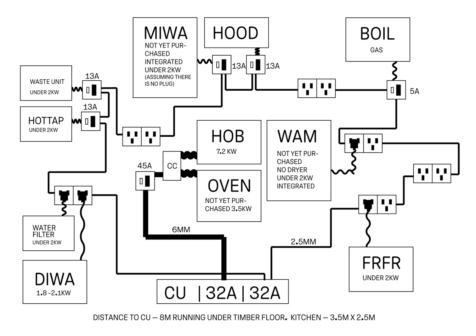

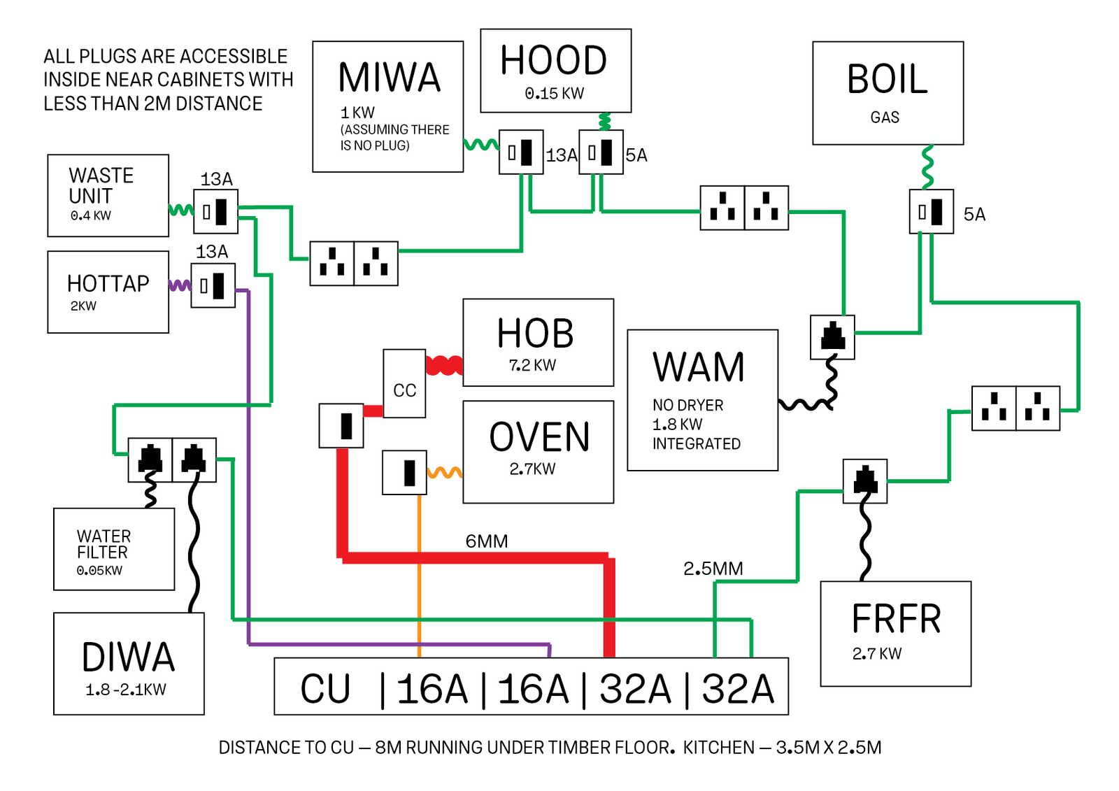

Hi everyone,
please advice and comment on the attached wiring diagram for a kitchen.
There are mixed opinions on the need for FSU-s and number of circuits required.
Distance to cu – 8m running under timber floor. kitchen size – 3.5M X 2.5M

Two rings seems excessive to me however, there are quite a few appliances.
Why rings? Perhaps one ring or two radials.
I prefer the oven and hob on the same circuit and would also have the hood.

So ether way is within regs? (Just checking: are you certified electrician?) thanks
Hob and oven can go on the same 32A circuit.
2x 32A rings is pointless, either have 1x 32A ring or multiple radials if you want things on separate circuits.
Are you certified electrician ? Thanks. Seems like majority is for separating hob and oven though . At least from my "current" knowledge . Checking similar forums elsewhere and asked my previous certified electrician. I would probably put 20a mcb on oven circuit
