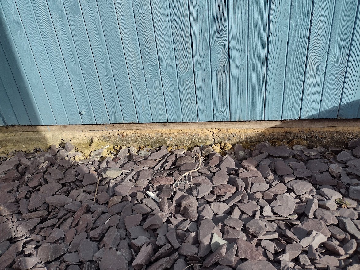

I noticed this weekend that water accumulated under items in my shed.
It first, I thought it was just items on the floor, but then same happened with something on a shelf. The shed has a single large air gap and the door is not exactly a tight fit, so air flow should not be a problem. It sits on a concrete base that does not have a damp membrane in it. The base is close to the house soak away, of that is relevant ... but not right next to it.
Could excessive moisture build up underneath be a problem? Should I make some air gaps under the shed, as the base is "closed" and no air gaps (this shed was originally built on sleepers on a lawn so would have had airflow below)

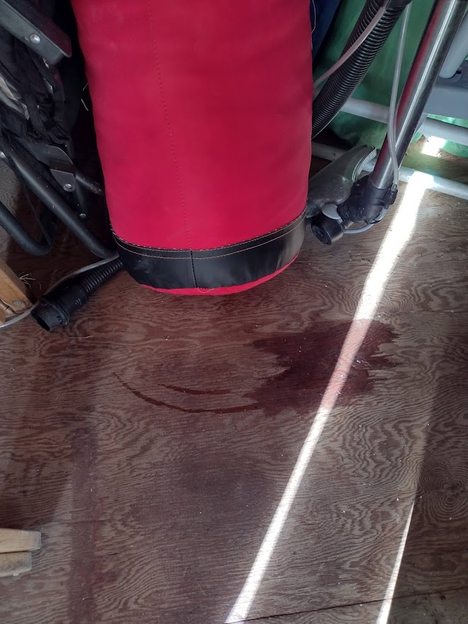

Was wet under punch bag:

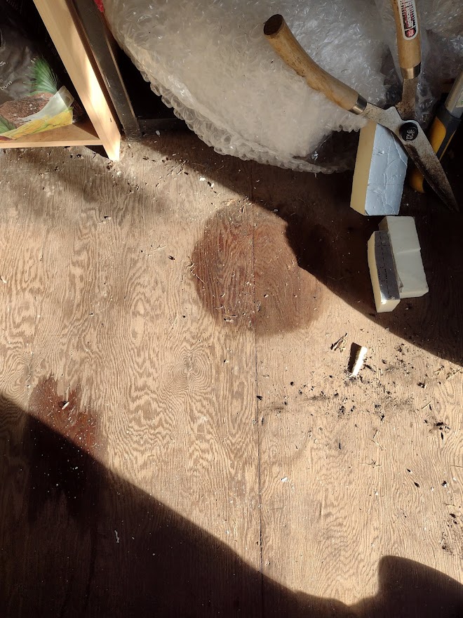

And wet under a bucket (bucket did not have a hole!)
wet patches under things on a shed floor are very common when there is no dpc.
the ground is always damp, so the floor can only be dry if water evaporates off it faster than it permeates through. Putting things on the floor obstructs evaporation. This can also be seen on damp floors and walls inside a house.
it sounds like the void is unventilated, so fix that before the rot gets too bad. there is also a wet corner that might be due to a faulty or absent gutter and downpipe.

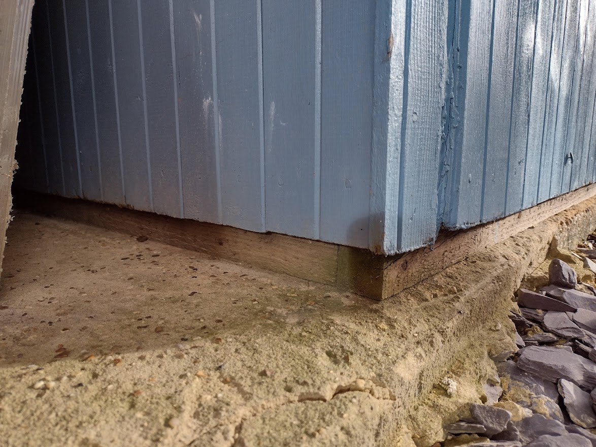

Even if the slab does have a dpc, the shed must overlap it, or rain will fall on the exposed surface and make it wet.
The shed bearers appear to be standing on the exposed slab, so they will be damp and will rot.
I can't see a picture of the wet shelf you mention.

Didn't take a photo of the shelf, only spotted it later in the day. Was a metal shelf with something on it - at first I assume it was all from the floor, but that made me think maybe humidity in the shed was too high.
is the shed off the ground with no timber in contact with earth or concrete ??
ok just noticed your pictures and it needs to be off the concrete with airflow underneath

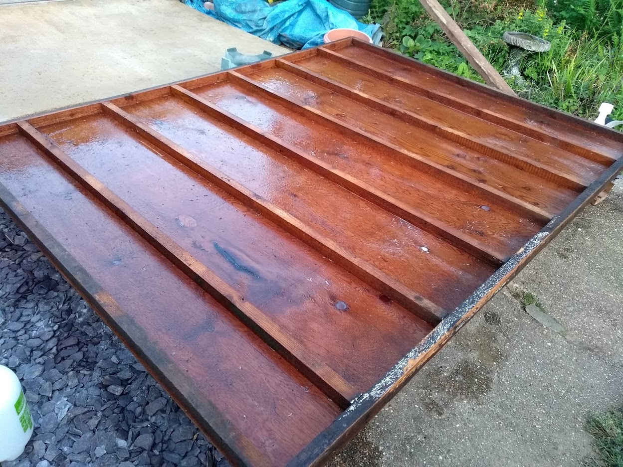

Here's the base - I put 5 litres of wood preserve on it before building it, so hope I can save it!

is it fully sitting on chippings ??
as in earth topped by chipping and ply fully in direct contact ??

It will not do much harm, but neither will it do much good. You need a good free air flow under there. On a dry day, remove everything in there, then use a scaff pole with a flattened end to gradually lever it up off the ground, a bit at a time, working round and round the perimeter. You should aim to have it clear of the ground the height of a house brick, laid flat down. You will need several of them.
