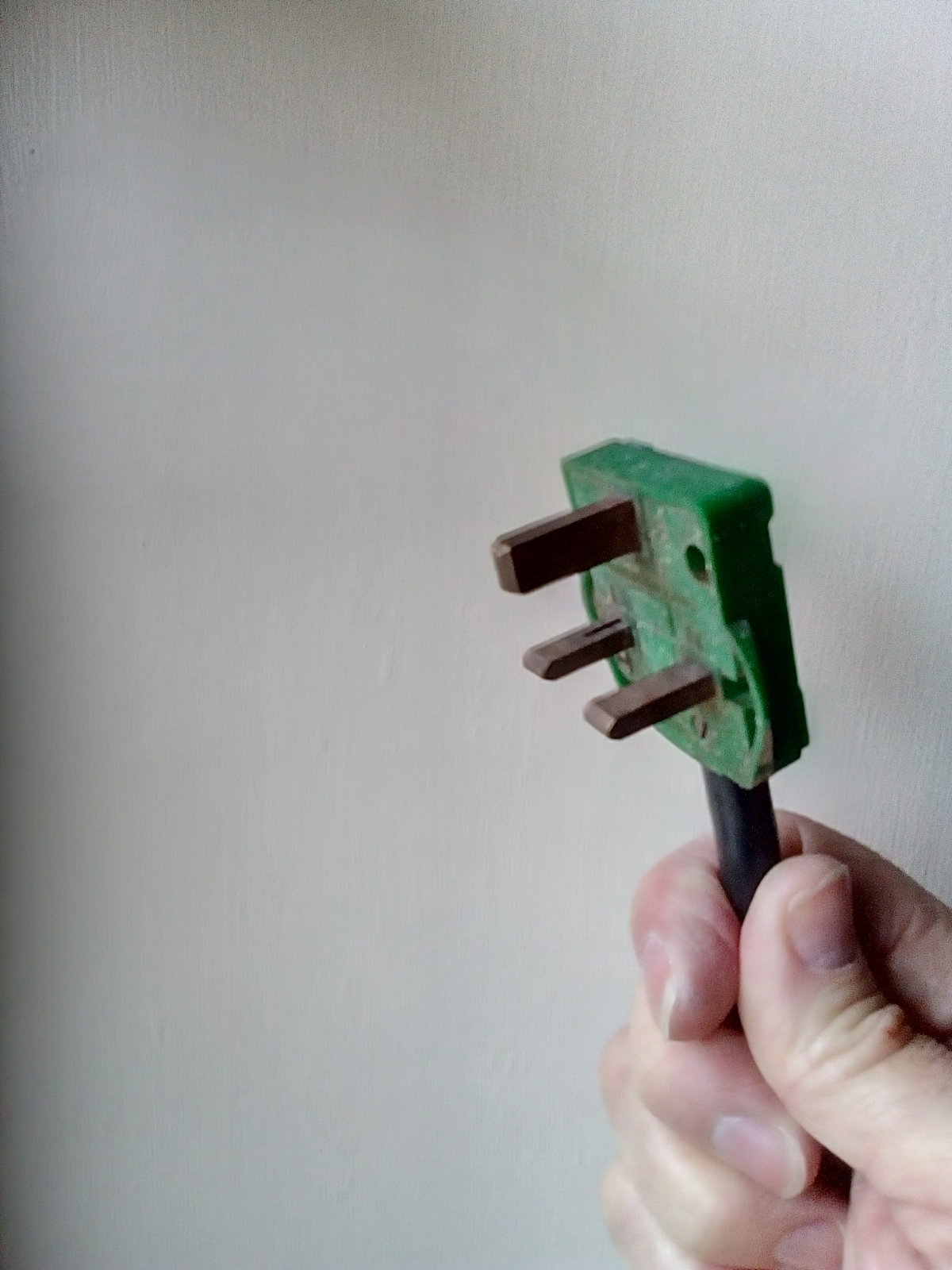

The tenant moved in last week and complained that one of the sockets is faulty. I checked it yesterday and gave it a clean bill of health.
Called back today as the rcd operated when they used Henry but the socket a few feet away was OK (a 15A radial, labelled lounge heater, on the non rcd half of the board as opposed to the ring). I checked both sockets dead and alive.
Then tried Henry with no problem.
"It tripped when my husband Hoovered the car"

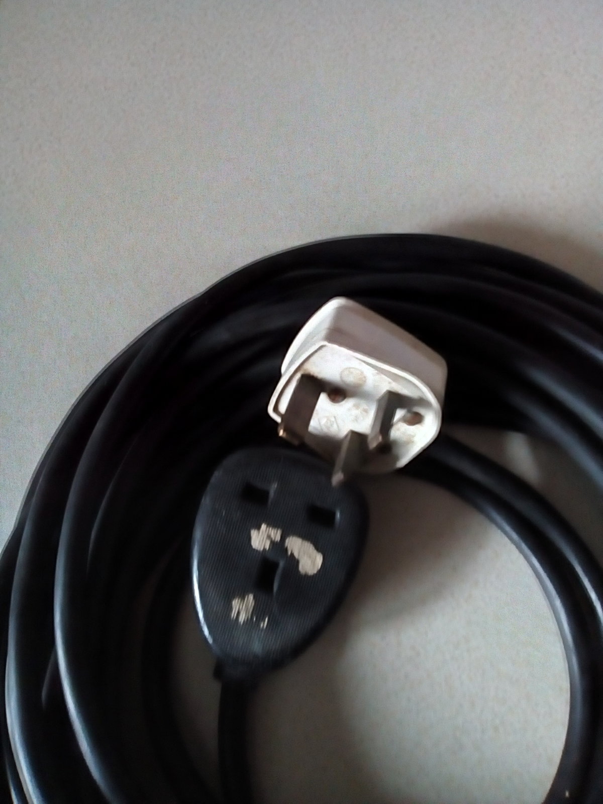

I asked for the extension lead to check
"Oh there's nothing wrong with that, we've had it for years.":

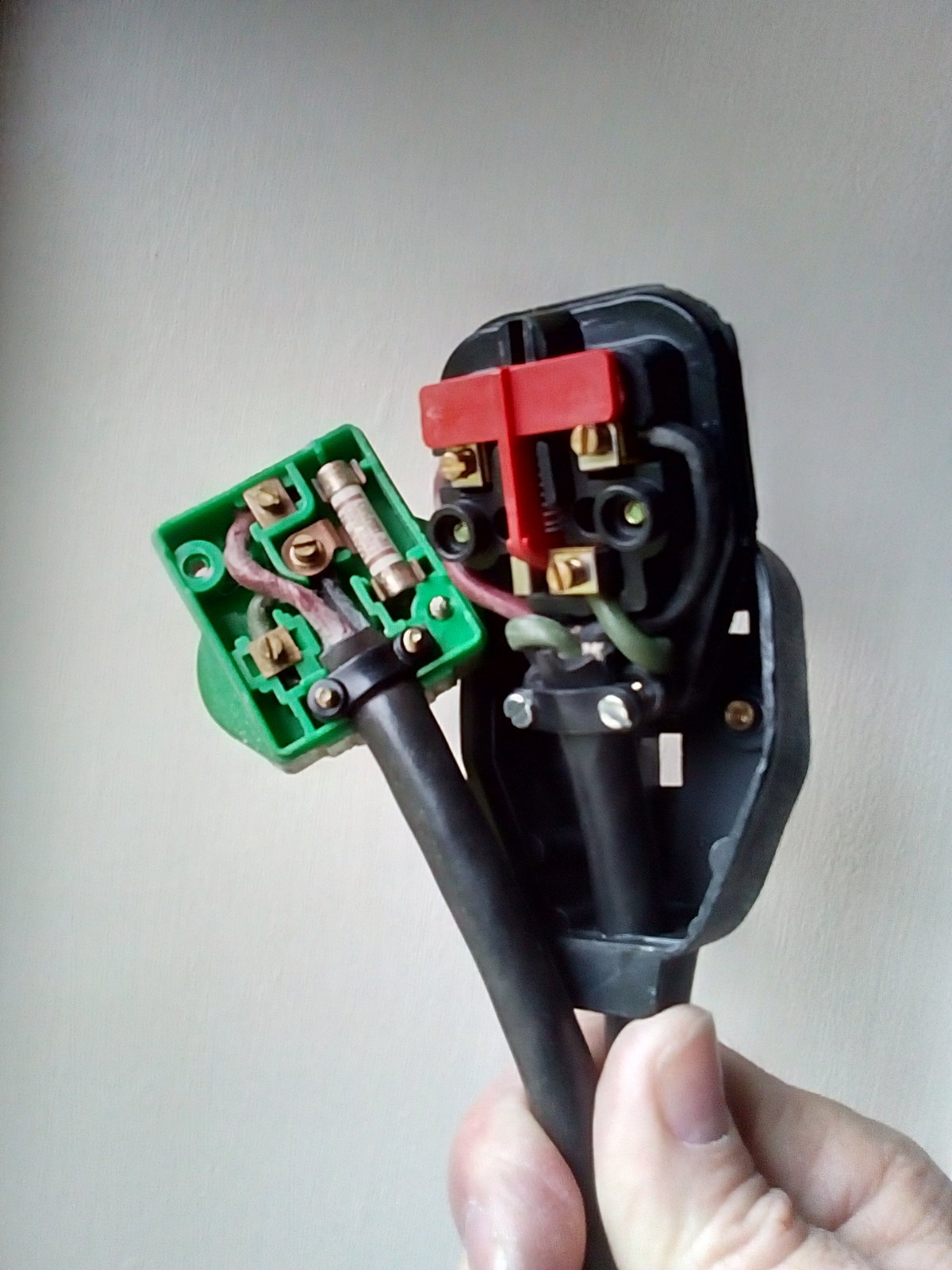

What doesn't show in the pics is the rubber sheath is well and truly perished and the insulation is as soft as the proverbial brown stuff.
And there is another, much shorter lead there too:
Nice, so it doesn't matter which wire goes where, as long as you connect all three! Russian roulette... Only a one in three chance of making the exposed metalwork live.:eek:
And with a TT supply a chance you'll get to de-ice a small patch of ground near your house.
Blimey! Bring out the wire cutters!
I replaced the white plug and tested.
I wanted to remove the thick cable, which is about 2.5mm² and maybe 50m long but the customer wouldn't let me, so I removed the green plug and affixed a failed sticker to the cable.
Hopefully she understands my concerns about the well rotted cable which has to be over 40 years old and can convey that to her husband... Hopefully.

The customer didn't understand the problem in the slightest as the cable had always worked but she did take similar pictures to mine plus similar of the other lead (harmonised colours) as a comparison for her husband.
Fortunately she did understand the size of her little boys fingers and the insulated pins.
I just wish there was some way of knowing what the final outcome is but I'll lay odds on a new plug being fitted by the time he wants to hoover his car again.
