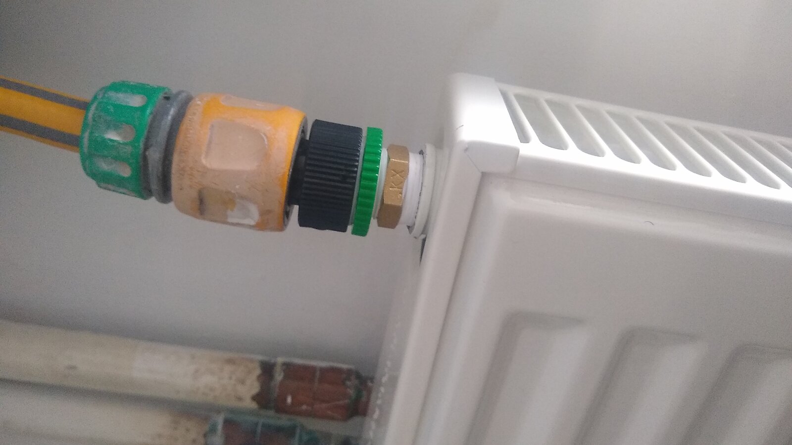

You should be using the air bleed valve on the top of the radiator ,not the drain cock on the pipe when doing the test yesterday and today !!
I am using the air bleed valve (pic attached)

When i had the hose attached like the pic. I only opened up the trv.
When I did this, hot water came out of the hose. Whilst this was happening, i was simultaneously topping up the boiler
I never opened up the lockshield end
After waiting about 5-10mins, i shut off the trv amd stopped the boiler from filling up.
I then replaced the hose with the radiator air vent (with the bleed hole)
Then fired up the heat and opened the trv. I got nothing
I then opened up the lockshield and still nothing
You need to get your plumber back .
It's likely not plumbed in correctly. It's possible that the pump may not be functioning and the upstairs rads heat only by gravity circulation ,but I suspect the plumbing.
