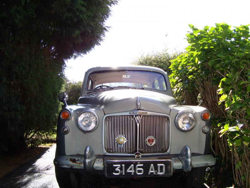

P.P.S. This is a PROPER Rover, awaiting time and TLC from me.

Ive had enough of cars with elaborate crap all over them ...i don't want any more of it ... BTW nice P4 ...Think my next car will be a restored morris miner traveller
