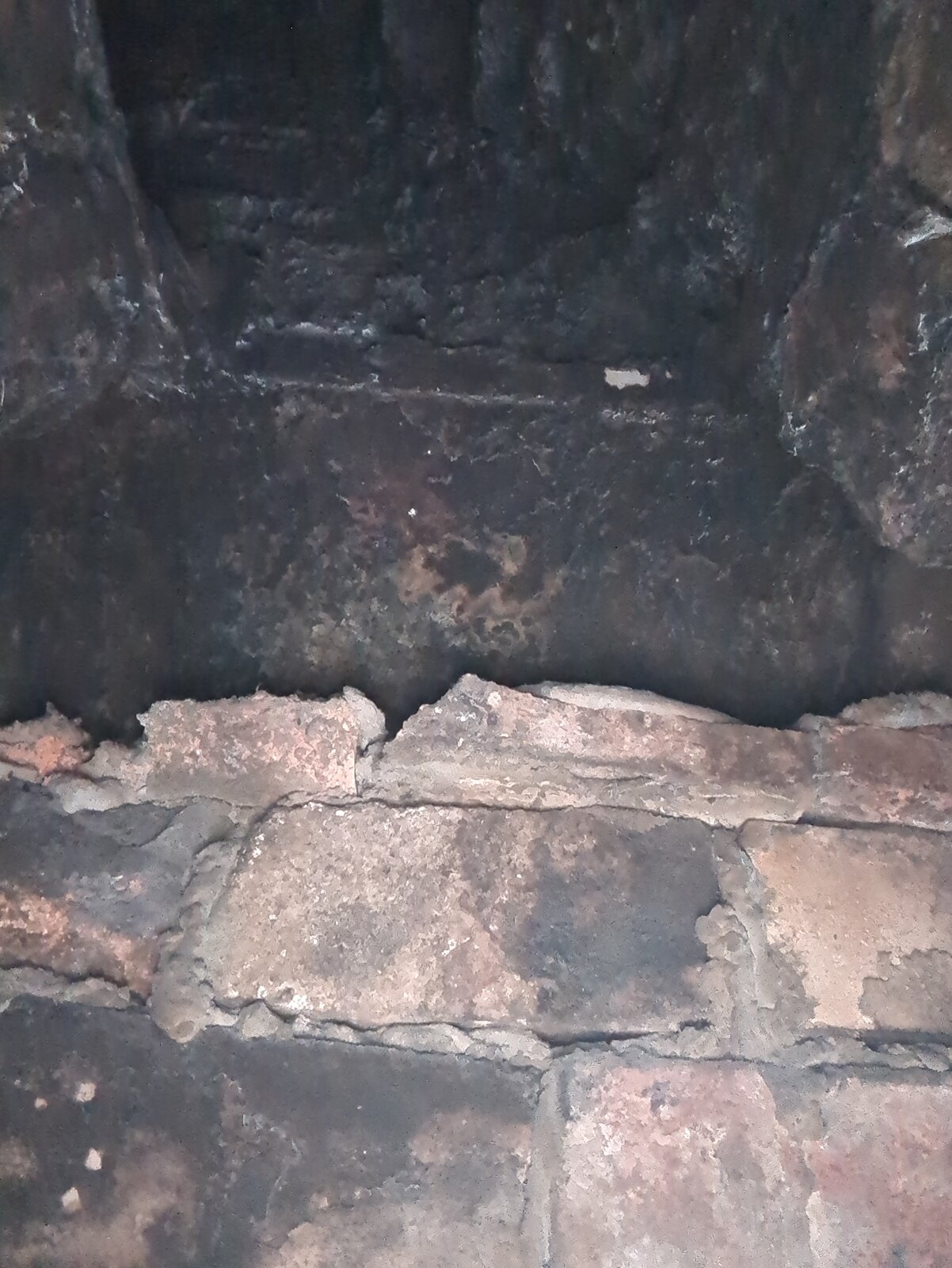

I have taken some of the plaster off I think the concrete above is the outside of the throat, it slopes backwards inside. Could I cut off the bottom of this and insert a lintel or could this be a lintel sitting underneath the throat
This is from the inside the bottom of it is not as deep as the bricks below would I need a lintel below this or move the steel lintel up

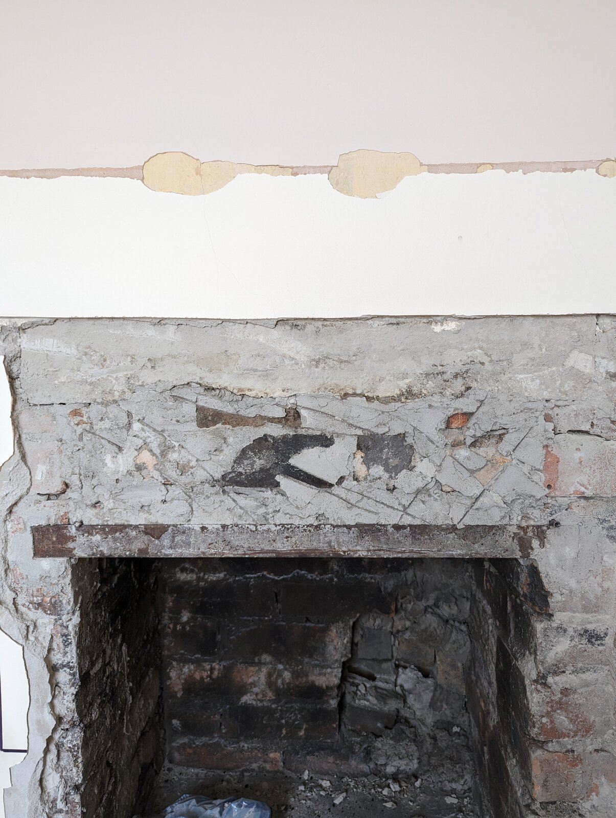

Have you picked a new fire and got the dimensions? You can move the steel up if you need to.

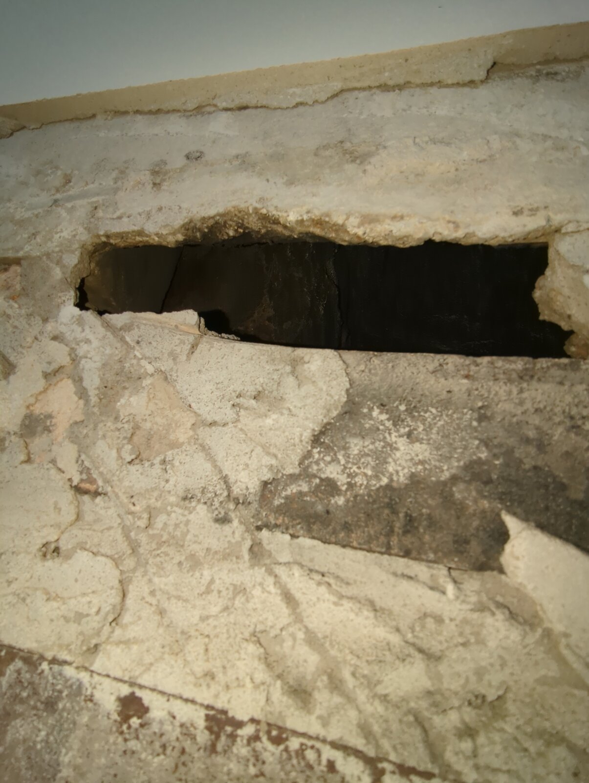

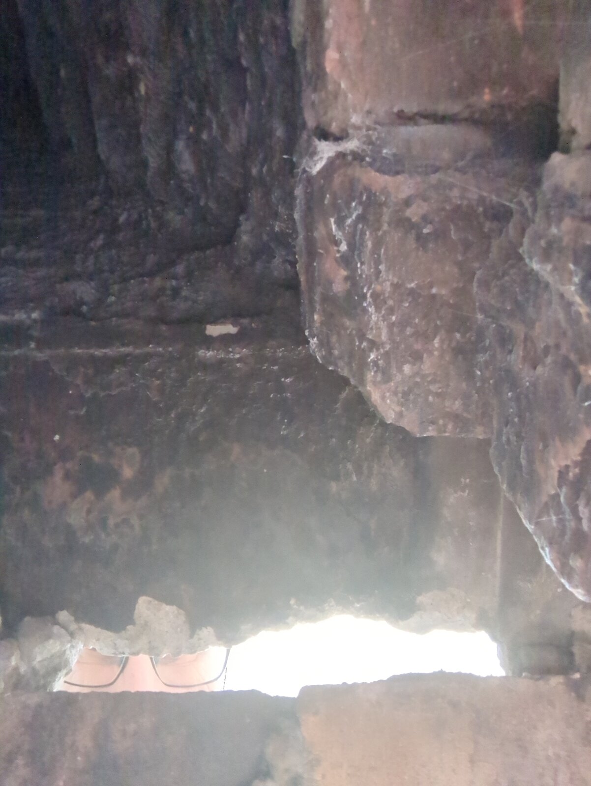

With brick removed

Not decided on fire but we are staying within the 600 mm opening she has a shortlist all of which fit in the 600 mm ideally i just open up to bottom of the throat lintel it full thickness at the sides and extends a good bit up
You don't normally have any brickwork under the throat lintel. The idea is that it guides any smoke up the flue. Bricks tend to let some escape. You don't need the brickwork below the lintel.
