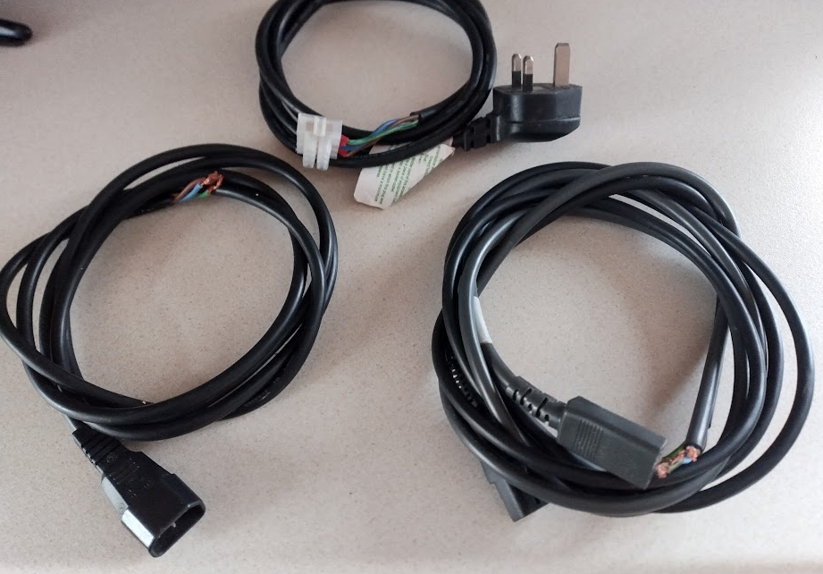

Widow maker
Poor excuse though, you could re-do it safely (if untidily) using random stuff found round your typical office (1 4-way and 4 PC leads)
Quickie alternative items I used; 13A to C14, 2 way male to female splitter and 1 way male to female.
After taking the pics I adapted it and now looks like this:
Since then I've added choc bloc to the male lead too.
