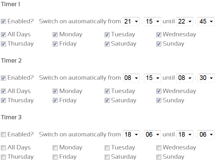

That is my light switch set to wake me up in the morning. You only have three timers using the hub however it also works with IFTTT which will allow all sorts to be done.

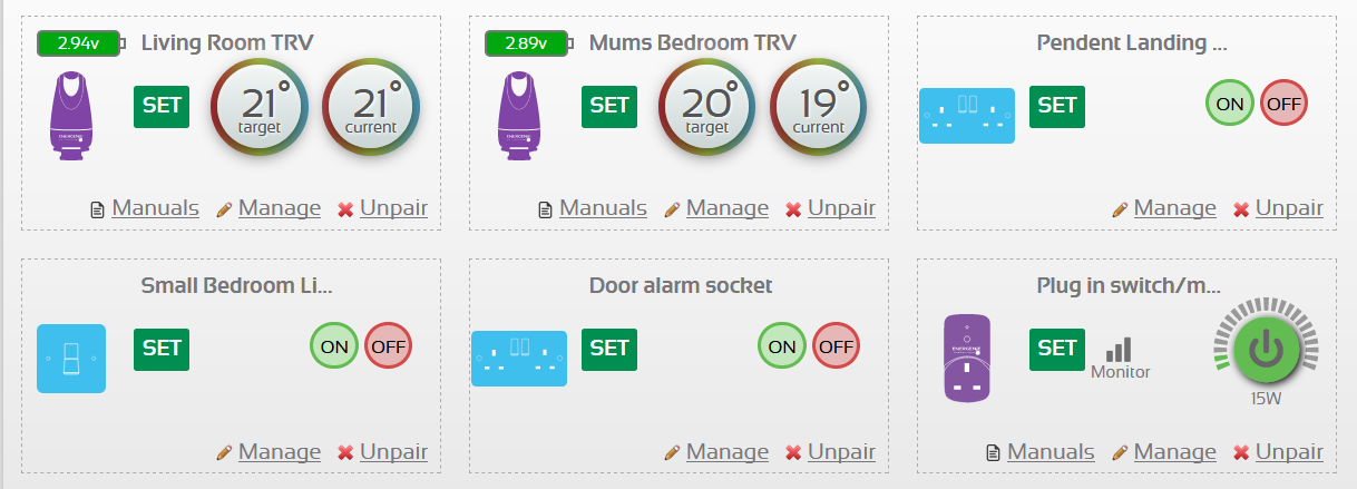

The main page will look like this.
I have two radiator valves two sockets one light switch and an energy monitor which can also be switched on/off with the PC or Smart phone, the sockets will also work with up to three remote controls, and we use them to control extruder alarms so we know if mother has gone wheel about, I would not think it would be worth using the system for one device, however for me it really works well, we tried using cheap plug in timers and remote sockets, but found either we would forget to switch back on or the carers times would change or even some one at front door which resulted in us having to run upstairs etc. Having a timer and remote in the same device was what we needed and this does that, so 8 am the alarm auto turns off for carers and back on at 9:30 am we also had problem with sun in bay windows heating the room to silly heat before central heating switched off, again it cured the problem. And the energy monitor is a toy really, at the moment showing charge rate of battery charger in garage.

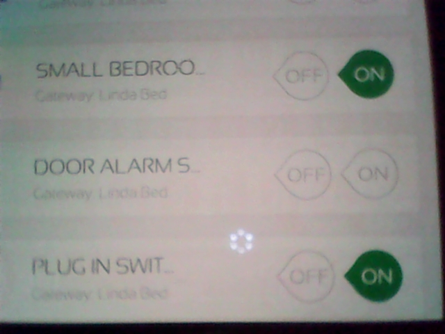

I noted today although the sockets don't report on or off, the light switch does, but only with the phone not with the PC.
Sorry not a good picture of the phone but you can see it actually shows my bedroom light is on, and the energy monitor is on, but where it says doors alarms that is one of the double socket supplies it does not say if on or off.
