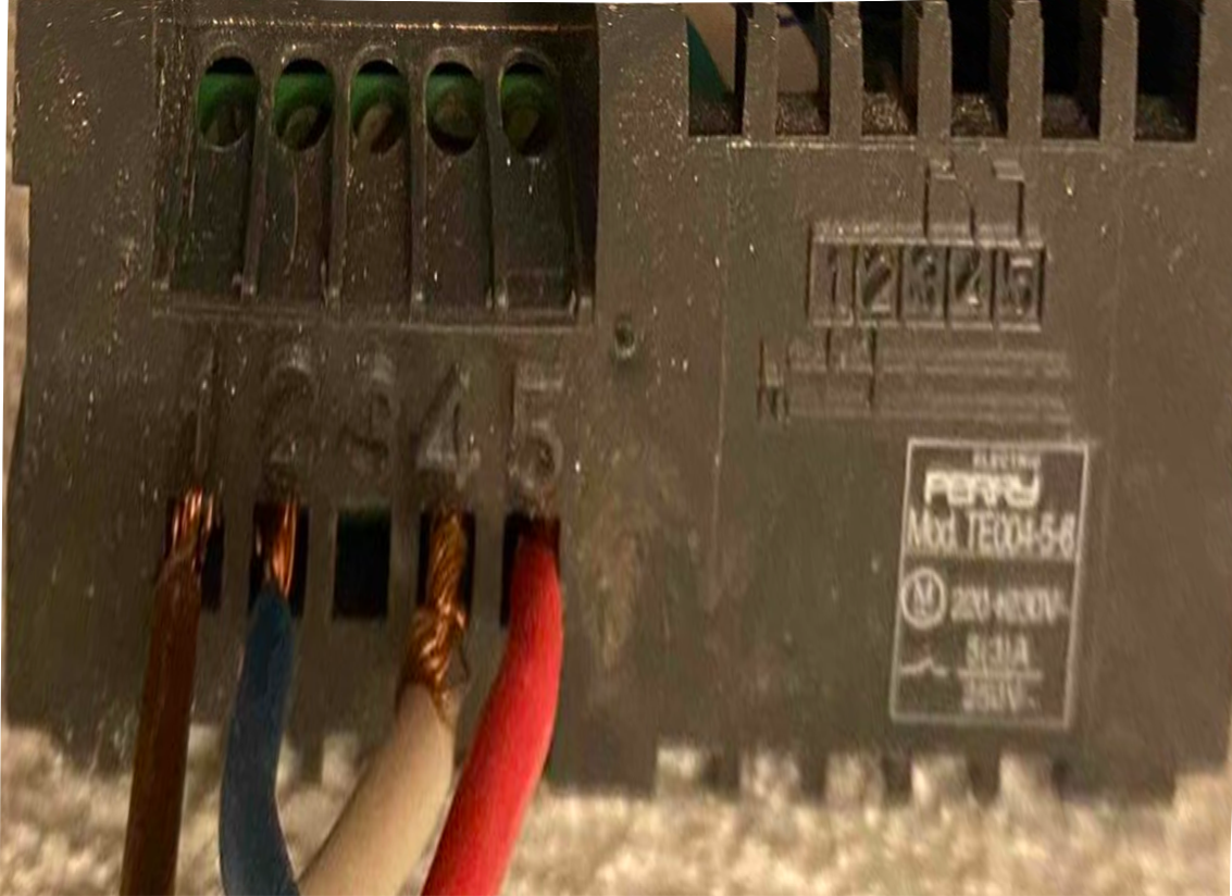

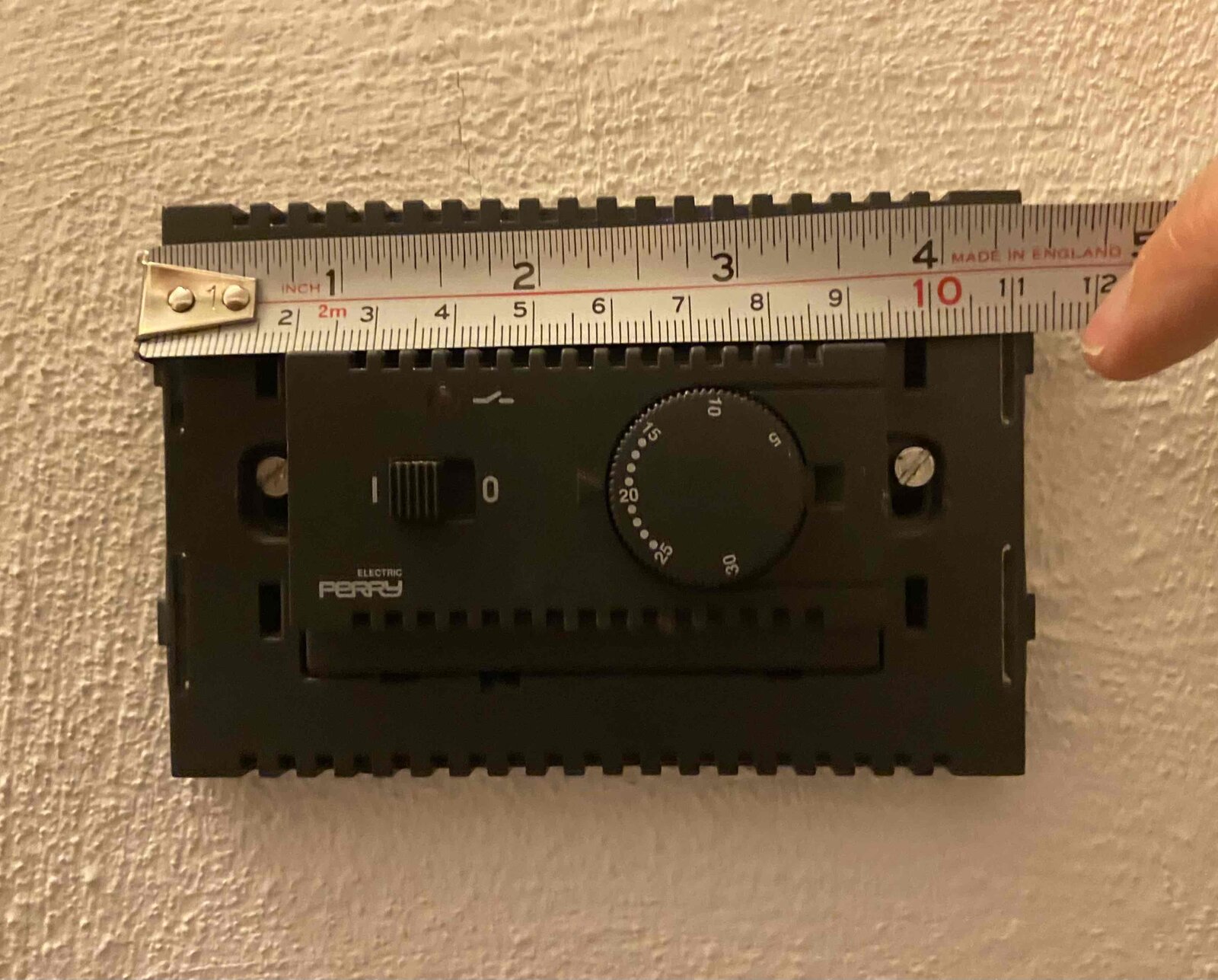

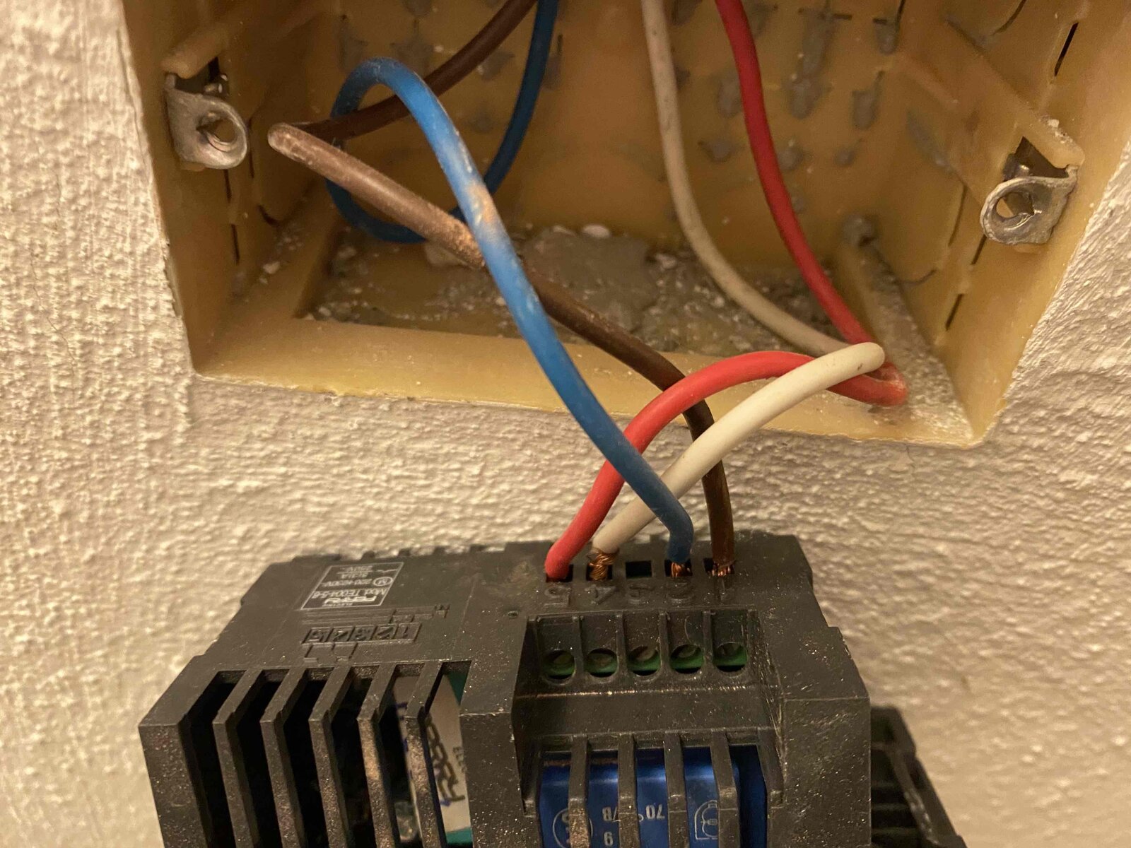

I’m looking to install a basic WiFi thermostat into a holiday home.
The existing thermostat has 4 wires into connectors labelled 1 to 5.
I have a attached photo.
The manufacturer has provided a wiring diagram for the WiFi stat but I’m unsure which colour wire should go into which terminal. Please see attached diagram.
I would be extremely grateful if someone could advise which coloured wire should be placed in which terminal on the new stat.

Hi,
Your old 'stat has the wiring layout marked on it (left hand side of image).
On the new thermostat, you could try:
Brown wire (Live) to connector (4)
Blue wire (Neutral) to (3)
White and red to (1) and (2),
(Making sure the power to the 'stat is isolated first!)
...and see what happens. :)
Looking at your photo
1 = Line = 4 on new thermostat (brown)
2 = Neutral = 3 on new thermostat (blue)
3 = Normal closed not used and not available on new thermostat
4 = Common = 1 on new thermostat (white)
5 = Normal open = 2 on new thermostat (orange)
5 and 6 are only used with the underfloor heating version.
Not seen Modbus used in domestic in UK, there may be a conversion module to make it OpenTherm but I would just ignore it.

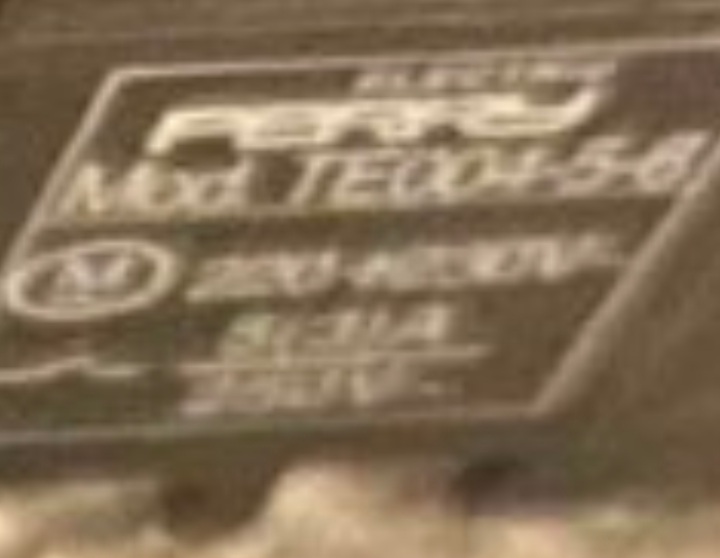

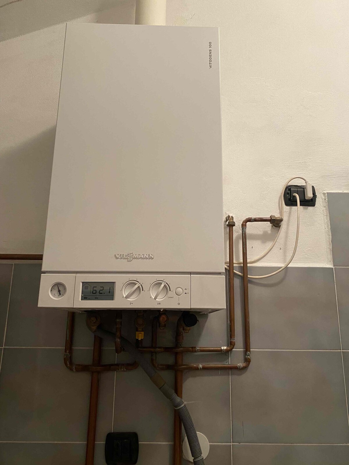

Ok so now I’m a little concerned/ confused as to whether I should get the ‘stat I’m looking at.

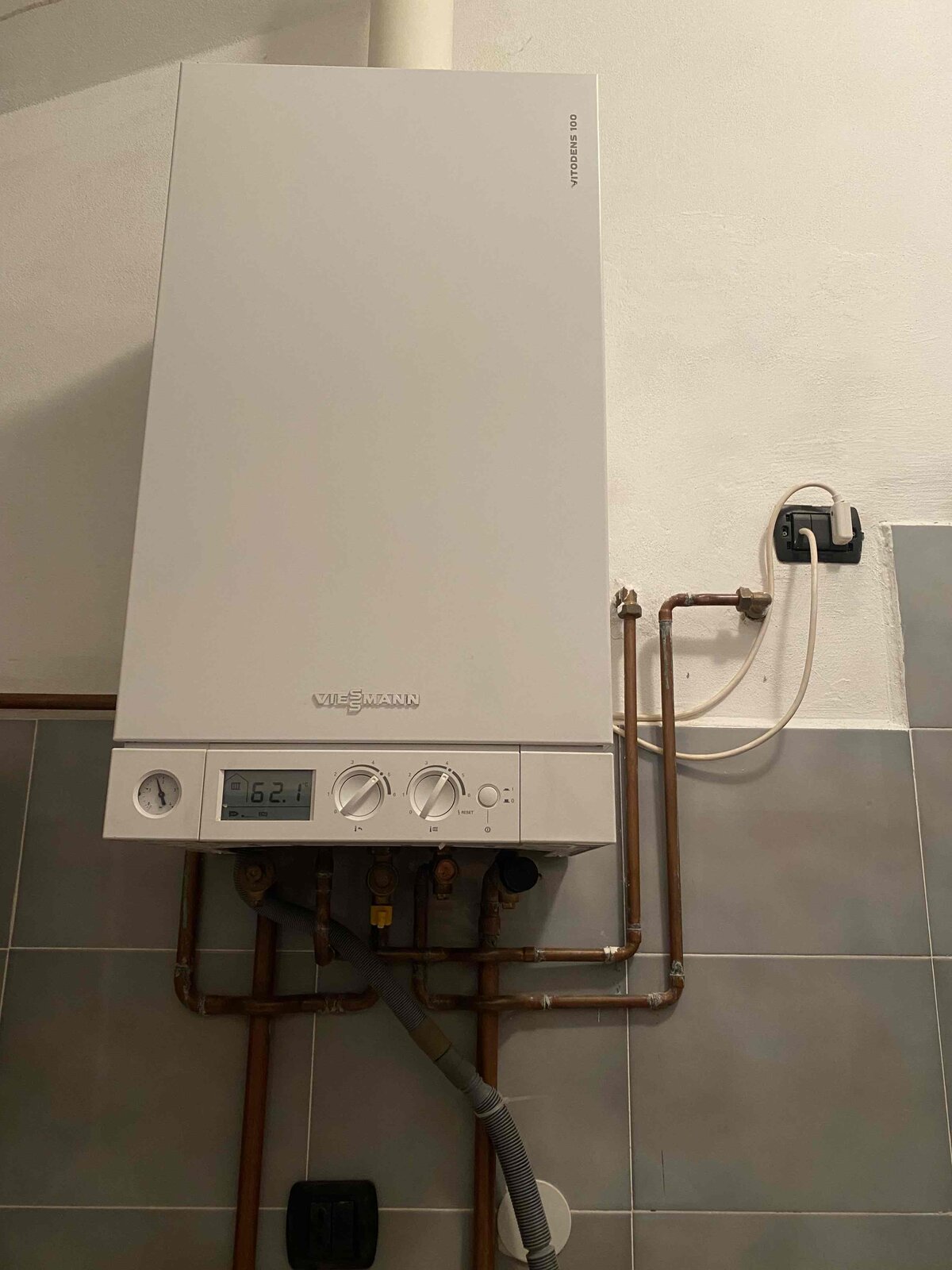

This is the boiler it will control.
From memory it’s plugged into a 16a socket. Like many houses in Italy it has both 13a and 16a wiring with certain appliances only capable of running from select plugs.
Is there a suitable wifi ‘stat that will work on either the 5a or 16a ? I’d chosen a cheap ‘stat because it’ll rarely get used (just when visiting in winter etc) but if I have to spend more to guarantee compatibility then I’ll do so.
Or am I barking up the wrong tree having misunderstood your previous post?

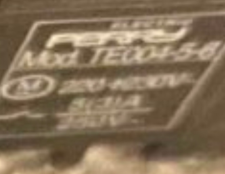

I believe your current thermostat is rated at switching 5/3A (one will be a rating for DC switching) from a very zoomed in view!
So no need to worry! ;)
It will work, most thermostats work, as to if it will work efficiently don't know, but for holiday home does it really matter?
