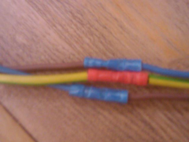

Equally simple is that 526.3 does not exempt "maintenance free" junction boxes.
Indeed. However, the one thing that the Ashley FAQ brought to my attention (which I'd never noticed before) is that Appendix 15 contains these little boxes which do seem to be 'allowing' "maintenance-free terminals" (without any definition thereof) in inaccessible locations, even though that is not mentioned in the body of BS7671. However, Appendix 15 is only 'informative' and, even if it were taken to be permitting such terminals, only applies to ring and radial final circuits - hence would not apply to lighting or other circuits.
IMO they do not comply, and were I ever to do a PIR and find them I'd code it accordingly.
Although my opinion doesn't really count for much in this field, it is exactly the same as yours.

I think if you are looking for a definitive standard you will be disapointed. However the regs do allow for new inventions; see 120.3 and 120.4. Hager have made what in my opinon is a good JB and issued a statement that satisfies me with regards to 526.3.
As I said, I am quite open to the possibility that it's an excellent product, and quite possibly so much better than screwed terminals that it is reasonable for it to be used in an inaccessible location. However, I still think that it's stretching things to argue that it is compliant with BS7671 as written. However, that is merely the opinion of someone whose opinion in this field doesn't count for much.

Yes, usually true - although it's not impossible that a PIR might be undertaken at a time when usually inaccessible JBs were actually accessible. Furthermore, one might 'become aware of' the existance, or probably existance, of inaccessible JBs (e.g. 'by enquiry' or if the arrangement of wiring indicated that there were inevitable inaccessible joints somewhere - e.g. if a spur appears 'from nowhere' in terms of inspectable accessories). Don't forget that if one believes that no JBs are allowed to be inaccessible, then all one needs to establish is that there are inaccessible JBs present, even if one hasn't seen them - the nature of them is irrelevant - although I admit that there is always the possibility that they have been soldered/brazed/welded.

Or crimped.
I deliberately didn't include that, because the only types of joint that one could (usually**) become aware of by detective work without seeing it would be a 3-way (or more-way) joint - and if that were crimped, it's surely a red mark for the PIR again?
** just in case there are some nit-pickers around - if a cable disappeared somewhere and then re-appeared with different insulation and/or sheath colours (or different CSA), there would have to be a joint (perhaps with a compliant crimp) somewhere.
