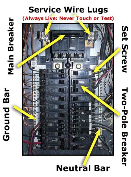

As a matter of interest, in the USA one commonly finds 200A supplies and boxes with up to 30 circuits. Surely, we are heading that way with domestic CU's having min. of say 20 circuits or 30 ways!
Don't forget that they need twice as much current as us for the same load, so 200A there is no more capacity than 100A here. Also, a combination of radial circuits and a need to keep cable sizes manageable results in more circuits.
Any comments?
Just so long as our CUs don't end up looking like theirs:
