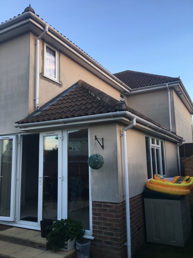

I am looking to build up over our living room to extend an upstairs bedroom. We plan NOT to go all the way over to neighbours wall as that would cover our bathroom window so there would be an alcove.

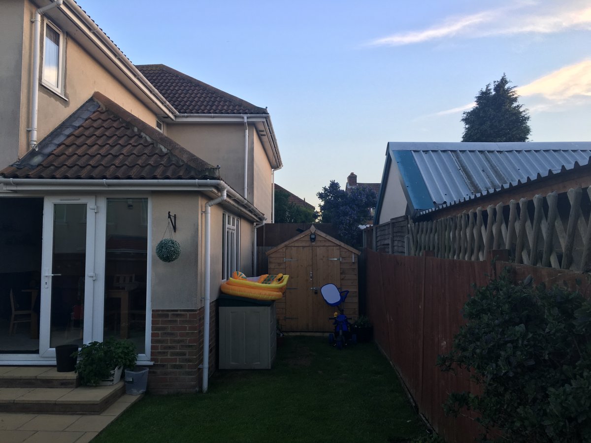

We shouldn't have a problem apart from our rear boundary is within 7 meters... Our neighbours however have stuck 2 huge mansheds within inches of the boundarys, I don't mind as I actually like them but will planning say our new part wil be too close?

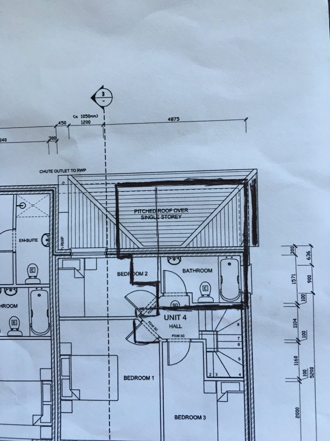

The marker on the drawing shows the proposed idea.
What restrictions / conditions do you think may be put in place. I.e can we have a flat roof, would we have to have sky lights rather than Windows so not to overlook?
What advise can you give?

You should be OK with an extension there. Councils tend not to allow flat roofs at first floor level. Windows facing over neighbour's property tend to need to be obscure glass or just be top opening, but it depends what they may be looking out over.
You will probably just need to tweak the design to meet the council's local policy, but in principle there should be no issues with a normal extension there

No, the plans are slightly different. The bathroom is actually bed 2 and the bathroom is a small box room (just big enough for a cot and small cupboard) the boxing shown on the drawing is built in cupboard
