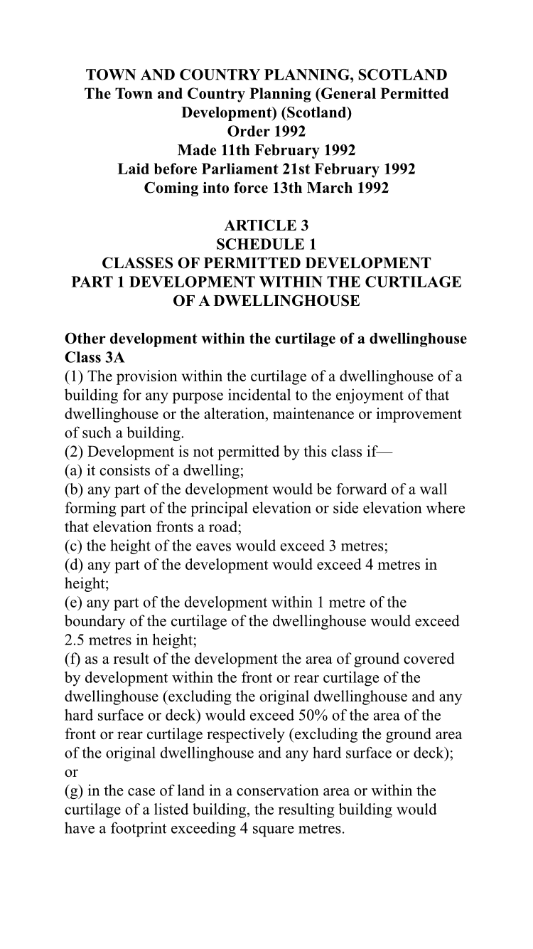

This same neighbour chatted away to us whilst being built & we explained we couldn’t buy a kit. This same neighbour said access his garden any time to paint when completed. Victor Meldrew just hates us!
Scotland 1m
Yes - my quote earlier was wrong! Peak of roof approx 59cm above the 2.5m. Hoping maybe a compromise on roof structure can be made. Not possible to have within 2.5 for the metre but can be altered / lowered - but casts no shadow and blocks no view (view is of other neighbour’s gable end of garage) so not sure how this changes anything - but would carry it out. Waiting for planning to call.
(son needs 215cm clear to walk and decking 17cm - leaves 18cm)
It doesn’t look to me like it affects the neighbours garden at all.
Doesn’t really. I’m really hoping Council thinks so too. If anything to let me stop thinking about it every waking hour lol.
Not as much, and will do if it’s a requirement but we can’t get it under the 2.5m for the full 1m as I think our inside ceiling (from ground with decking) probably hits the 2.5m. Would be potential compromise.
