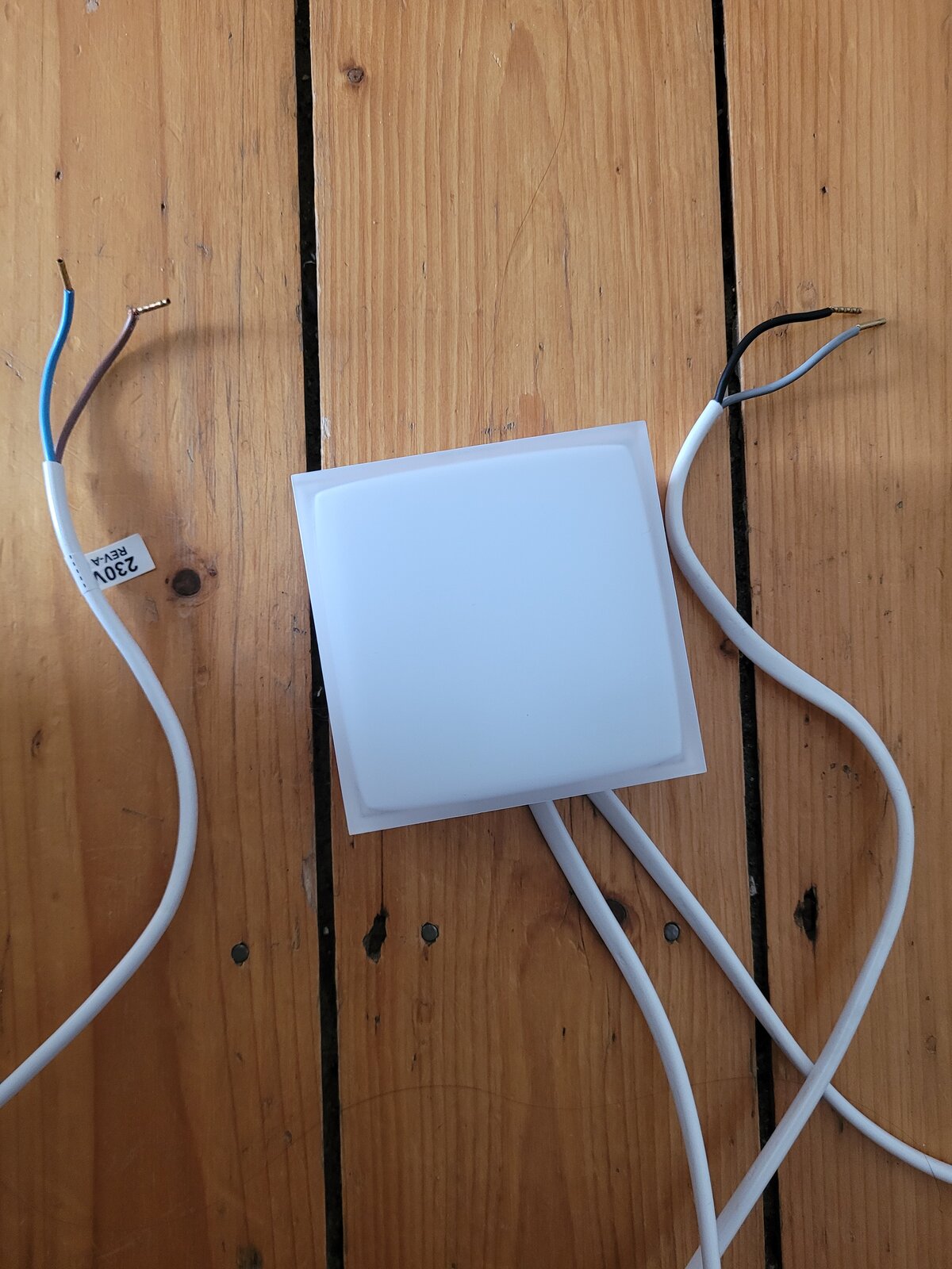

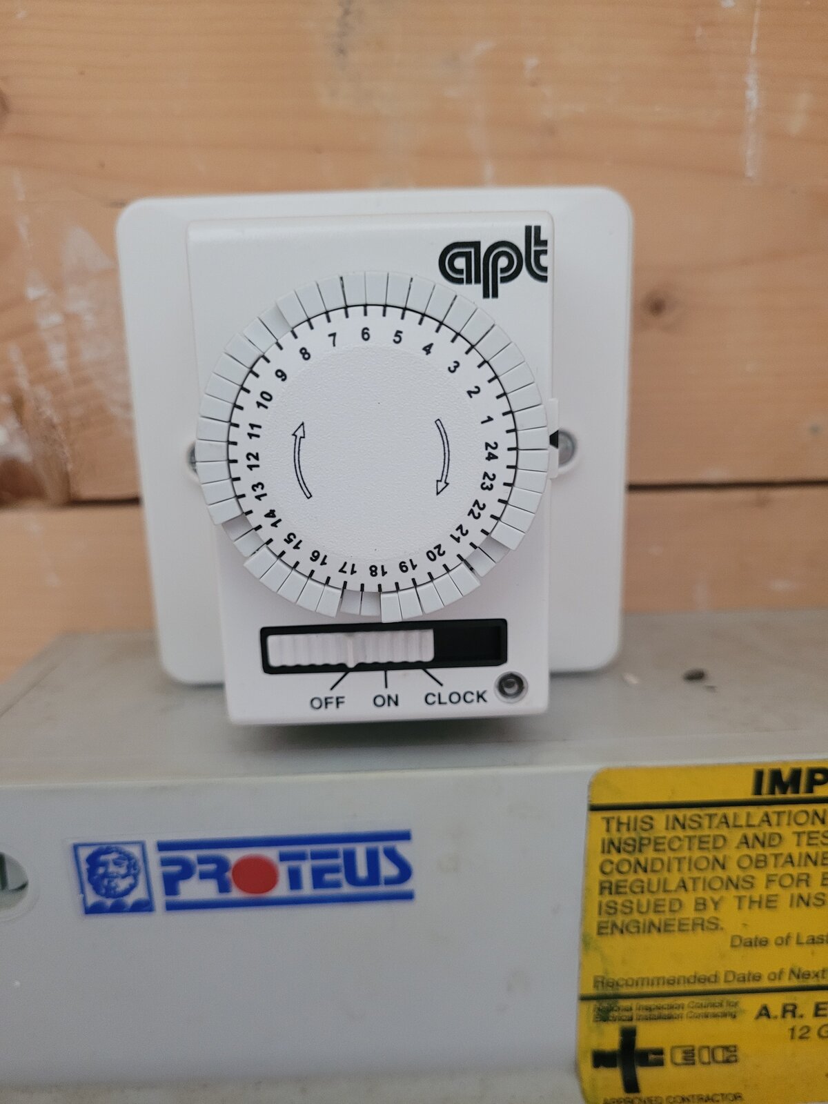

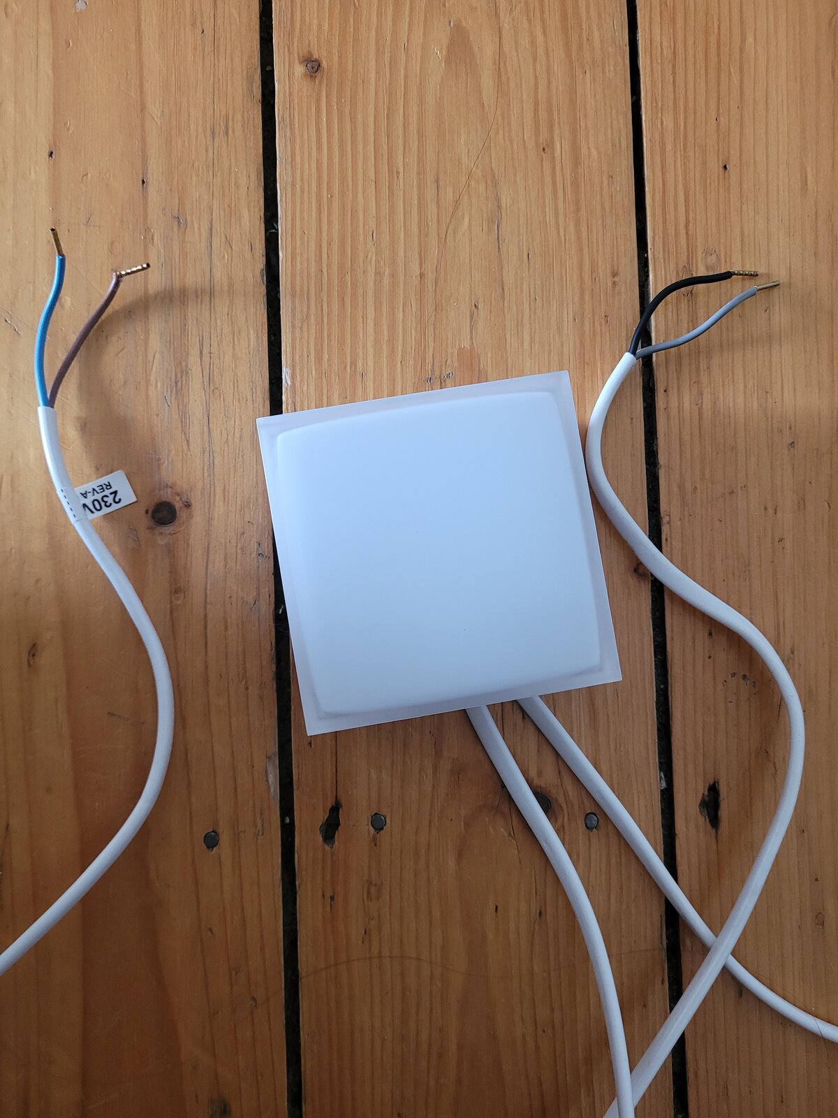

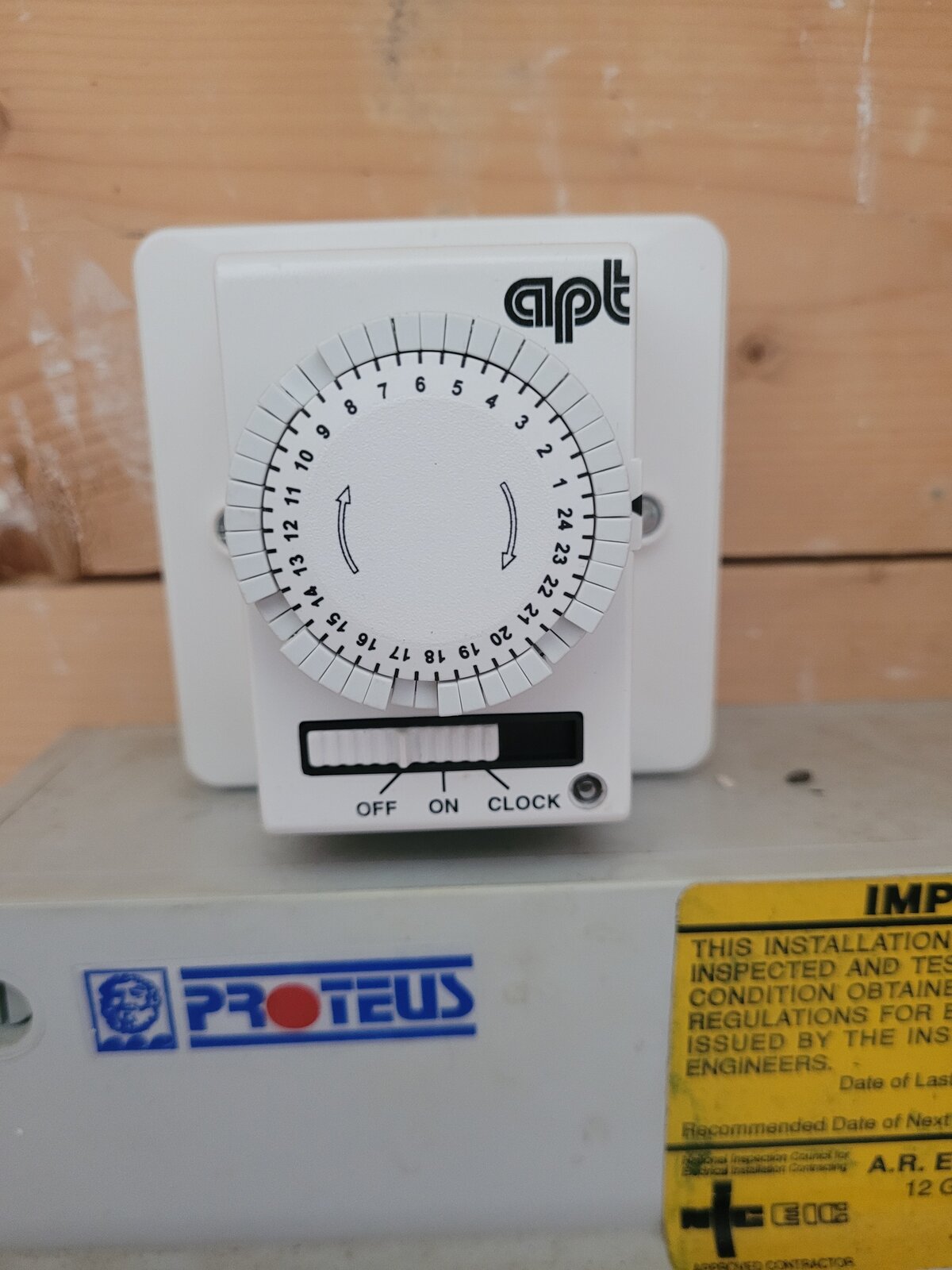

Hi I have asked this in plumbers section but not had much feedback. Will my thermostat relay wire into an APT timer switch?
Pretty much anything can be wired together, what are you trying to do and what is the themostat?
It is a netatmo brand relay for a wireless netatmo thermostat. The wireless thermostat on the wall sends the signal to the relay to turn on and off when thermostat reaches temperature or drops under temperature wich im sure you already knew. If possible I want to wire the relay to the timer so the wireless thermostat and relay start to do the work. As you can see in photo its a APT brand timer

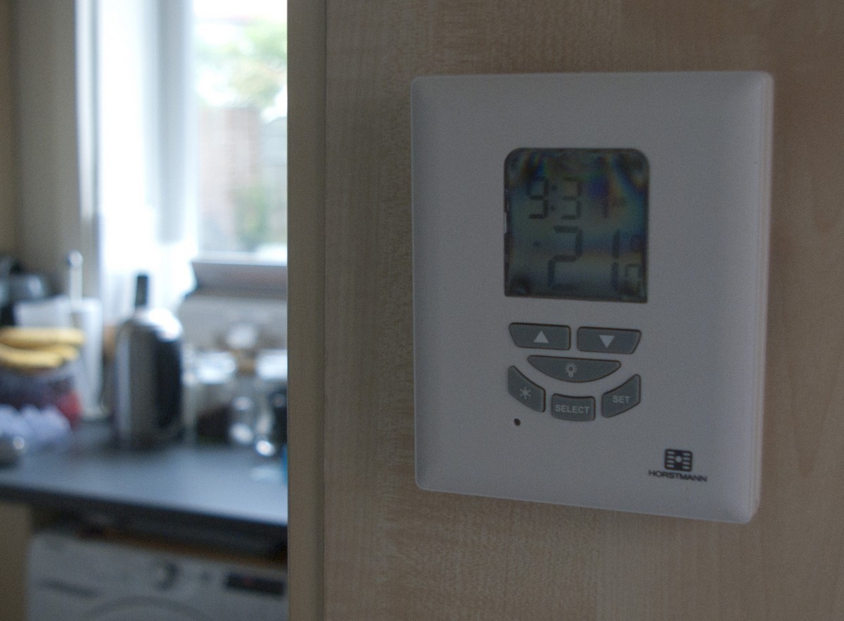

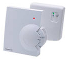

Where it all changes is when you go wireless, anything wireless need to look at what happens when the signal is lost, I used this IMGP8037.jpg thermostat in mothers house, and found room at 28ºC when it lost signal and did not turn off, however this one 84067_P.jpghad a fail safe, and no signal in ½ hour and it auto turned off. I at first could not work out why the central heating installers had used such an expensive unit, but when the other one failed I knew why.

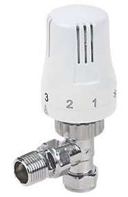

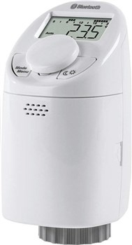

The room should have never reached 28ºC, the TRV head EQ-3 Bluetooth Smart Radiator Thermostat.jpgshould have turned off the water flow well before, but two problems, one TRV.jpgthe numbers 1 to 6 are about as much good as a chocolate fire guard, I want room at 22ºC not a clue if that is 2, 3, or 4. And next is down to speed, the electronic one auto exercises at 12 midday every Saturday, stops the pin sticking, and re-calibrates it, this takes around 3.5 minutes, this is how long it takes to fully open, fully close, and return to setting, so for the radiator not to get stinking hot while it does this, the lock shield valve is set so it takes at least 15 minutes for the radiator to heat up.

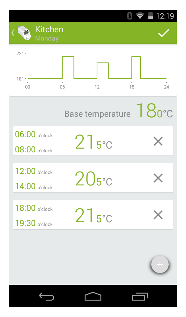

But if your setting the program on the TRV 51RAAw1+hEL.jpgthen why also does it need setting on the thermostat? This seems Nest_screen2.jpg great, but in real terms one has to ask why we even need a wall thermostat? Yes some thing to read the TRV's so when one needs the boiler to run, it does, but never really worked out why the wall thermostat is required, a hub to collect the info from the TRV's and tell the boiler what to do, but no need for it to actually measure room temperature other than a fail safe should a TRV fail in some way.

I've no experience of this product and Quite frankly I find their installation instructions are terrible. I've not yet been able to establish the true use of the 2 cables... it looks like one is simply a mains supply, presumably the cable marked '230V' in your pic with brown/blue cores.
From there I've struggled with references to 'data bus' so I'm assuming there are more than one version of this module.
Tha fact the second cable has black/grey wires makes me THINK a relay module potentially has a clean contact (That means a relay contact connected only to those 2 wires and noting else) IF that is the case it can be used in place of your existing room thermostat.
Another bit of confusion; the time switch in your pic doesn't look typical of a central heating system, more like for an immersion heater for example.
So the questions:
1. Can you confirm the time switch is definitely controlling the heating.
2. Can you open the time switch/boiler/wiring centre(if you have one) and take pictures of how things are currently wired?
Please make sure everything is powered off before removing any covers.
This is potentially not a simple job (but it might be) and at the moment I haven't been able to gauge your abilities.

I am not sure which country your in but which magazine in thr UK thst tests and rates products had it as number 1 thermostat 3 years ago. One is mains power the other is to send and recieve the messages from the thermostat. I found it first class with thr gas boiler. On it it wired into the power of the boiler and then thr black and grey wired into the command part of thr boiler

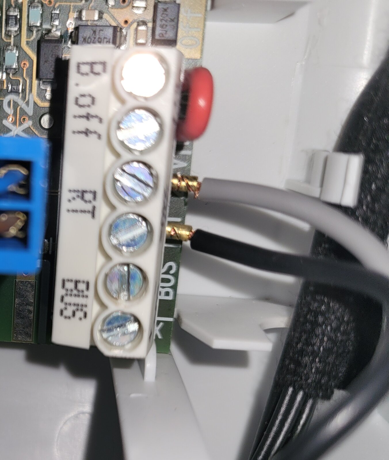

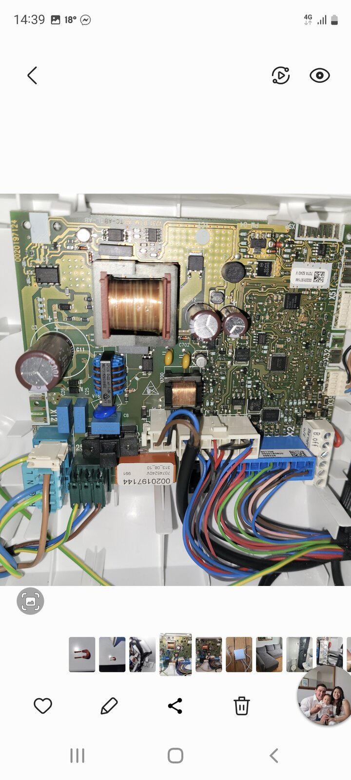

OK that helps; What gas boiler (Model)?
How was it wired into the gas boiler; as an enable (maybe marked as 'Rooom Stat' or something similar) or as 'Bus' (assuming it's a fairly recent boiler)?

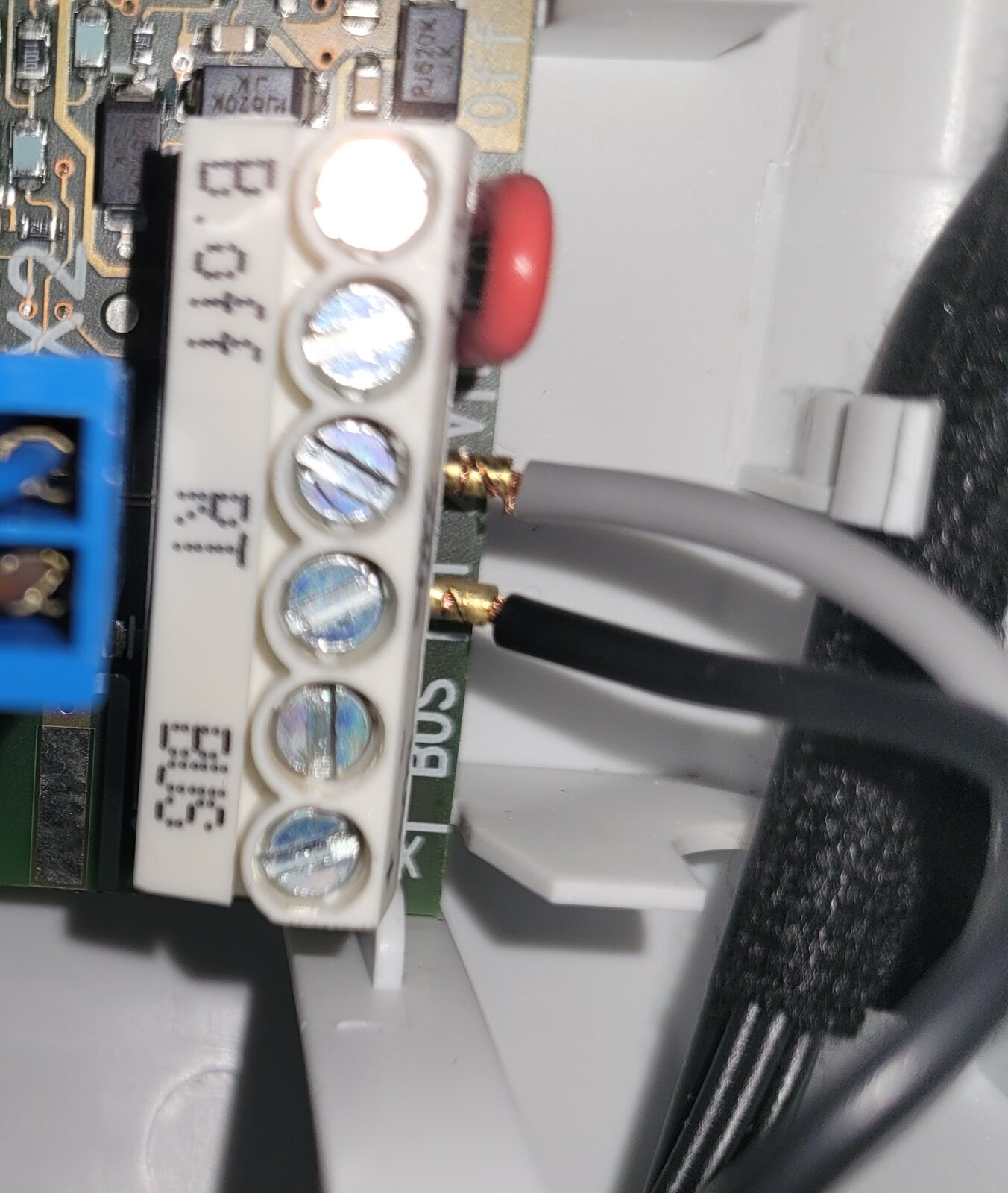

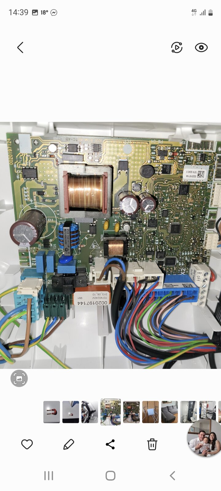

Glow worm easicom 28c. Live and neutral wired In on the left and on the right and in main second picture I think I had it in RT. worked a dream.
Sorry, I tried to add a quote, but my phone was playing up - hopefully some of these posts may answer your questions @SUNRAY :)
