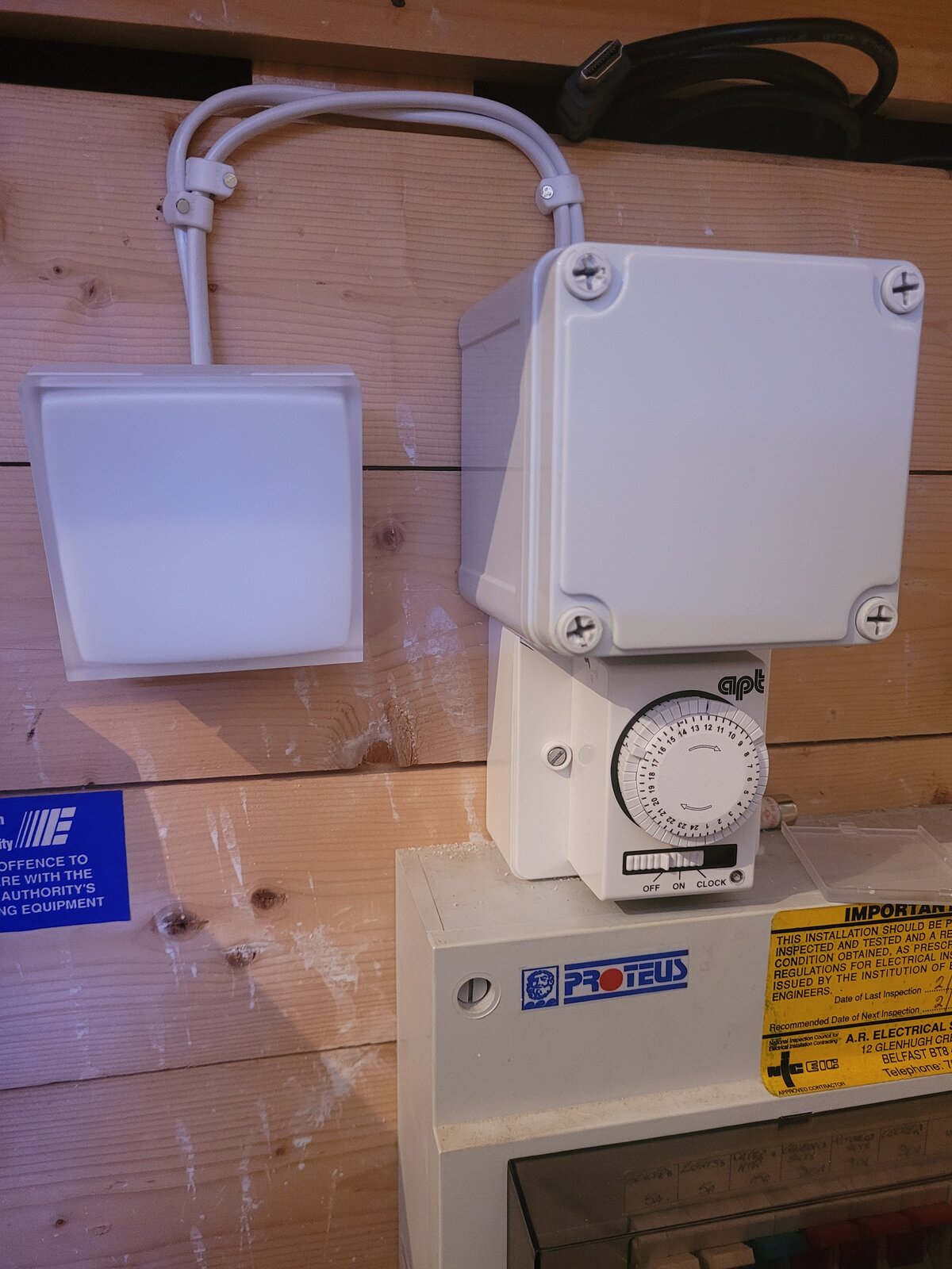

Will thermostat relay wire into a APT timer?

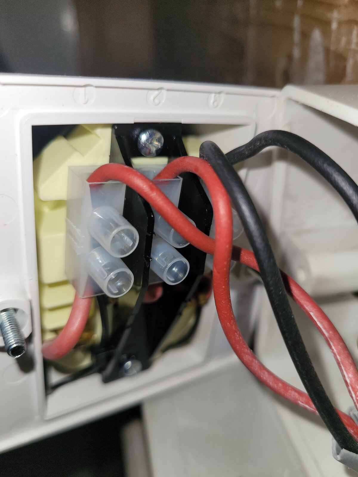

Yes flameport I know that. I managed to get Into the house and open the timer switch. It was tight tho so could not get the best of photos

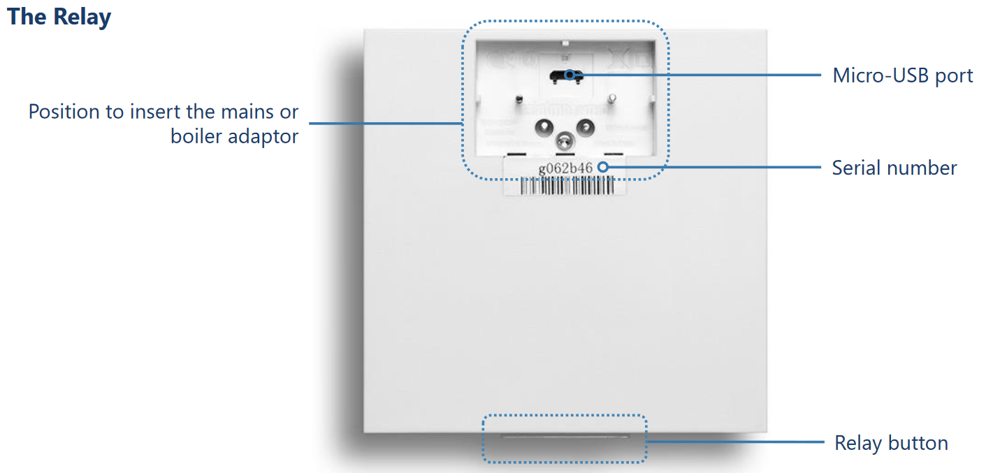

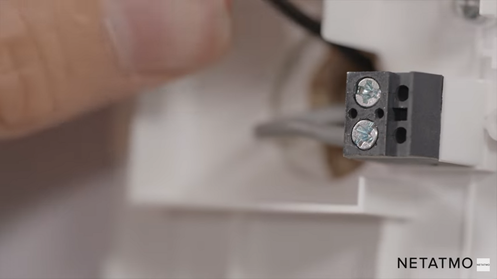

was the only instructions I could find as to how it connects to boiler. There was a
youtube video. And it showed a connection lead which plugs into the relay box, however another video shows a two wire connection 1690788502741.png it seems powered from batteries. It does seem there is also a modulating version, as well, but all I can find seems to show it controls heating only, nothing for the domestic hot water (DHW) and with an oil boiler it seems likely the thermostat needs to control a motorised valve then the valve controls the boiler.

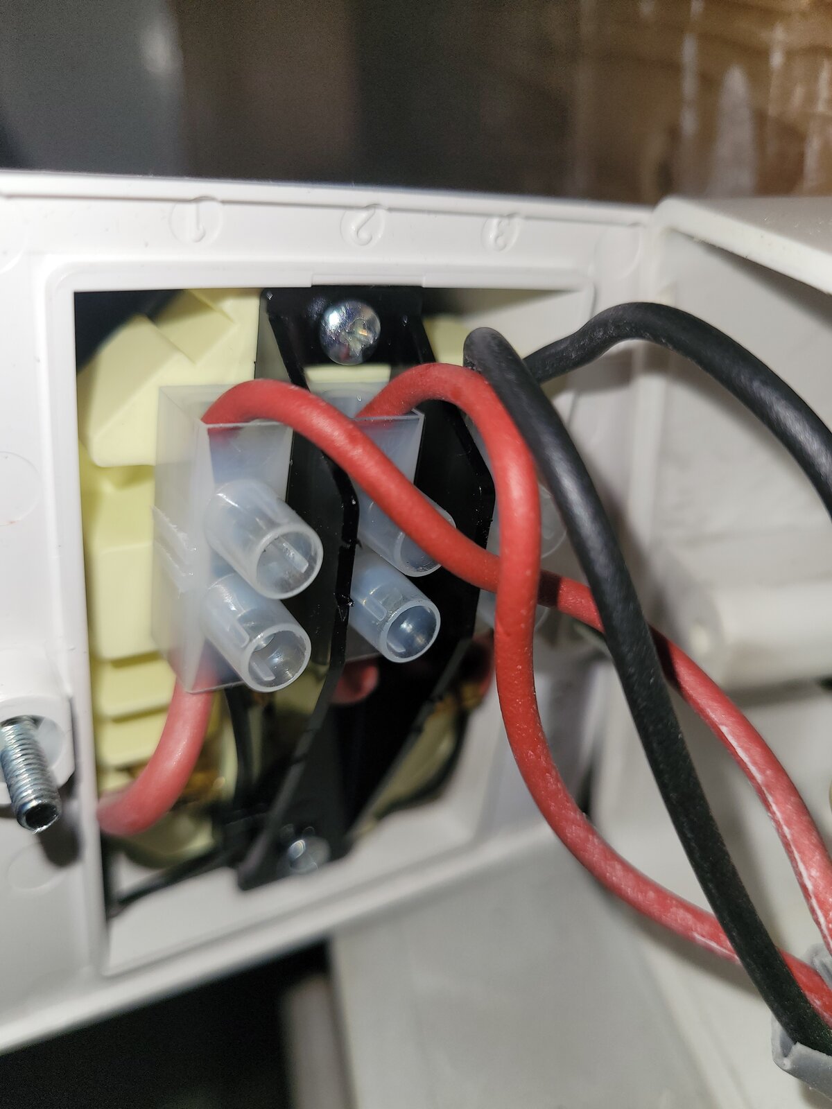

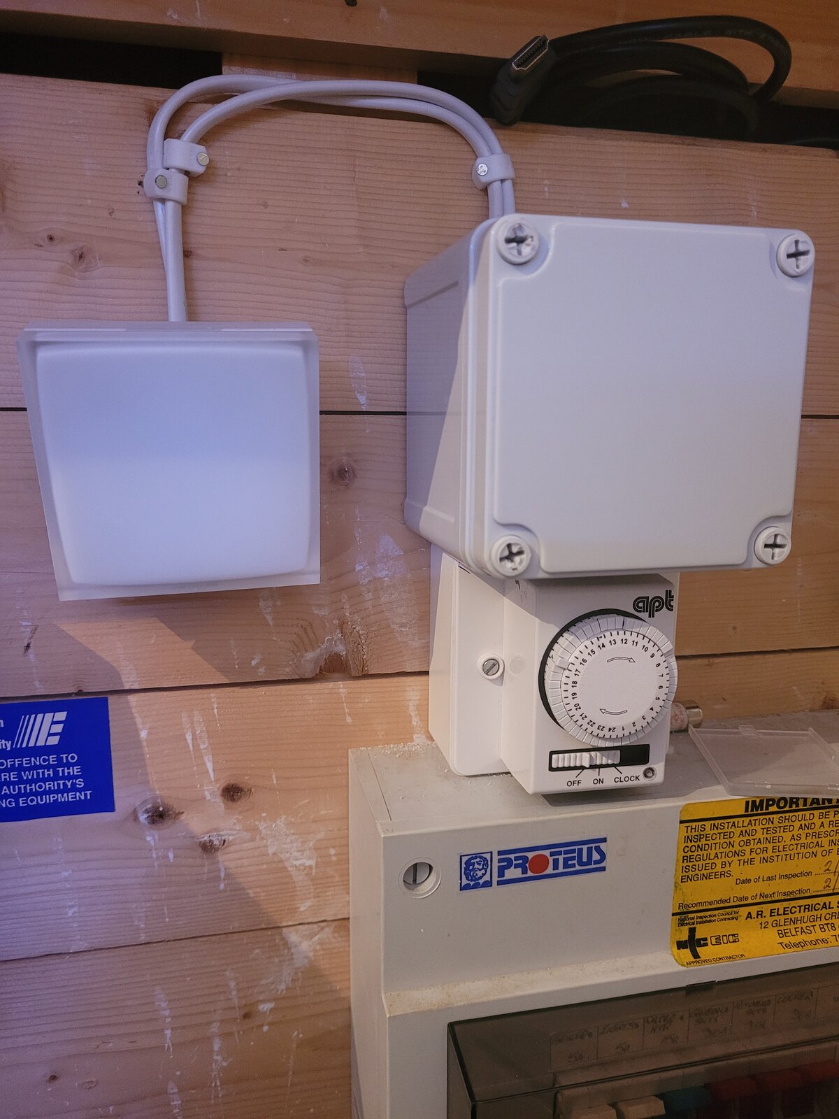

My relay wired directly into the gas boiler that it was bought for originally in a house I rented. We bought a house and it was oil and my dad adapted it so it could be used with oil. I am not sure exactly how. I will take phots this evening when I get home from work to and send them to you and I will also ask my dad how it's done. You are trying to get it to work with oil boiler right?
so this is what my dad has done to get it working with oil boiler. I don't know if this helps. I still need to speak to him to ask what he has done exactly but someone on here might be able to tell from the photo.
