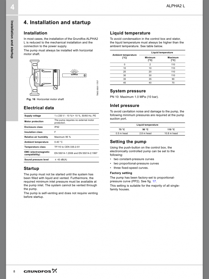

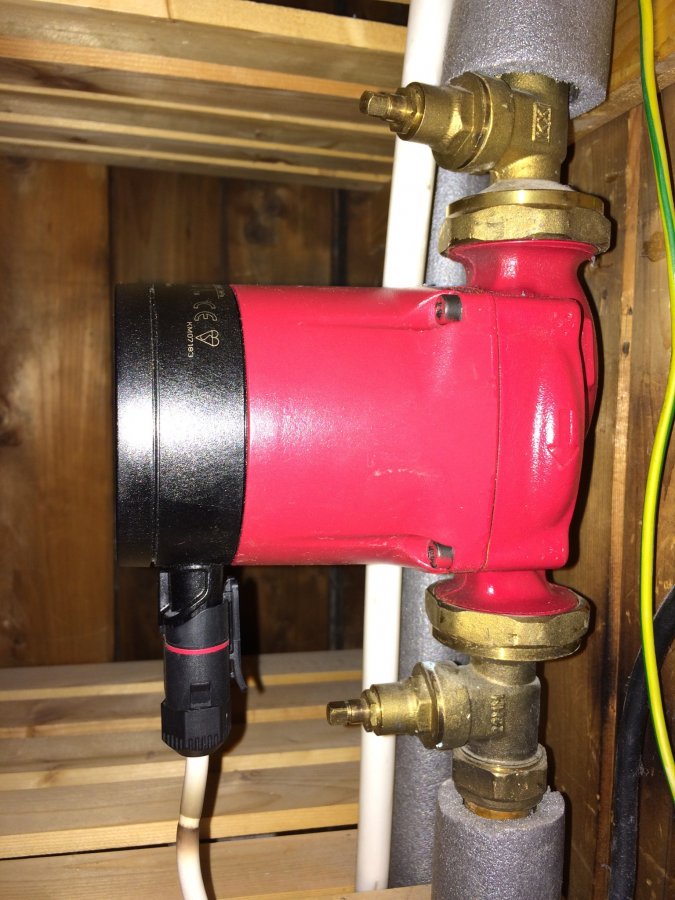

Yes that is pumping the correct way, you would be surprised at the amount of people that think if you rotate the head that it changes the direction of flow, as said in the manus instructions that they dont like the pump to be on vertical pipe but cant see why yours being that way could cause your problems
Actually the manual says the pipe work must be vertical with the shaft horizontal!

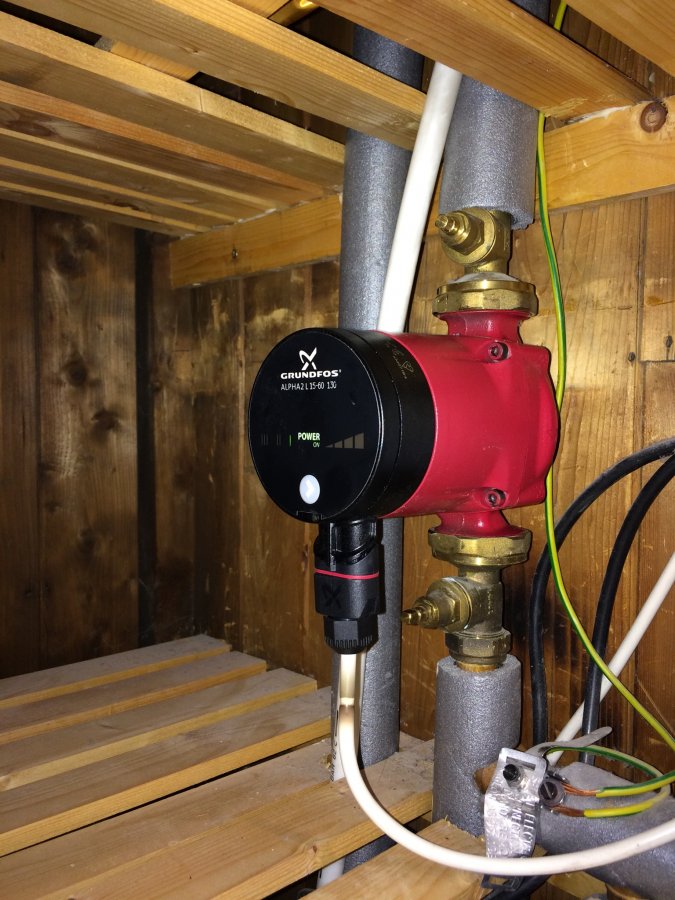

sorry you are correct I was reading that wrong there yes the shaft must be horizontal, you keep mentioning a PRV ? I thought you had an F&E tank i.e open vented system , is it a sealed system ?
No it is open vented but after the pump is 2 valves and a prv. So should the valve be shut there is a run around to prevent cavitation, but my concern is that the prv is lift too soon so is letting the feed run direct back to the boiler as he pressure is too high, thus putting the boiler into fault as the temperature is rising too fast.
Theoretically this would only happen when the entire system is hot and the TRVs have closed leaving only the hall rad to absorb the pressure and flow so the prv could be lifting faulting out the boiler?
OK got it seen the pic in full now on my Ipad, that isnt a PRV (pressure releif valve) a prv dumps excess pressure to outside to protect a sealed system boiler, what you have is an ABV (automatic by-pass valve) which adjusts to allow the flow to keep the boiler from over heating depending on how many of your thermostatic radiator valves have closed, I think as you said that the pump you removed was sludged up that your problem may be a blocked cold feed, easy to test go to the highest radiator and open the bleed valve on the radiator and hold a bowl at the bleed point and see if you get a steady flow if you do it isnt that if you dont then it is that, if you dont get a steady flow then get a magnet and see if it sticks to the copper pipe where the cold feed is connected , if it does that is where your blockage is
