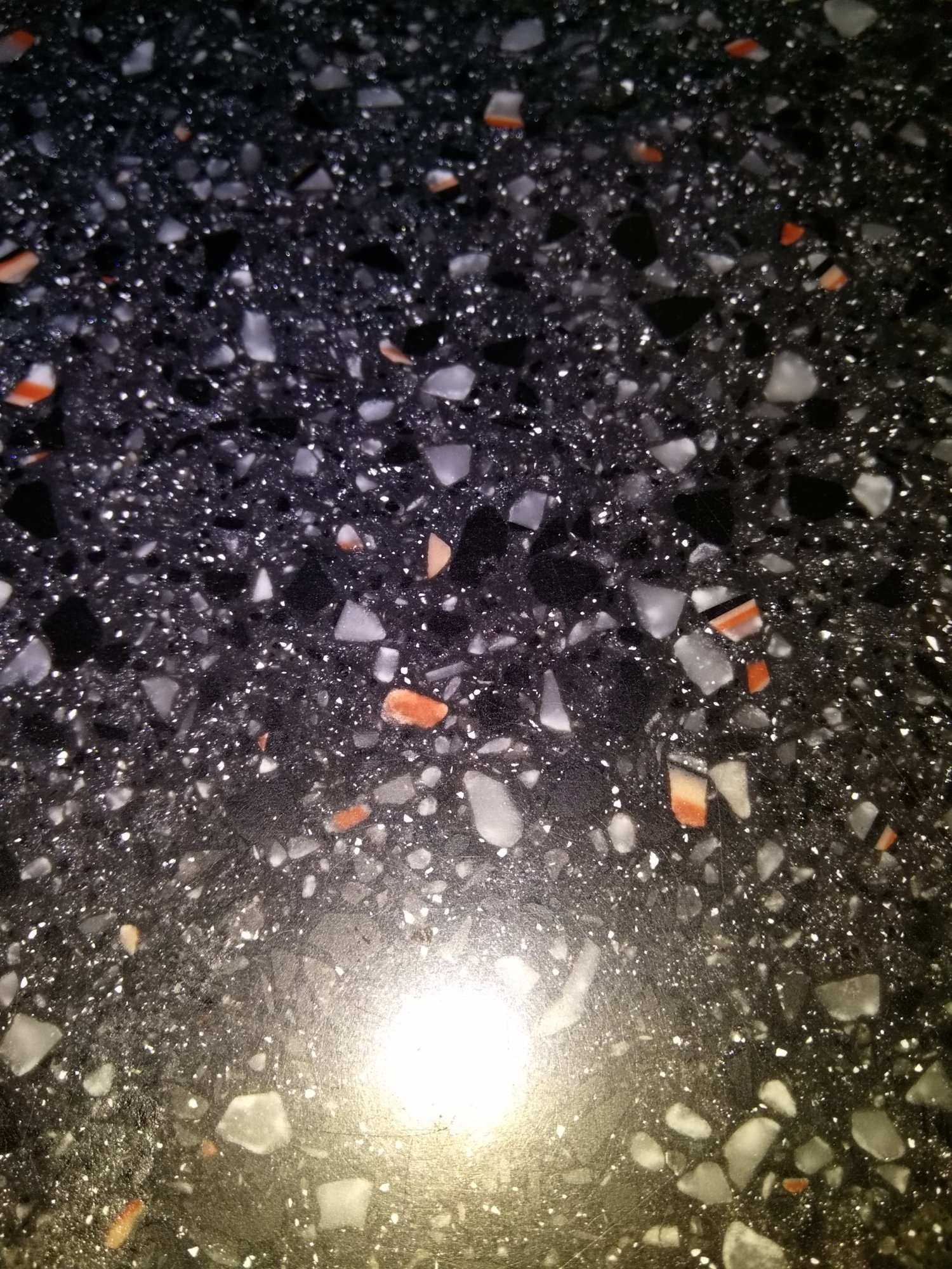

I have installed a similar earthstone breakfast bar and initially was very disappointed with finish, greying and just no shine, Matt or otherwise...
I purchased the matching installation and care kit, admittedly quite expensive, followed the instructions correctly and carefully... Then I stepped back to properly admire my work... I was gobsmacked!!! All of a sudden a glorious semi shine Matt worktop and all it's fabulous detail was revealed. The change was really transformative.
Better still, after three years it still looks good. I'm going to attach a photo of a section showing how it looks even now....
Remember, finish first before admire your worktop.
Good luck to all
