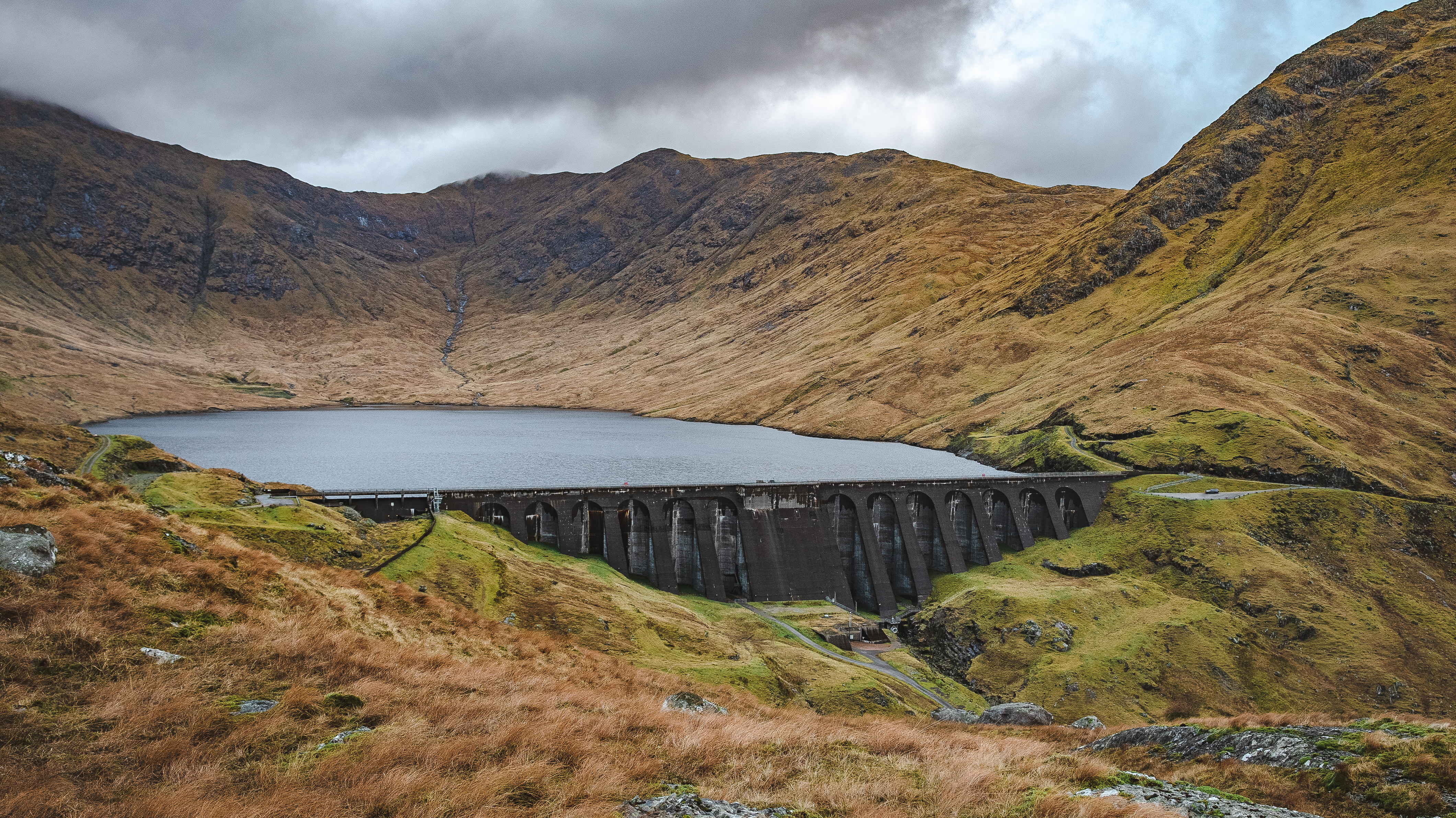

I remember when pumped water storage was being built in Scotland, it was trumpeted as if it was an important big thing, but the actual generation figures are so small that they are insignificant, except for balancing short term peaks and troughs.

Balancing peaks and troughs (needed to manage nuclear power and coal fired systems) isn't trivial. It saves a lot of money done right.

Another 3-4GW of generating power and some of them are designed for over 24 hours duration so they can be used for inter day management.

More allowing gas fired turbines to be run up. We have one finished, working and used. Dinorwig. Surplus power is used to pump water up. Running that off can help with peaks. The advantage is the speed in which they can be set to generate and for that matter top up the reservoir.
So we need more wind turbines and dams. When we don't need the power but have the wind we can pump water back into the resevoir and when we do need the power and we dont have the wind we can open the resevoir.
The resevoir acts as a battery or buffer to manage peaks and troughs in demand and production.
It's not very efficient. Losses pumping the water up and from then using it to generate. They also need a suitable site.
Many countries are using lithium batteries to achieve the same thing. Tesla often figures in that area. Dinorwig is good at handling what is sometimes referred to as electric kettle peaks - things that don't last very long and also if needed give time to allow other sources to be bought on line. There is plenty about it on the wiki and it seems others may be built
The scheme can supply a maximum power of 1,728 MW (2,317,000 hp) and has a storage capacity of around 9.1 GWh (33 TJ).[2]
