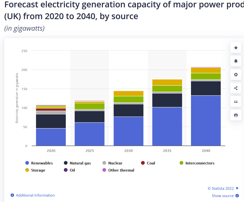

Those figures don't match the current graphs
The first search hit: This one's a shocker until you read the fine print:
THis is about the best I could find. Most sources are at least a cople of years old and it's changing rapidly.
Renewables overtook fossils in ~late 2020
Today - 20/10/22 numbers:
411.6 GWh
Total Generated Today
178.2 GWh ............... Fossil Fuels - 43.3 %
178.2 GWh ............... Renewables - 43.3 %
55.3 GWh .................. Low Carbon - 13.4 %
The daily charts for a couple of days ago shows wind at 60+%

Those figures don't match the cuttent graphs
411.6 GWh

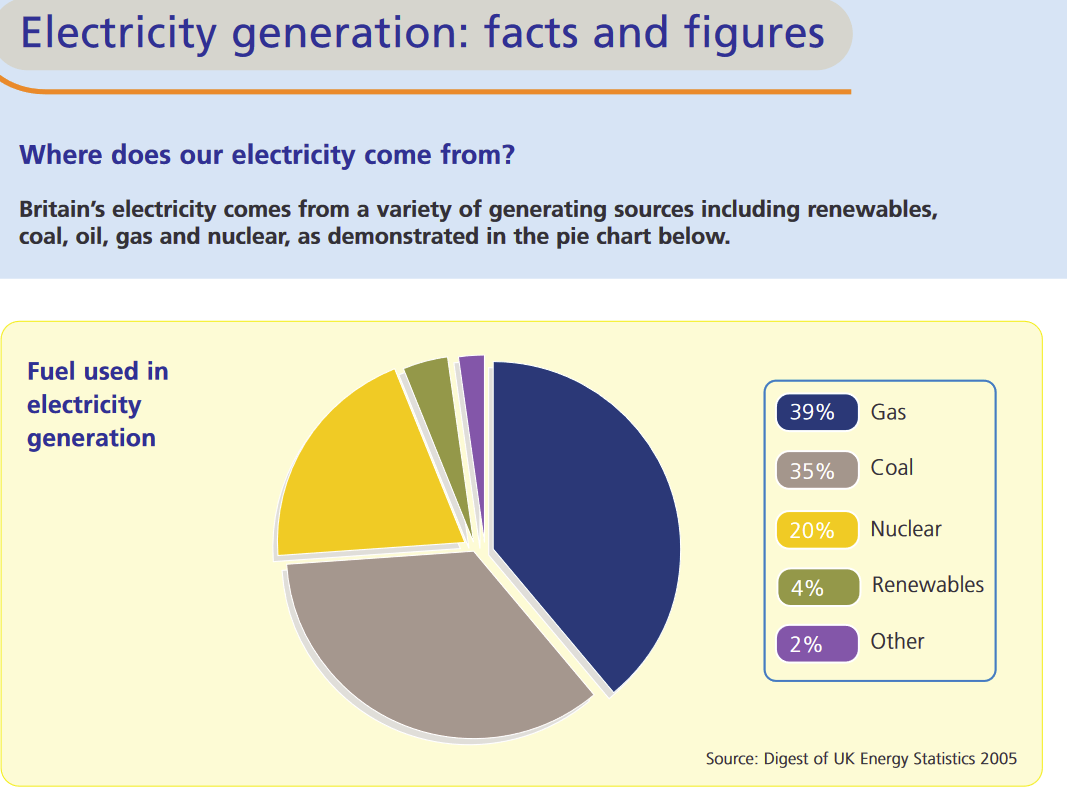

I don't want to sound insulting here but you've misunderstood a lot of what you've found.
Hornsea 2 is contracted to sell all its power at £58. That's almost a quarter of the fixed price rate. It is bringing prices down. There is no possible mechanism for it to bring the cost up.
Why on earth you include a graphic from 2005 I do not understand.
Capacity is not the same as energy produced. Modern wind farms run at an average of about 45%. Solar runs at around 11%, but it's so cheap it still works out cheaper than old Gas prices.
Wind has been doing well at the moment, which is expected as it does better over the winter. But the UK government publishes yearly power breakdowns and Wind is around 40-45% from memory.
Blaming renewables for the increased cost of Gas generated power is madness. There isn't any real dispute that renewables are the cheapest form of energy now, the only thing they are not good at is that they're intermittent.
