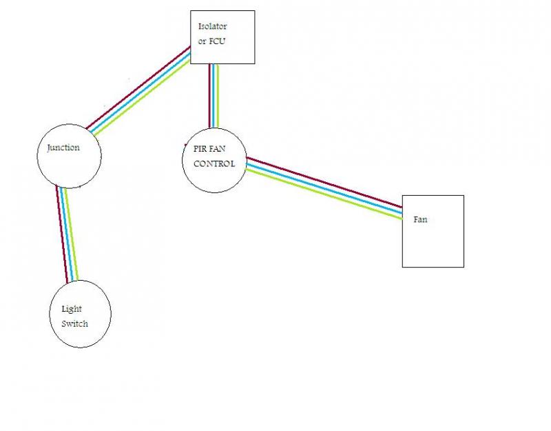

Hi,
I had a fan installed a few months ago, which turns on and off with the light. The plan was it would sort the mould out in the room, and it did for a time but started creeping back. I want to install a purpose fan controller/switch which includes pir and run on timer functionality. The switch doesn't require a switched live.

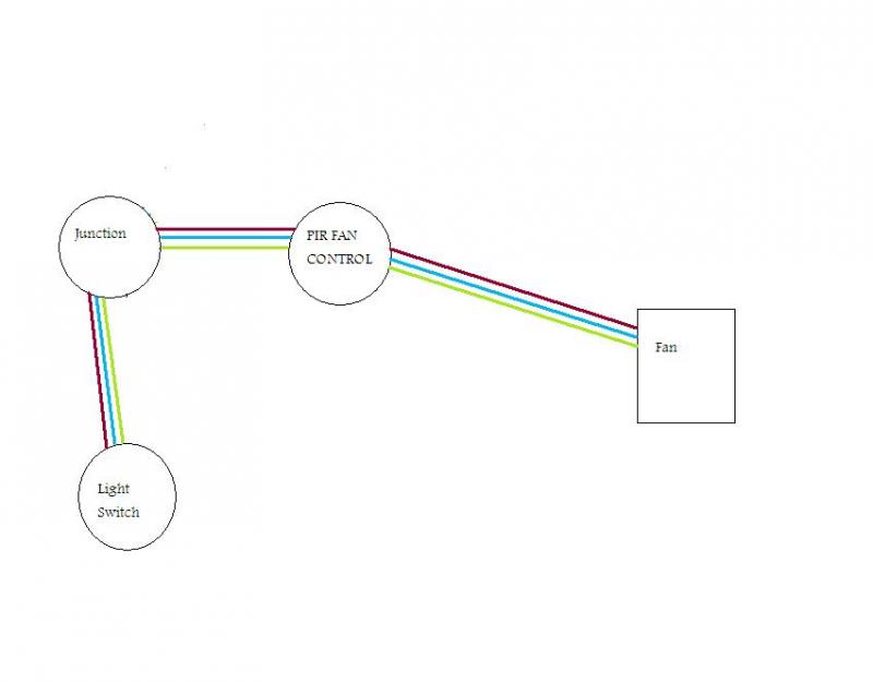

Can i connect a junction box in the loft to where the light switch currently terminates, then wire out of the junction to the light switch, and then to the pir switch? There is a window in the room, and the ceiling where it would be positioned is a good 9 maybe 10 foot high. Because there is a window i was hoping i could do away with the need for an isolation switch, so there was know way of turning off the fan on purpose or accidentally. The property is 140 years old, so condensation has been an issue in the past before i upgraded the ventilation. I have done 2 very rough diagrams, one incorporating an isolator switch, and the other im hoping will be ok since there's a window in the room. All the wiring is up to part P, i had a consumer unit fitted a few years back, and NICEIC signed it off as well as my property was chosen during the contractors audit.

The mould is no where near as bad as it was, thats why im thinking they dont leave it on long enough. During spring and summer, the fan will most likely only get used after dark. The property is on a hill so it gets plenty of light. Would any of the pictures, conform with regulations? If i wired in a 3a fcu, would an unswitched version be ok. I could get one with a light and check every time i visit the property to make sure it hasnt been removed.
I know any wiring additions in specialised areas needs to be certified and building control notified. I was hoping to run the cables etc where they needed to be, then get a spark to connect and test. A lot of the work is taken out of the equation the, and hopefully work out cheaper then. But i would need to know which diagram would be the way to go. The isolator will be in the utility cupboard that adjoins the bathroom, so 2 cable runs would need to be routed from there, to where they will need to be. Any help with this would be great, i have in the past done spurs etc from sockets. I know i could do it, ones i did past all inspections and safety tests. But because its in the bathroom and regulations, doubled with the fact i'm renting the place out. I have been looking into getting a spark in today. Cheers
The earlier comments on need for isolation and humidistats cover the way you need to go electrically.

i have read the 3 pole isolator is needed in rooms that dont have a window, so no light for servicing the fan.
That reason is nonsense as we don't have lights when servicing the lights.
Oh. Inspection lamps.
However, a three pole isolator may be specified by the manufacturer's instructions which must be followed and is useful when a fault develops - to isolate.
