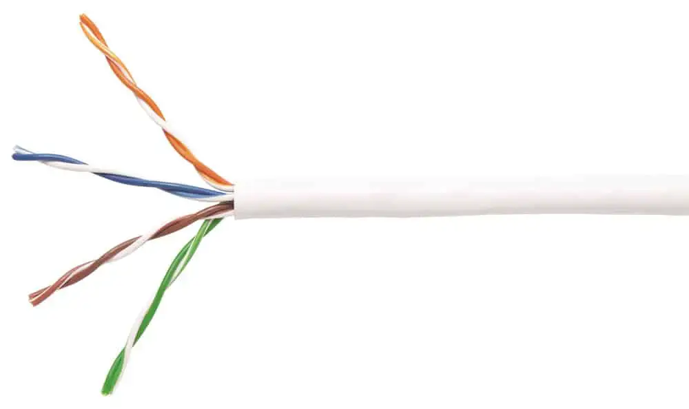

It's the colours I was going by. As I recall the progress; 1 & 2 no stripes. 3 stripes on whites, red, black ,yellow & purple's introduced, some manufacturers added stripes to main colours too. By 5 all wires striped.
The earlier cables tended to use a continuous longitudinal stripe such as this CAT4 (as we used for token ring);
although I don't think it has been a particular requirement Vs bands
It is 3 pair telephone internal wiring cable. It will work fine for a reasonable length run, instead of bell wire, but for a longer run, either double up 3 and 3 in parallel, or use bell wire.
Even better, that one is 4 pair.

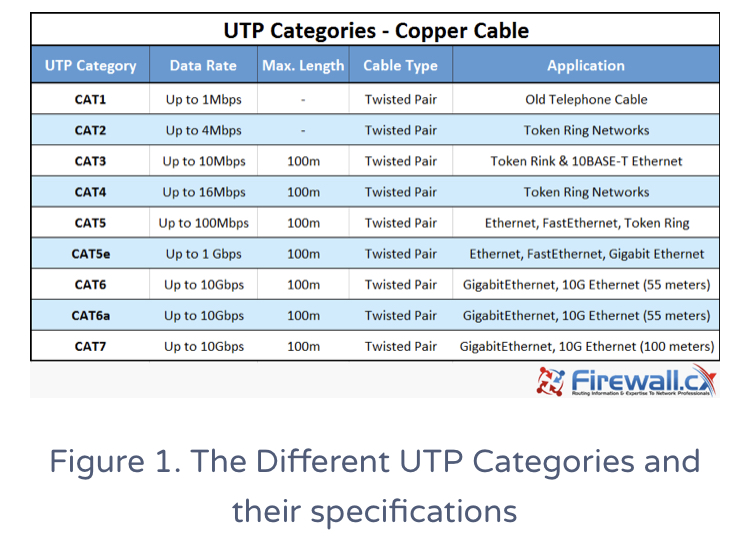

Was it called that OFFICIALLY after the Mark II?
But enough about cars - how are you doing with the specifications for TIA/EIA Category 1 cable?
