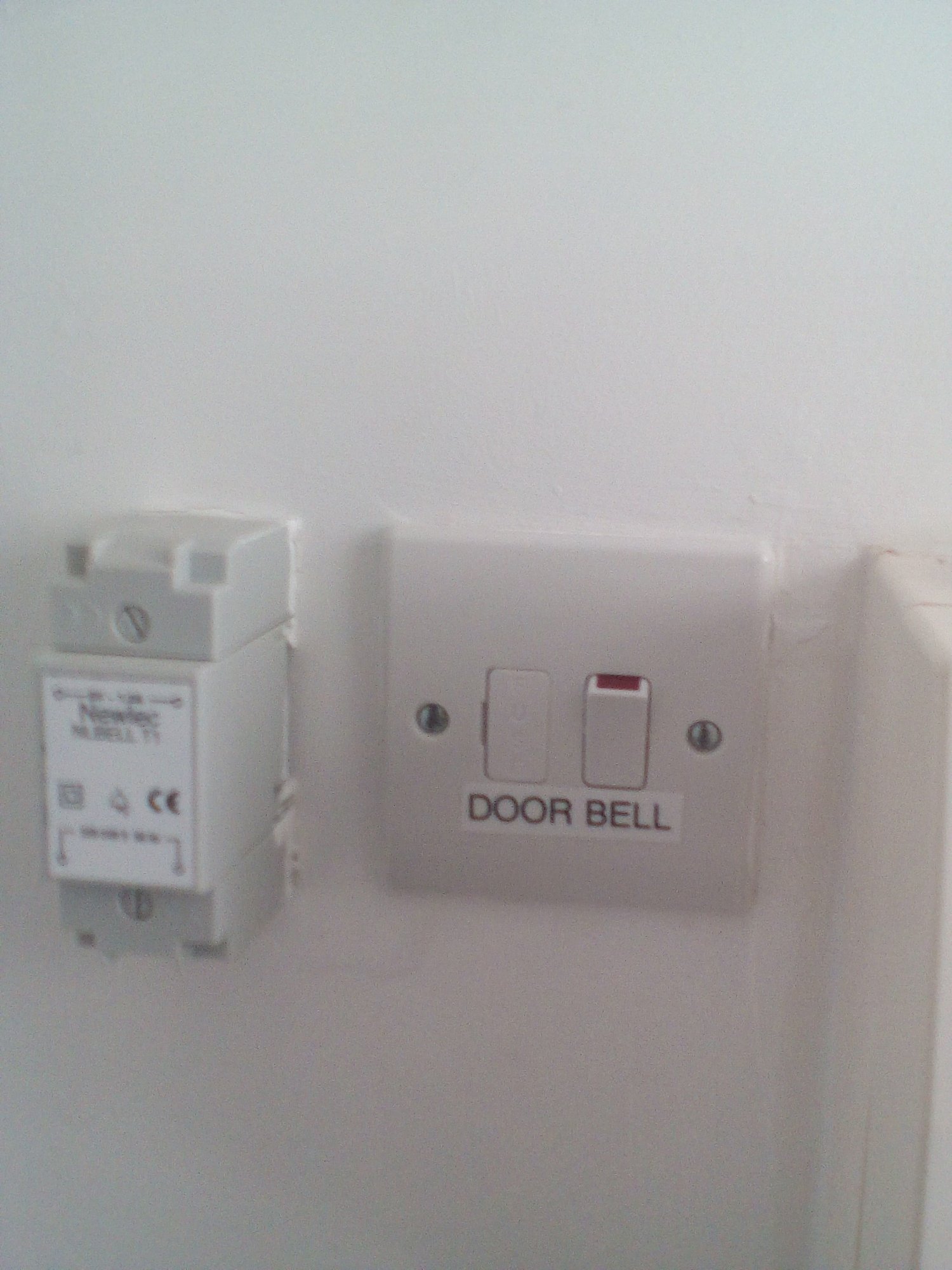

Ok this is an option but it would mean buying both the button/extender and another byron ringer to make it work. I am a little confused by the instructions listed and the wiring, I need to check my door bell, I don't have any instructions so i would only assume there is a transformer involved but i am not sure where it would be, maybe i will drop in a quick photo in case anyone can shed some light.
Here are a couple of pictures, I realised when taking the picture of the ringer i must have a transformer but as the button is on brick and the wires come out of the wall i thought it must be at the fuse box and sure enough, on the wall . . .
So if anyone can guide me on if i can jump any of these wires into the wireless button to set it off then I'm good to go without any additional spend and there is plenty of room inside where the battery space is ! Many thanks.
Tony - You cannot just use the existing doorbell button to trigger a wireless one because there will be a voltage across the button when it is not pressed and this will upset the wireless switch. There are ways round it but the easiest route is to buy two wireless doorbells and set the code so that one button triggers both units.

And not knowing about voltages and transformers is why i came here and didn't just connect the wires, I knew there would be power there but not knowing is my usual way of getting into trouble. I was hoping to find a way of bridging the two just because i can, of course i can go and buy more kit and throw away the stuff i already have but i would rather attempt to make this work, I like the idea of making things work i just don't have the technical knowledge to stop me getting into trouble or creating little blue flashes :) I like the idea of using the hammer to push the button, an actual solution that i can see working without buying more kit but that would need some nifty method of mounting the button? I am sure there is a way to use the signal coming from the existing kit to create a circuit in the transmitter button . . . so as requested . . time to open it up and post some pictures, and there was me thinking everyone would know what the inside of a wireless doorbell button looks like ! :)

As the other poster said, you cannot just connect anything across the wired bellpush due to the voltage present
Inside your wired bell theres loads of room, were there is no batteries, so inside there i put a small normally open relay across the supply terminals that become live when the wired buttons pressed.
The coil needs to match the output voltage from your newlec transfomer, possibly 8 or 12 volt ac.

You can do it by opening your wireless push, seing what the button activates, if it just shorts 2 points, then connect with small wire the same 2 points across your normally open relay, put the wireless push and the relay in the wired bell box out of sight

I suspect that when the chime's solenoid is activated the voltage will drop substantially. He'll need to measure what voltage is actually present across the solenoid when the button is pressed.
