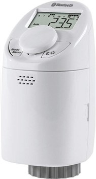

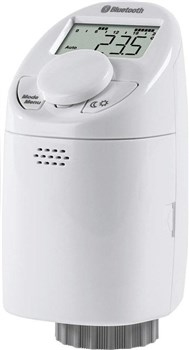

I found a problem with bluetooth was the eQ-3 heads I used would only connect to one device, and even the wifi found only connect to phone or tablet, with the computer needed to run an emulator.

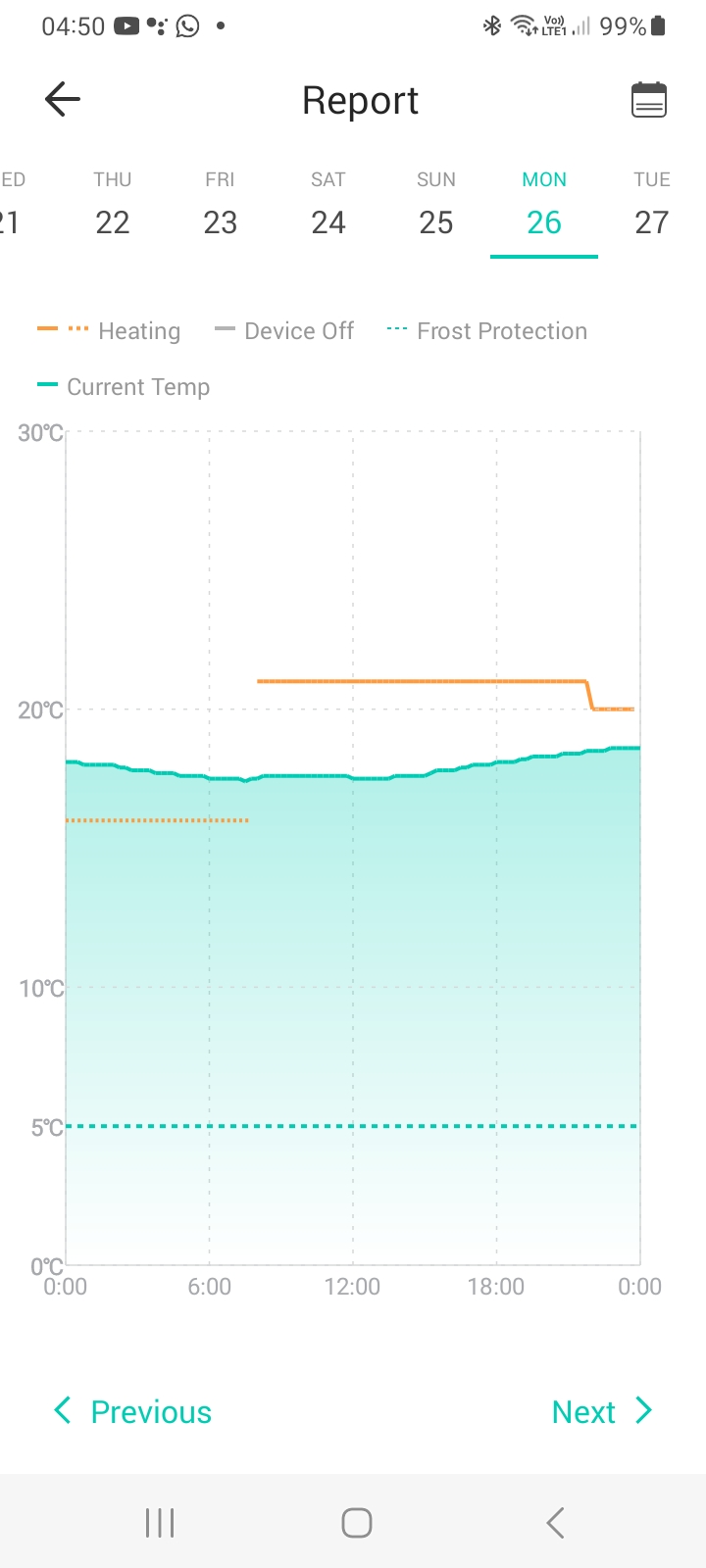

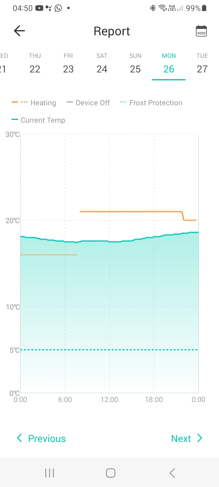

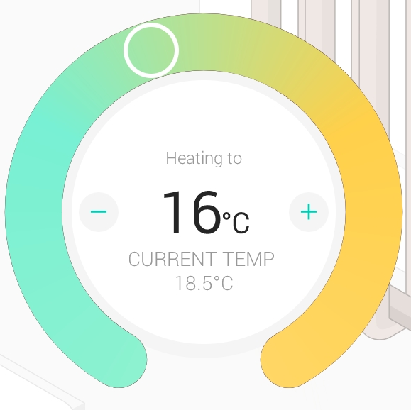

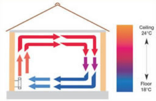

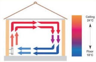

If you look at a circularisation plan, circulation.jpg any device under the radiator should monitor return air temperature, so the standard position of a TRV head is not really too bad, but my heads show the target and an current temperature, 1724730338888.png but it needs me to manually use the info. At 4:46 am I started to open the Kasa program with the emulator on this PC, 4:51 am gave up and opened on phone instead, 1724730757027.jpeg it gives a great history, yesterday shown, heating not on so just shows room temperature and if over or under setting, it shows settings 1724730993629.png but again to get that info to turn the master wall thermostat on/off there seems to be no way to interconnect, my silly Nest Gen 3 seems to not integrate with anything.

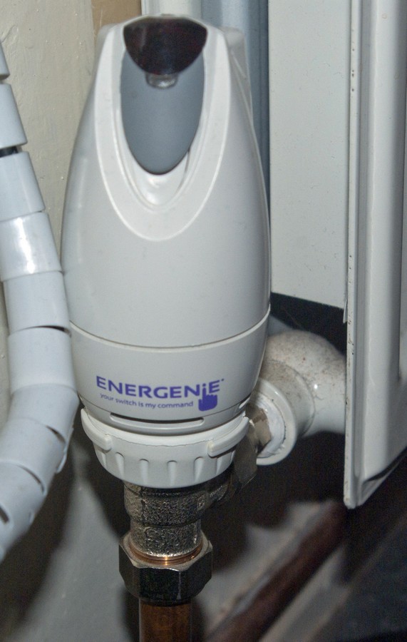

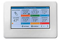

So to get the TRV and some sort of hub to talk to each other, I would need to install a different wall thermostat, this EVO-home1.jpg does seem ideal, however Wiser and many more now allow the same, however the critical unit is the TRV, this IMGP8035.jpg was claimed to work with Nest, it does not really work with Nest, and it has no manual controls, I am forced to set it on the PC or phone, simply no manual method to set, EQ-3 Bluetooth Smart Radiator Thermostat.jpgthis one is blue tooth, but can be manually set. And when I got them just £15 each, the Wiser TRV is claimed to work out time taken to heat room, and you set time you warm room warm by, rather than when the heating comes on.

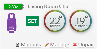

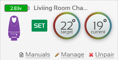

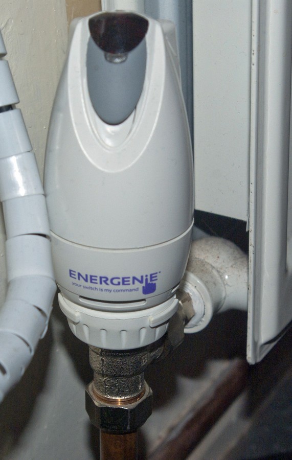

The Energenie one shown was rather poor because the anti hysteresis software was OTT, set it to 20ºC at 7 am and nearly 10 am before it had got the room to 20ºC so would set to 22ºC at 7 am and 20ºC at 8 am and room would be at 20ºC at 8 am. However this means that the geofencing was useless.
