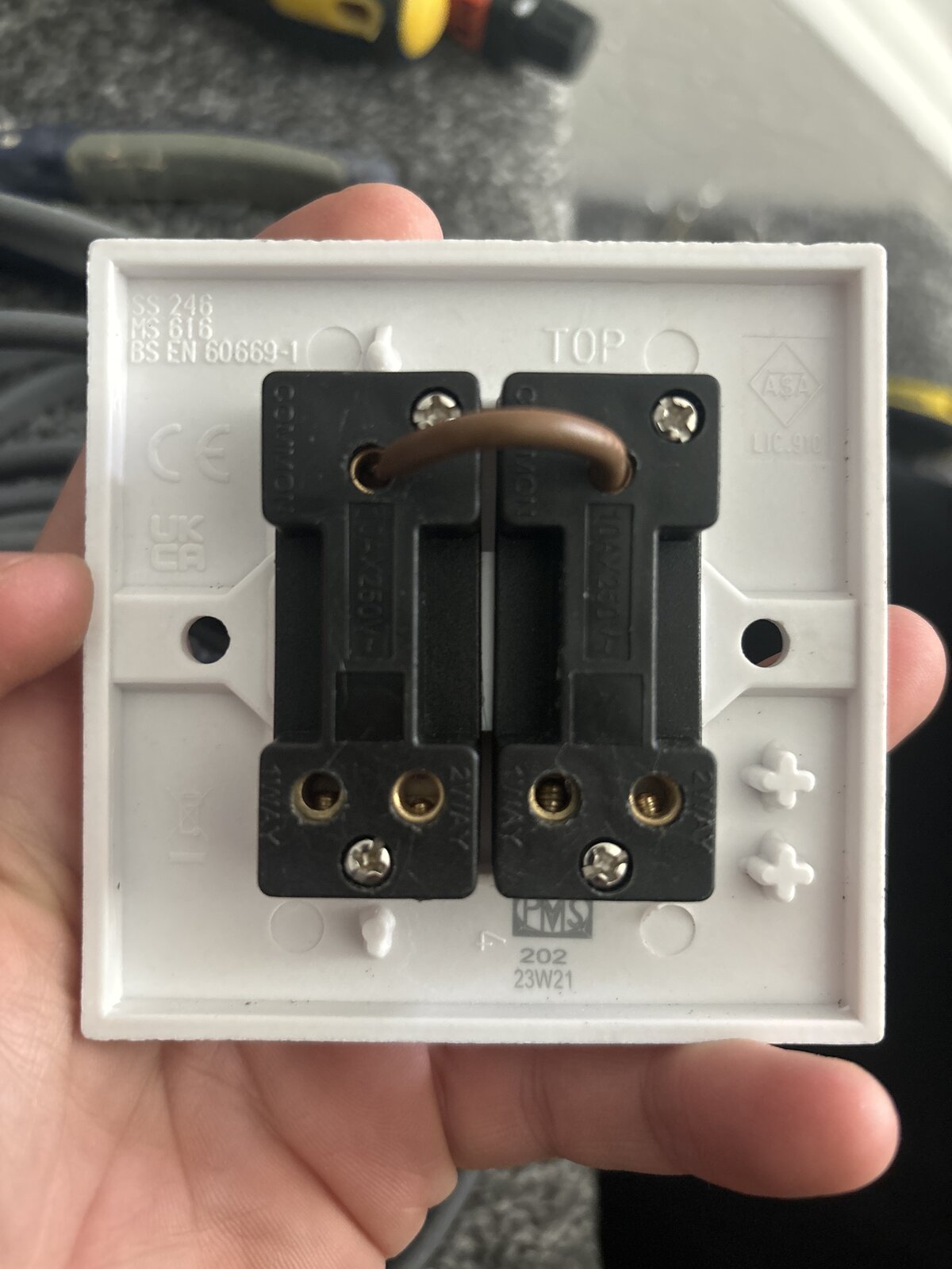

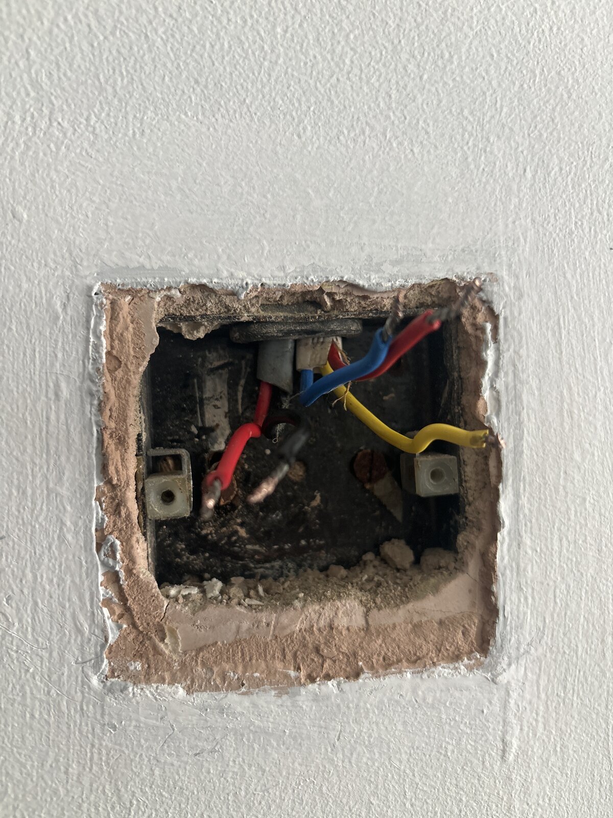

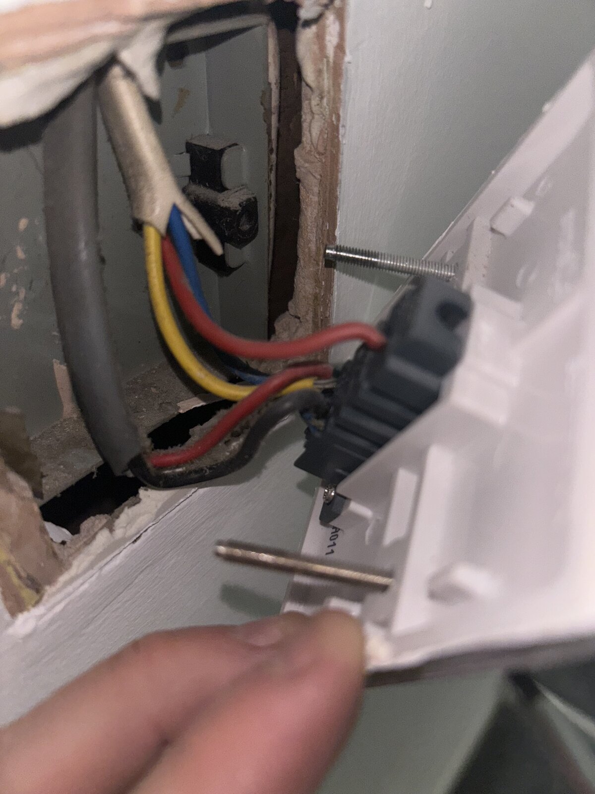

Hi, I've recently swapped my landing light switch (one at the bottom of the stairs, there is another at the top which I haven't touched) but I've only just noticed that the upper switch does not work and I've now deleted the pictures I took!
The problem switch is 2 gang and controls the landing light and hallway light.
Can someone help me with wiring from the attached photos?
Pic 1 is the upper switch which has not been touched - to clarify red/yellow in L1 and black/blue in L2

Hall light switch - Red/Black cable - Red in COMMON, Black in 1WAY
Landing light switch - Red/Blue/Yellow cable - Red in COMMON, Blue in 1WAY, Yellow in 2WAY.
