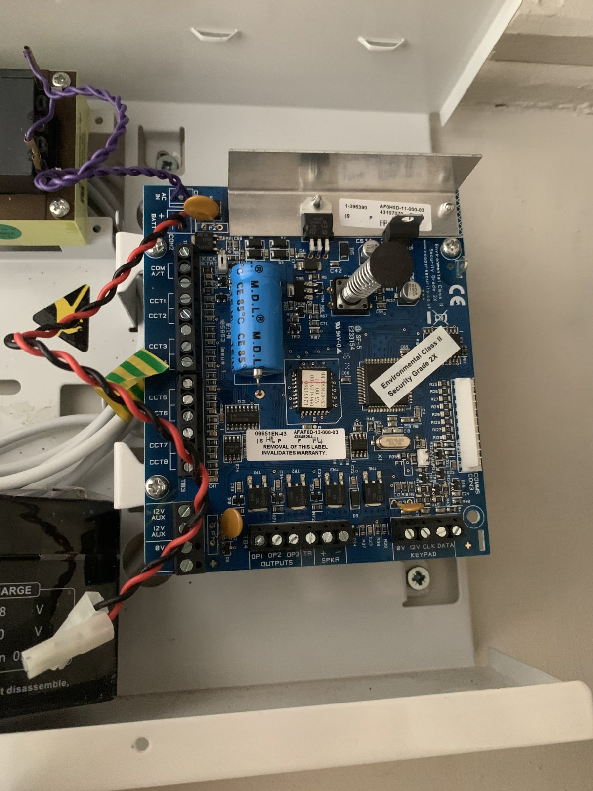

Hello,
I have a burglar alarm that has been left partially set up for a long time. My PIRs are wired up (about 5), bell externally fitted and the key pad is in position - all wired by an electrician a few years back. I just don’t know how to finish it off.
The panel looks like this
Can anyone offer any suggestion how I can wire this up, during the lockdown period.
Any help appreciated?

I have had a look. Just wondering
1. where does the bell go? Is it in the speaker +- sections, and leave the other 4 outputs.
2. The keypad section has 4 places, but there are 5 wires, any ideas?
3. The COMM A/T on the left (under the ac), what is this for?
Can anyone help?
thank you
Firstly be careful to make sure you have isolated the mains. The thing top, left is a mains transformer.
The PIRs are not wired up yet. You have your PIR wires I'm guessing the white wires with earth tape on them.
There will be 6 cores. 12v +-, tamper loop, and circuit loop. You need to think about the zones you want each room to be in. e.g. front door, downstairs upstairs etc.
You can daisy chain more than one circuit loop in to the same zone, but you can't wire them in parallel otherwise both PIRs must activate at the same time to trigger the alarm. You are going to need to find the wiring manual.

Each passive will probably (or should be) on a 6 core cable, you might have to open one to get the correct colour sequence thats been used but they should be 3 pairs, +ve and -ve supply, alarm trigger (so those go to whatever zone you are connecting to) and the AT (anti tamper) which are connected to the little microswitch that goes open circuit if you open a passive and obviously alarms if wire is cut.
So I tried to set the alarm without the resistors today. However something is t right, please can you help.
The PIR are working and motion sensitive (as red light comes on when moving in front of all).
Keypad now has a power source (lit up), but not sure if it is responsive. When external bell comes on, can’t deactivate it with pad. The keypad acknowledges that button is being pressed, as it beeps on pressing each button. However, nothing else happens on display, except a wrong date.
- when external bell is plugged in, it sirens, can’t turn it off, unless I take the positive wire out.
does anyone know what the problem is?
thanks
Sounds like you have the keypad wired up wrong, the power will basically power it up and do the beeps acknowledging keypresses but it sounds like you have the other wires crossed somewhere.
Again it will be in 6 core, sounds like you have the power correct, but there will be two for anti tamper and 2 for data.
I looked behind the keypad, and it looks black, red, yellow and blue are plugged in, in that order, so I repeated this on the control panel. But no change. I initially had green instead of blue on panel, no difference. Shall I try all the combos?
