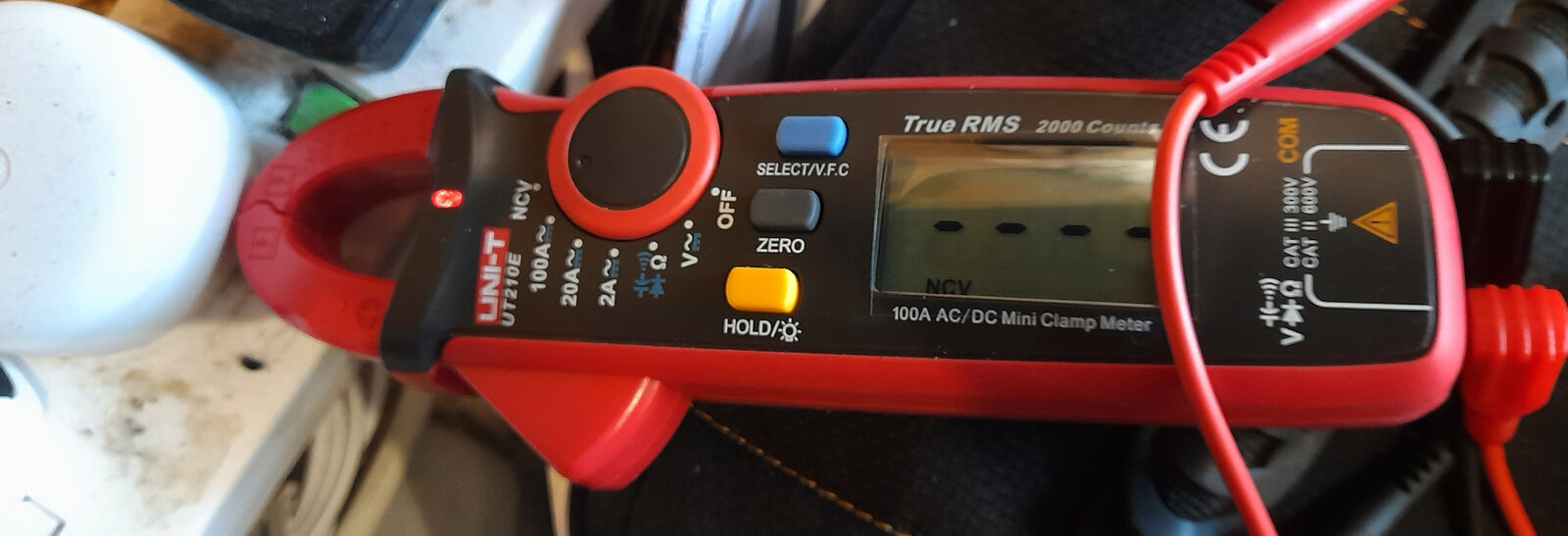

Unless some thing goes wrong, I would not open a plug at home, of course I have not wired them all up, and if some one has swapped brown and blue likely I would not know.

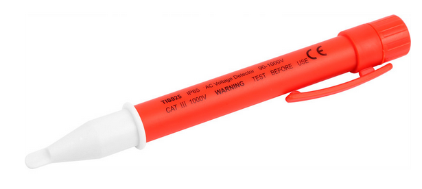

What we need is an easy fast way to test, unlikely I am going the remove the plug top to view inside. Out of interest I tried with my non contact voltage tester which shows 4 levels of voltage detected to see what it did when items were switched on/off, with the idea it would show very easy if line - neutral were reversed, however it showed a wall as being line, and also all the 5 volt DC supplies to my Nest Mini speakers.
On an extension lead switched on at the wall 4 bars, but switched off still on bar, Testing for live.jpg because it does show one to four bars, one can see a change, but this 1714585342118.pngwith no indexation as to how strong the signal is, must be next to useless. OK my tester at £35 was not expensive, it is a handy quick to use tool, and testing an extension lead it does show 3 bars near neutral or earth and 4 bars near the line, but still rather a hit and miss method to test for line - neutral reversal.

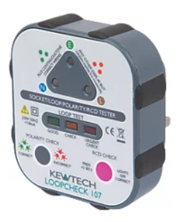

Socket tester 1714585873259.pngwould be better, but when I did a google to get the picture, this one priced at £61 that's a silly price. And the instructions
