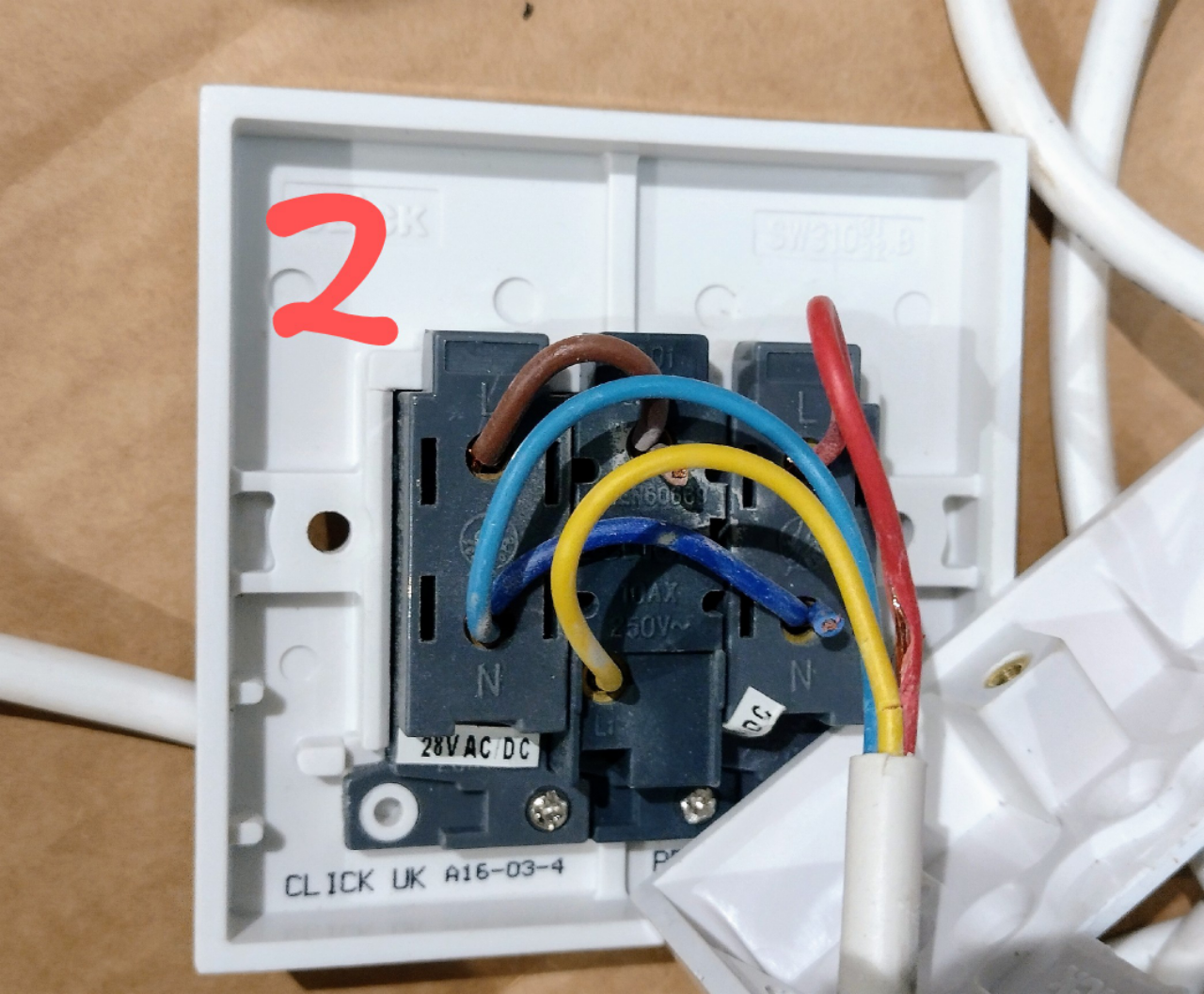

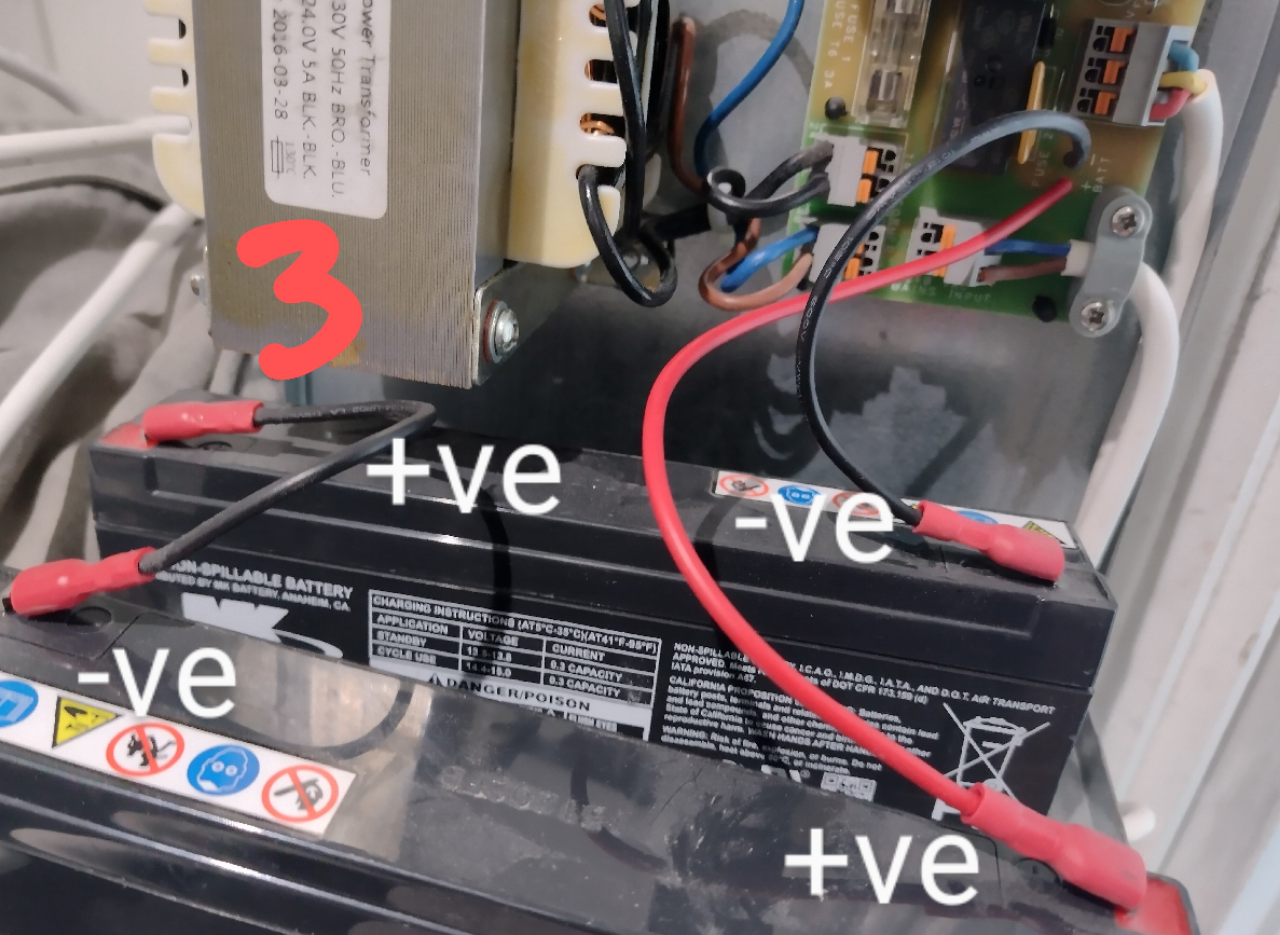

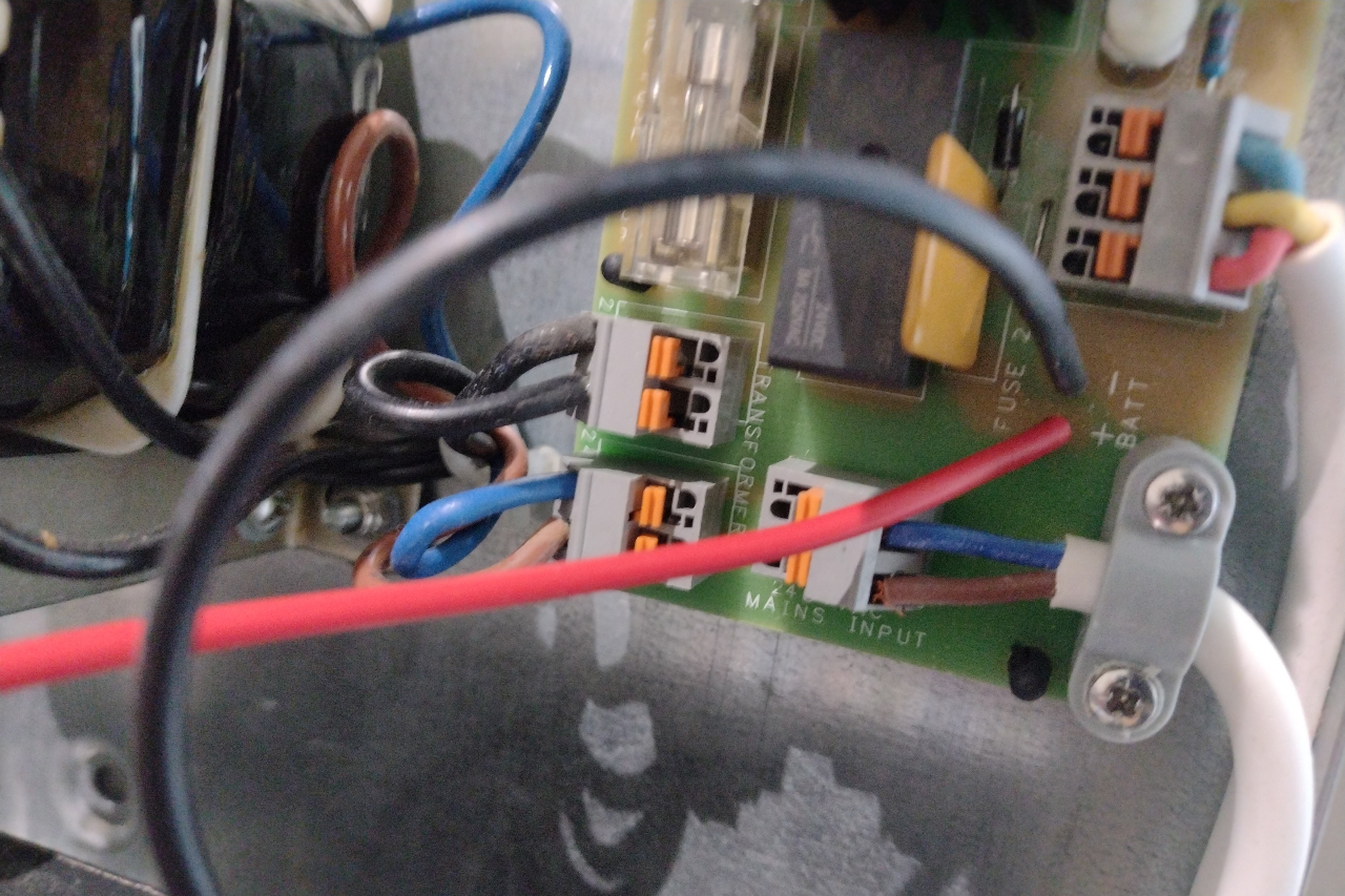

Fitting a bath lift and want to make sure my wiring is correct in advance
1. Wire cable from bath lift (1) directly to the isolator switch (2)
2. The other end of the isolator switch (2) is connected directly to (3) which contains a circuit board/ transformer/ batteries
3. Wire other end of (3) directly to back of socket i.e. ring main circuit or plug top
All of the cables are two core, no earth.
Battery Backup wiring
1. Connected +ve and -ve terminals from board (3) directly to the +ve and -ve terminal on each battery
2. Then took another cable and looped this between the two batteries +ve and -ve terminals

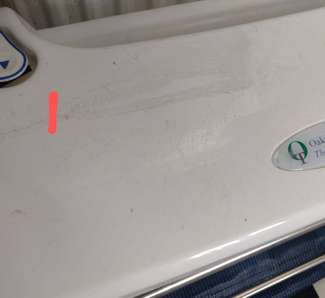

Not sure what's going on in your third picture (the back of the panel showing terminals). You have bare copper exposed in the red core, a nick in the yellow. A brown and blue conductors snipped of in the terminals an left.
The item came like this. I would only work with fresh wire which hadn't been nicked/ copper exposed

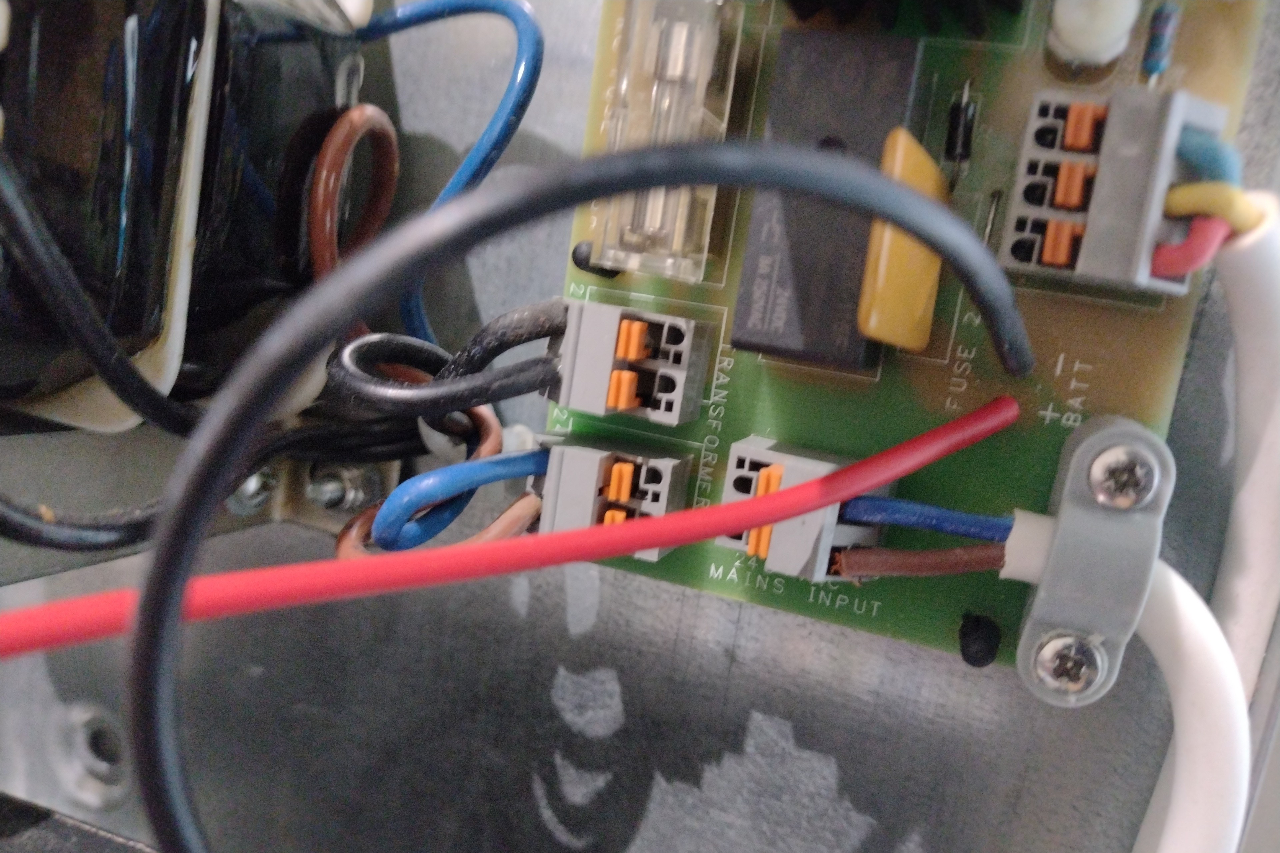

1671360425178.png Where the 3 is one can see a transformer, this is clearly 230 volt, I have an old copy of the regulations which say
In zone l, only the following fixed and permanently connected current-using equipment shall be installed, provided it is suitable for installation in zone I according to the manufacturer's instructions:
(i) Whirlpool units
(ii) Electric showers
(iii) Shower pumps
(iv) Equipment protected by SELV or PELV at a nominal voltage not exceeding 25 V a.c. rms or 60 V ripple-free d.c., the safety source being installed outside zones 0, 1 and 2
(v) Ventilation equipment
(vi) Towel rails
(vii) Water heating appliances
(viii) Luminaires.
Note "safety source being installed outside zones 0, 1 and 2" and it does not list a lift, so the control panel must be outside the bathroom, or need a tool or key to gain assess, I know of people who have fallen foul of this as bath panels clipped in place, and did not need a key or tool.

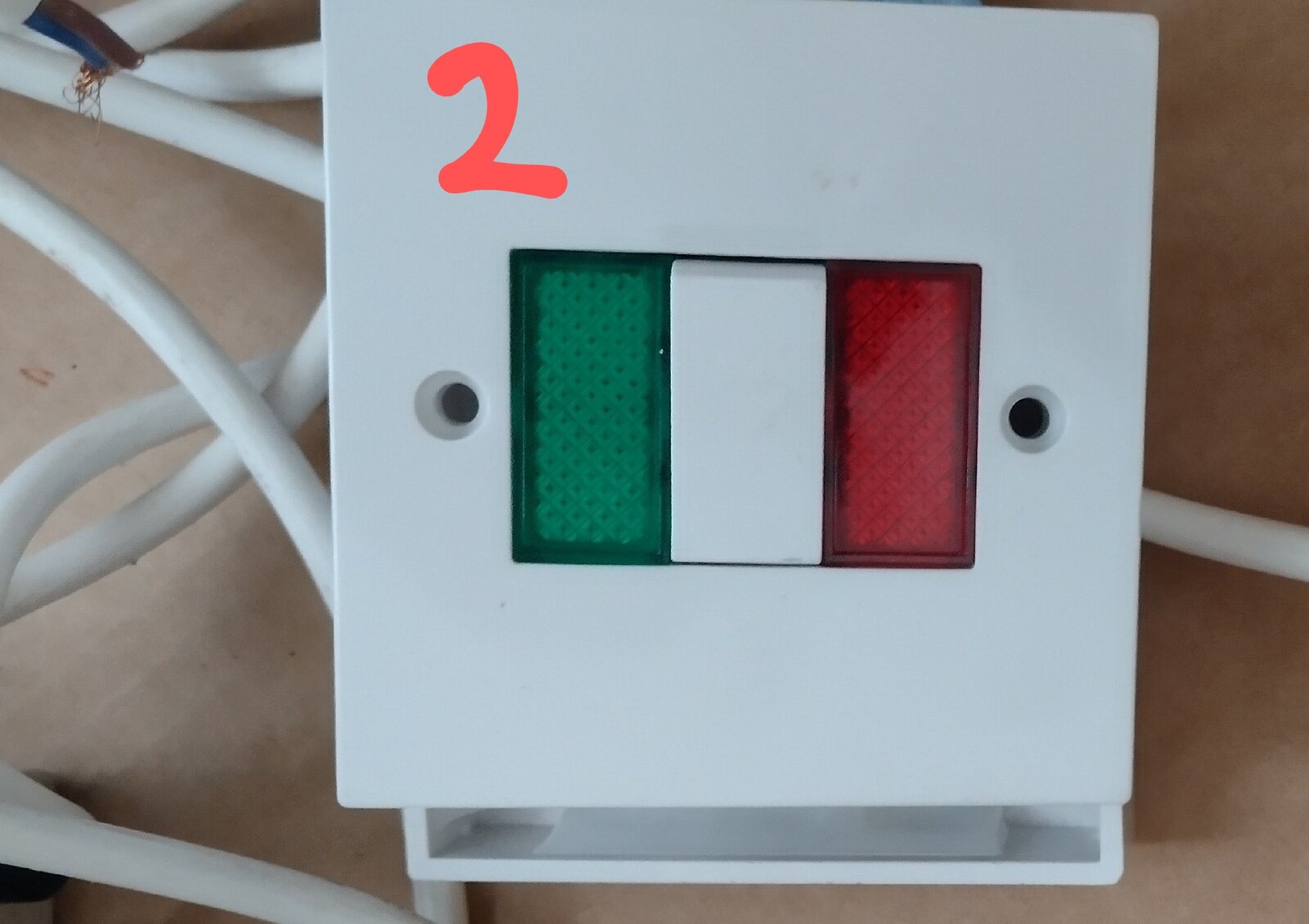

Something not right with that switch, it looks like its 2 indicators either side and a switch in the middle. The switch then only has the affect of connecting the yellow to the red lamp, nothing back to the board. Surely the manual has detailed instructions for the wiring? though if they supplied cables stripped so badly then there's not much hope. You need to strip that cable back and get good undamaged cores to work with, and remove those cut off pieces of random wire.

-Nothing is in the bathroom, i simply want to test whether the equipment actually works before calling out a sparky and potentially wasting time/money
The sticker says 28V. But underneath, the actual plastic moulding says 250V
That's odd. As far as i know it is part of the original equipment supplied with the machine.
