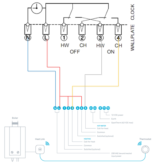

Wiring centre not as per Y plan diagram
It is a Y plan, one set of valve wiring and its got a white wire in it as one of the 5 wires.
I'll double check tonight that it's got 4/5 wires coming from the valve into the wiring centre to confirm Y plan.
I'm assuming that if it's Y plan I still set up as per my diagram and there won't be an extra wire for HW OFF going to my programmer. (If there is should I just connect to the L)
For 'Y Plan' with a single 3 port motorised valve, there should be a wire from the 'HW off' on your existing programmer that goes to the Grey wire on the motorised valve.
That will connect to the 'hot water satisfied' on the Heatlink
A wire from cylinder stat Sat terminal must also be connected to the grey wire/HW Sat, i.e. three wires connected together.
I'm assuming that's already in place at the wiring centre. As I'm connecting the HeatLink into the wiring at the programmer end, then it's not relevant. Whereas Stem's point about the 'HW Off' being connected to the 'Hot Water Satisfied' is valid.
Thanks for all your help guys.
Finally tackled it today (wanted to wait until the other half was away for a few days in case it didn't go to plan).
All done and dusted in less than an hour. Everything connected and working like a dream.
