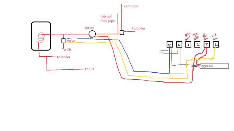

Hi all, I wanted to replace my RWB2 with a horstmann s27r programmer.
I am reasonably clever when it come to diagrams but I can not figure this out at all!.
Currently on the RWB2 I have
On the back of the RWB2 it shows the internals like this
as per the direct replacement rwb29

You are right about the two units having identical connections. So if you have swapped like for like it should work as before. Have you checked the connections haven't pulled loose, or that you haven't trapped the insulation rather than the conductor.
However, your first diagram is rather puzzling.
1. If it's a Y plan, there are a lot of components & wiring missing from it
2. Also the Pump or Valve. What does that mean? it's either one or the other and they are certainly not wired the same. A pump doesn't require two live connections as you have shown.
3. If you can't have the central heating on without the hot water, it's either not a Y plan or if it's been incorrectly wired.
Click here for a wiring diagram for a Y Plan showing it in central heating mode only.
When you say it doesn't turn on anything. Do the CH & HW lamps illuminate on the programmer?

Having looked again at my system I do not have a 3 port valve, only a 2 port valve.
Hot water go's up into the HW cylinder and at the top of the coil there is a t junction then about 4 inch of pipe then a 2 port valve and onto the rad's.
All I wanted from this programmer was to have HW on only in the morning and then both HW and CH in the evening. Perhaps this programmer is not suitable.
I need a weekend on it! :)
Thanks for you input thus far!
The programmer is not the restricting item, the existing plumbing is.
With your current configuration the hot water must be 'on' (terminal 3 is live) to operate the boiler and the pump. When you require central heating, terminal 4 becomes live as well and opens the valve feeding water to the radiators.
With the current plumbing as you describe it, you cannot have the central heating 'on' without the hot water being 'on' at the same time.
However, you can have the hot water 'on', on it's own.
Based on the information you have provided, I would expect the wiring to be as shown below. In the absence of other details, I have assumed that:
1. The pump is wired directly to the programmer. However, this may not be the case. Some are integral with the boiler or controlled by the boiler via terminals provided for this purpose.
2. There isn't a room or cylinder thermostat fitted.
3. The boiler requires L (Live) N (Neutral) and SL (Switched Live) which are connected as shown.

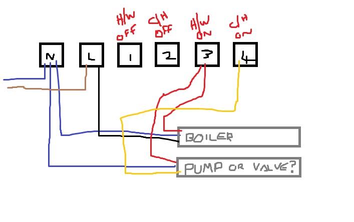

Hi Stem,
I was aware that I could not have CH on its own.
My initial problem is I have straight swapped the programmers and in theory it should work, but it isn't.
I've done a new drawing tonight, hope it helps and makes sense.
So yes your drawing is correct.............which brings me full circle as to why the new programmer will not straight sawp.........unless as mandate says the old backplate is naff
There are other possibilities.
By coincidence the boiler has failed just at the time of the swap
Your new programer is faulty
The fuse has blown
One of the original wires was not securely in place and changing the programmer has disturbed it, or damaged the backplate
As Mandate suggests, either fit the new backplate supplied with the new programmer and then see what happens, or put back the original RWB2
I would test the new programmer with its back plate before installing.Testing for continuity from L to term 3 and L to term 4.
I realize you may not be able to get the meter probes direct on to the terminals, but extending the terminals with short wires will overcome this.
