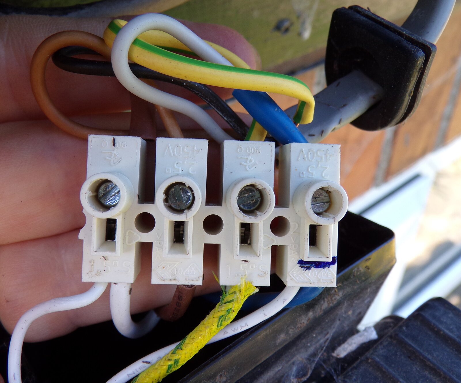

Hi there, im replacing an old PIR Floodlight with another PIR Floodlight which is virtually the same as the old one has now broken.
The old one also has the attached PIR and is also wired up to a switch inside the house so i can manually turn it on and off if required.
104_1483 (2).JPG<old one

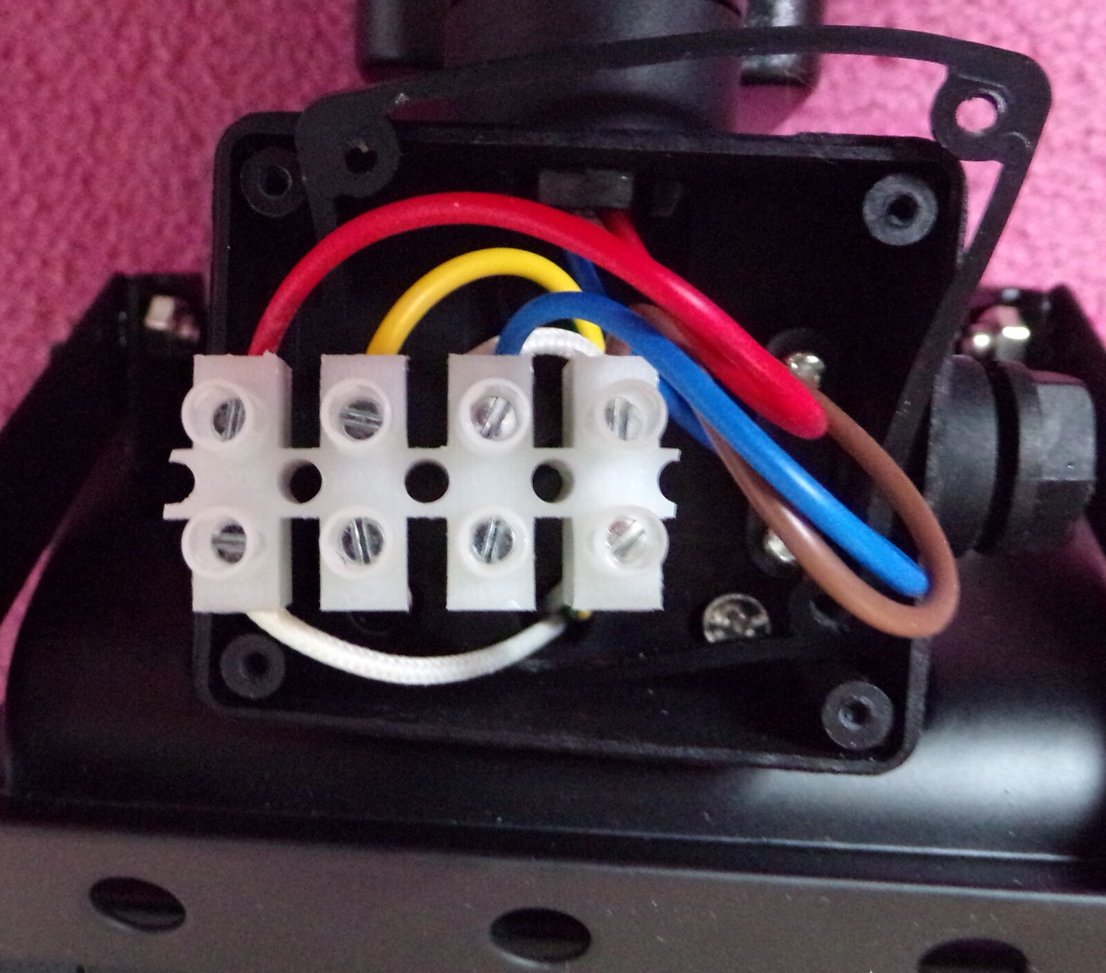

I was hoping the new light would have exactly the same wires as the old one so i could just copy what was already there, however the new one has a red wire 104_2219 (2).JPG
The red wire has thrown me off a bit so wanted to to check if this would be the correct way to wire the new one up
1. Brown to Brown
2. Grey with Blue Sleeve to Blue wire and White Wire
3. Yellow Green to Yellow Green
4. White, Black with Brown Sleeve to red wire
Many thanks for your help :)
I think you're correct poppy. Were there paper instructions just to be on the safe side/double check?

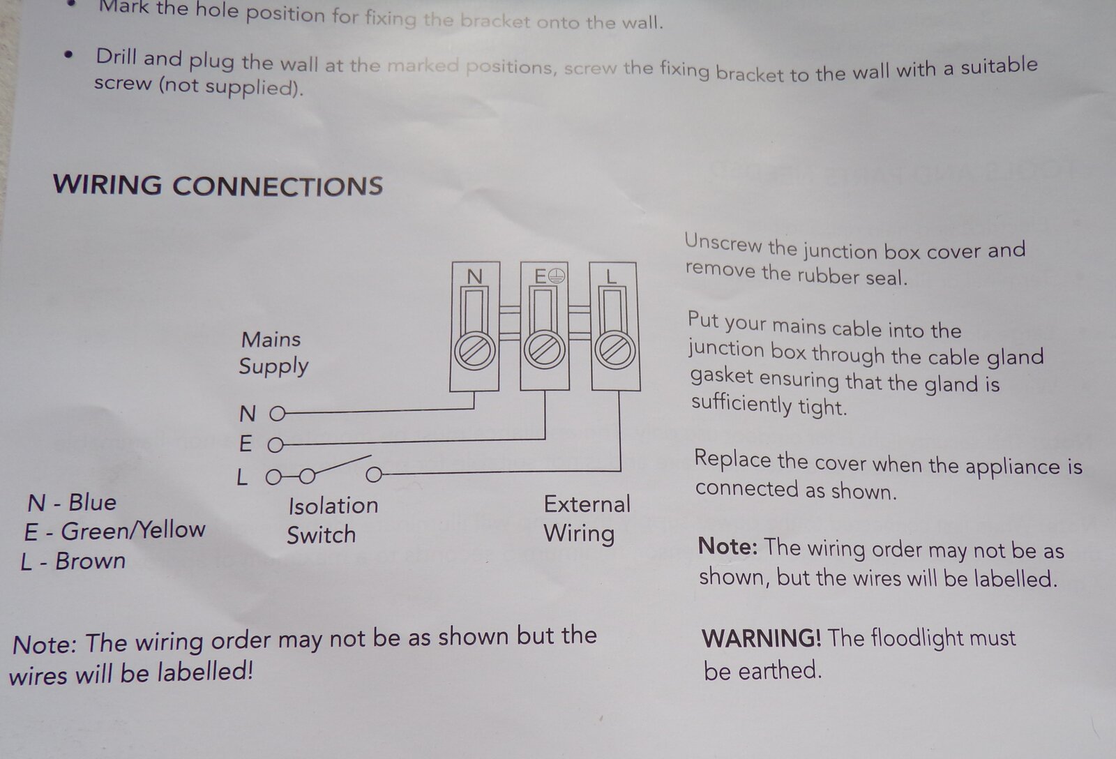

Thank you, yes however this is all the instructions said, in regard to the wiring
That's 4 way block on the light but a three way block on the instructions no wonder you're not sure!
