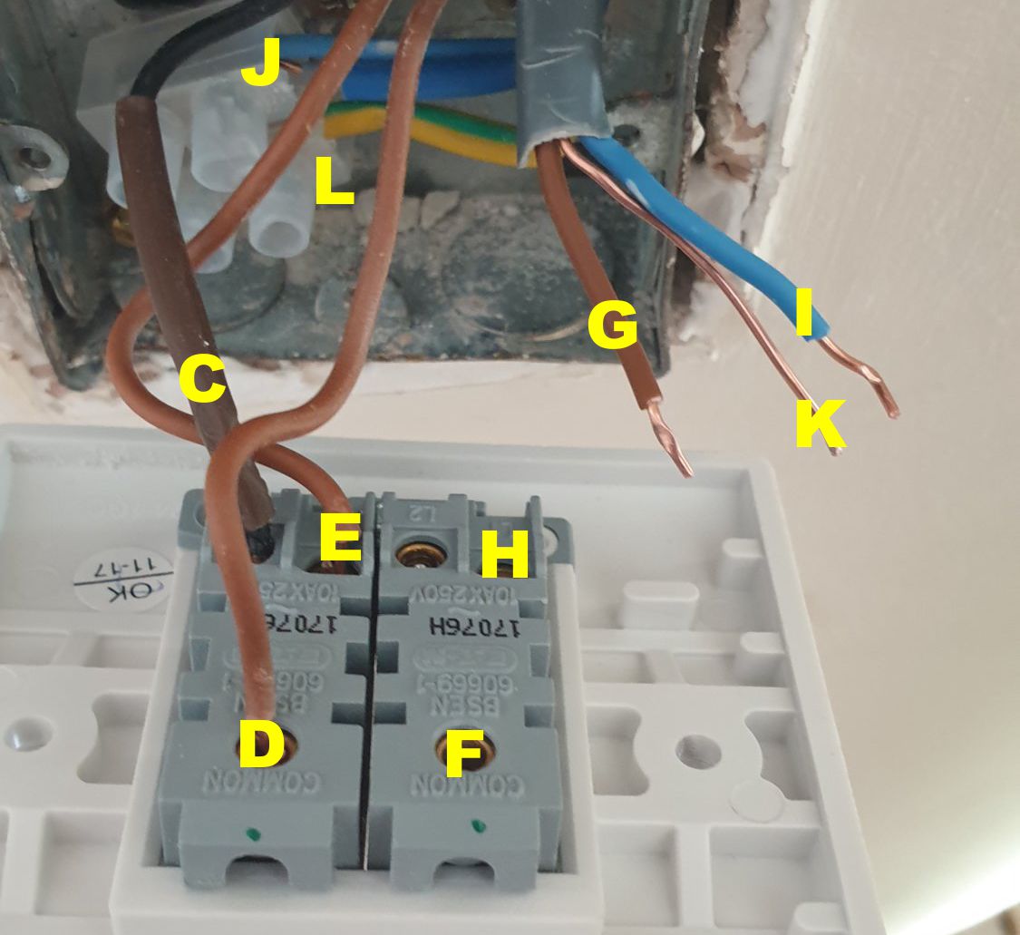

The only way to get that resolved and still have 2 switches for the kitchen light is to install new wiring. That will probably involve damage to walls/ceilings.
If you want the outside light working and only 1 switch for the kitchen light, then it can be done with the existing wires.
You could even use the same 2 gang switch, it would just mean that one of them won't do anything (much like it does now, except the working one would be for the outside light)

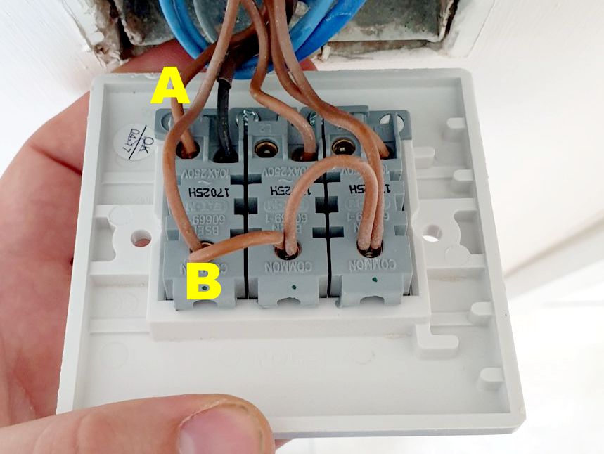

At the 3 gang switch:
Disconnect the wire A, and put it with the other wires at B. (3 wires in the same terminal).
At the other 2 gang switch:
Disconnect wire C, and put it into the terminal D with the other wire already there (2 wires in the same terminal)
Disconnect the wire at E and put it into terminal F
Wire G for the outside light goes into terminal H
Neutral I into the terminal block J
Earth K into the terminal block L, it should have a piece of green/yellow sleeving on it.
The left switch will do nothing.
The right switch is for the outside light.
If you want to change to a single gang switch later, then the two wires in D will need to be connected together with a piece of terminal strip, and the wires to F and H connect to the new single gang switch.

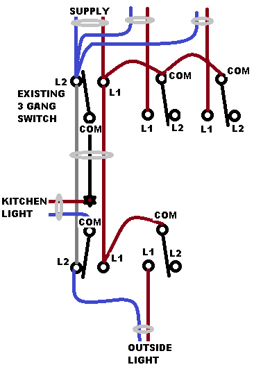

I followed the post above to get one switch working constantly for the back light. I've seen the diagram above by Sunray but slightly confused by the diagram and how that relates to the wiring I have. I.e which wire is which
That diagram from Sunray is very interesting, I'm still tracing it out to see if it works properly with every switch movement...
With Sunray diagram it appears as you operate the kitchen two way switches, the live and neutral at the kitchen light become reversed. I THINK.
So if the lights are capable of having their polarity reversed and still work properly, and nothing else has been tagged on to them, this would work. I THINK.
That genius Sunray is a clever bugger - not sure if you should attempt it mind, also don't know what the builder's electrician would have to say!
It does. Which of course is dangerous and should not be done.
The two way switching in Sunray's diagram does in theory work, in days of old it was often used with Live and Neutral looped to all the switches in the house.
BUT in those days change over switches had about an inch of separation between the Live and Neutral connections ( L1 and L2 ). The arc formed when the switch was operated could not reach from Live to Neutral. Modern switches have about 3 mm of separation and the arc can bridge the gap and continue to exist long enough to damage the switch,

Switching in the neutral hasn't been permitted since at least 1939.
Would the arrangement technically be classed as switching the neutral?
Yes, because in some of the configurations the lampholder remains live even when off.
In the worst switch arrangement, the light is on, then the neutral is disconnected and then connected to line instead.
Doesn't comply with identification of conductors either, as what is line / neutral changes depending on the position of the switches.
