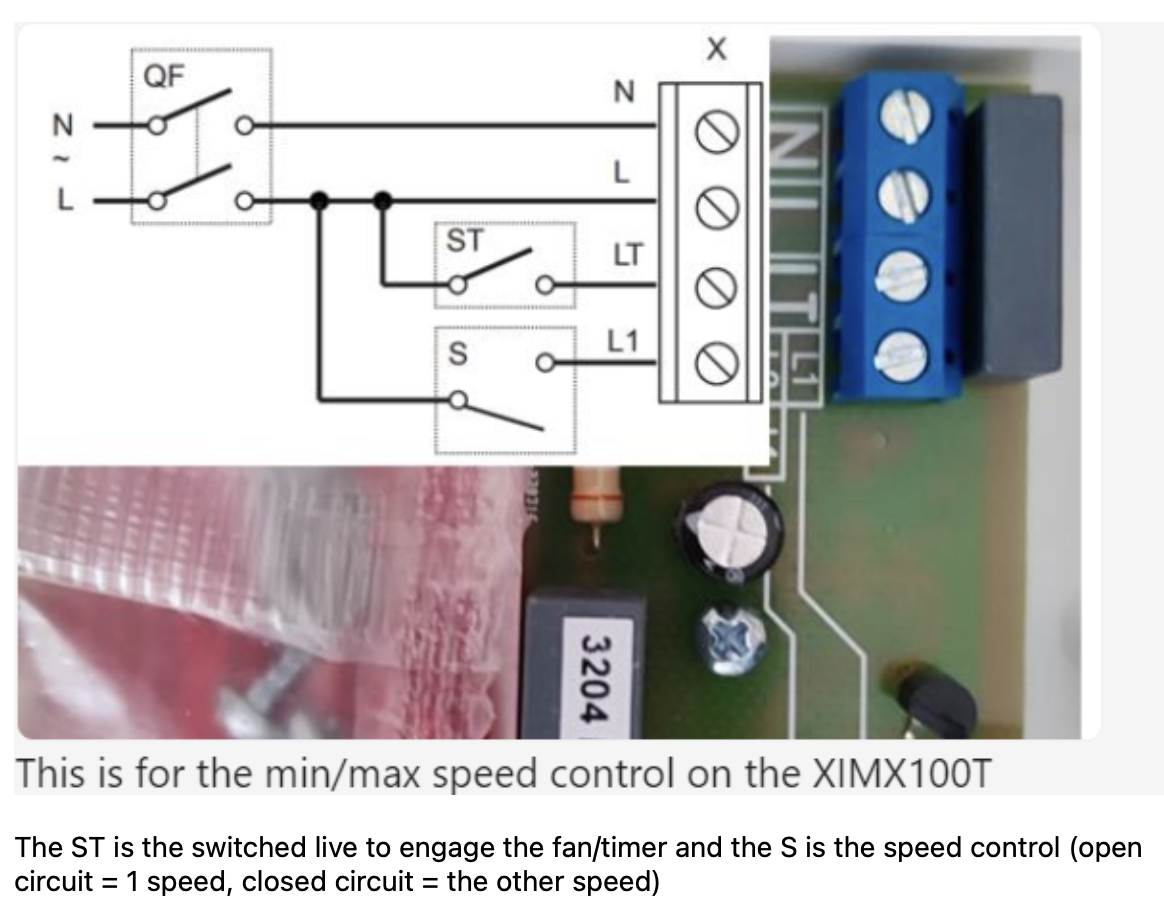

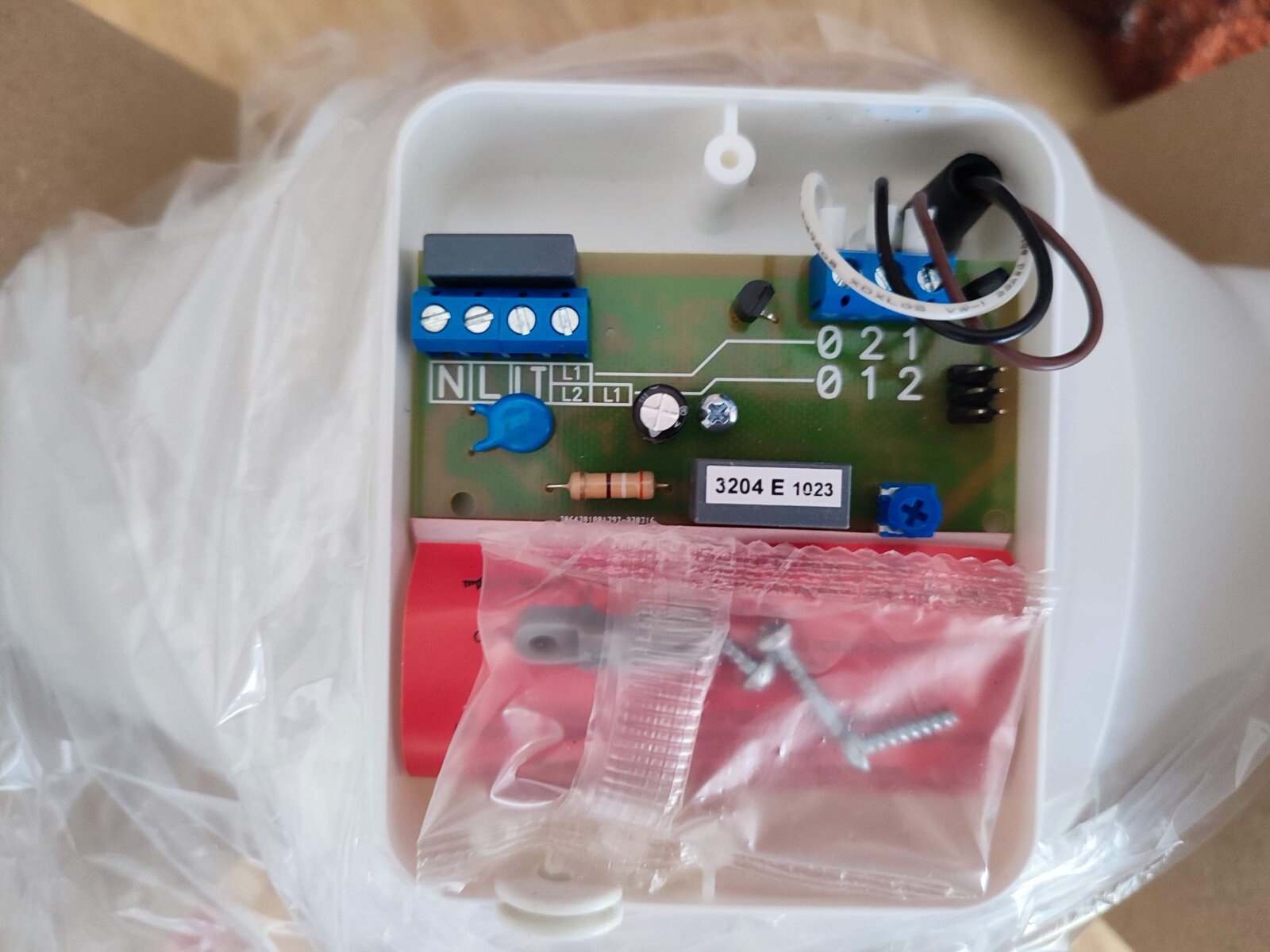

Can someone please clarify what Xpelair has told me:
1. I sent the first photo asking what connection creates the maximum speed.
2. Xpelair sent the second photo and comment.
3. Third photo is the diagram for the model I have from the manual.

Diagram 22 shows the MIN speed connections.
For MAX speed disconnect L1 wire - or fit a switch 'S' as per diagram 21.
ST will be your light switch if you wire the timer fan in the normal way.
