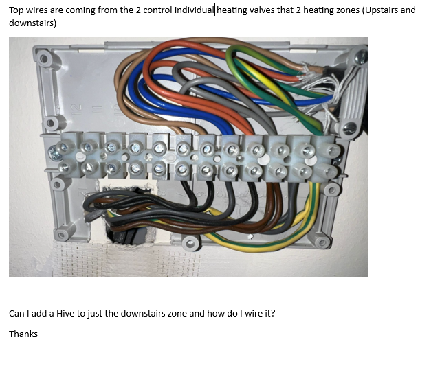

HI I am looking for help on the above and if can use Hive on just one of the zones? thank you for any help i have two thermostats and not sure what to do when I look at the ebus on the boiler

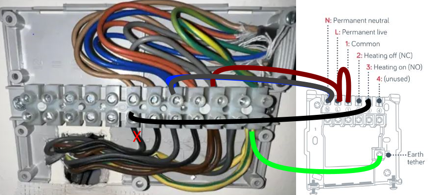

Is it possible to add the Hive here?
Ok Thank you anyone else who can help don't want to get it wrong :)
Presumably the two valves are controlled by the two single brown wires - first two along the top.
You will have to determine which.
Just to confirm - you do have a single channel Hive?
Yes all the top wires are coming from both values. I am trying to understand how to wire in the hive to zone one I can trace which one is for Zone. At this stage it will just be the hive for one zone unless there is a 2 channel hive. thanks
ahh ok, I just want the one zone at the moment, would you know how to wire it from the block above?
Just confirm that only the brown and black are connected at the thermostat.
That is - the cable goes nowhere else.
If so, then do this to the appropriate valve's brown wire.
Remove the black wire marked X and also the brown, grey and green&yellow that come from the same cable.
Don't forget it might be the next brown connection that is the correct one for the valve in question.
Sorry just to check :)
I got to remove the black and connect to 3 (heating on)
Then link blue to N (like a Spur)
then link grey/brown to Perm live (like a Spur) with a link to common.
is that correct?

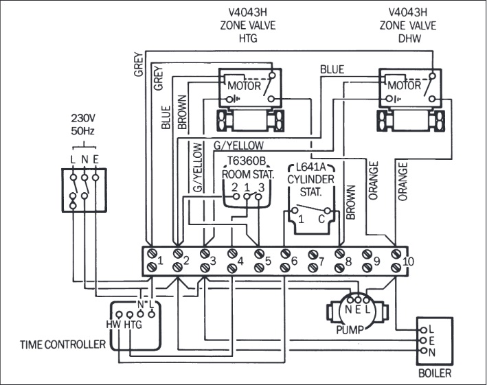

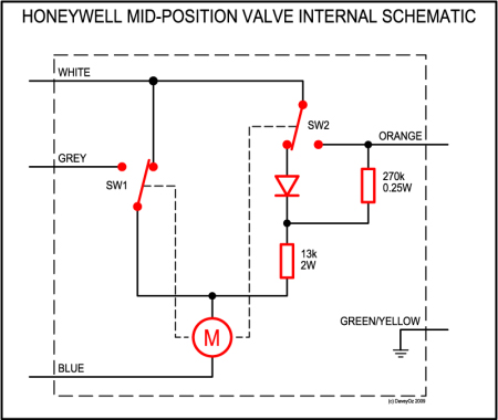

mid-position-valve.jpg This is the Y Plan mid position three port valve, the two port valve is easier, S-Plan.jpg there is also C and W plan, if S Plan which seems most likely then we have brown, blue, grey and orange and the thermostat feeds the brown wire.
You have two brown wires, one for each zone, so if you connect both browns together the thermostat will turn on both zones, and the TRV heads will work out what to heat and when.
is that correct?
Yes, that seems correct.
If you have a go at the wiring, post some pictures here, and we can confirm, before you turn the power back on! :)
However, just removing the black wire isn't enough - if you don't do any further modifications to the wiring, it will still be a switched live wire from your existing thermostat - park it safely in one of the spare terminals on the left of the wiring centre.
If you can also trace the brown wire from that same cable, you can park that in a spare terminal.
That should, theoretically, decommission the mains cables to your old thermostat.
Is your existing thermostat battery operated? - the grey wires from the cable are already isolated in the terminal, second from the right.

You mention ebus, but we don't know if your existing thermostats use it. There is definitely a switched live, back to your boiler from the wiring centre.
Can we have a peep behind your existing stats to confirm?

Far more likely to be a combi with dual zone heating on a new-build, built after 2014, with that wiring centre.
