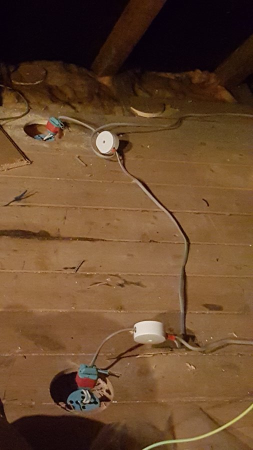

I take its okay to run 2 lights off one fused spur?
Hopefully it'll put would be burglars off, along with cameras eventually
Sure, why not.
By the way. if you are to interlink the lights (ie both come on if either PIR detects movement) then
1. You would need 3 core and earth cable beteen the lights
and
2. Make sure you buy PIR lights that can be interlinked.
Could I connect it off one of these and fit a fused spur as these seem to wired into a rcd unit above email bathroom for the spotlights
Mean I could drop the cables down from eaves to locations.
Cheers

Could do with some clips to provide strain relief at those junction boxes.
Cheers
Yeah doesn't look the best job, wiring all over the loft.
Hopefully in 2-3years im going to get a spark to rewire my house, so I know its safe. Im getting a new garage built and want power so im assuming im going need my fuse board changed to a consumer unit, and a rcd fitted and then dig a new trench to my garage round the house so its safe,
Cheers
Better to get the garage supply off the house CU completely - tell your electrician you want him to split the tails and put a switchfuse in.

Sorted it all at the weekend, fed from a socket on the ring main through a fused spur then direct outside, rang the cables to the lights via waterproof connection box so I can tee all three in, I decided to have sensors working separately
