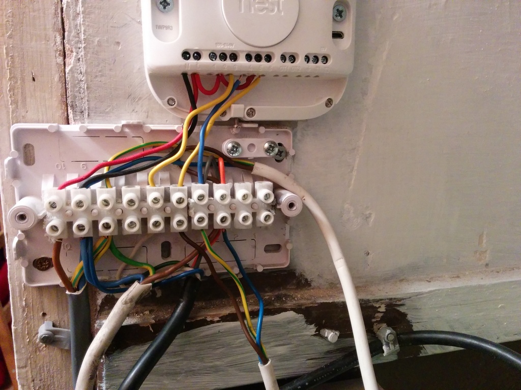

I have followed the various diagrams for a Y-Plan system, and I have made every effort to wire this correctly. Please can you check over my wiring before I switch on. I intend to control both HW and CH

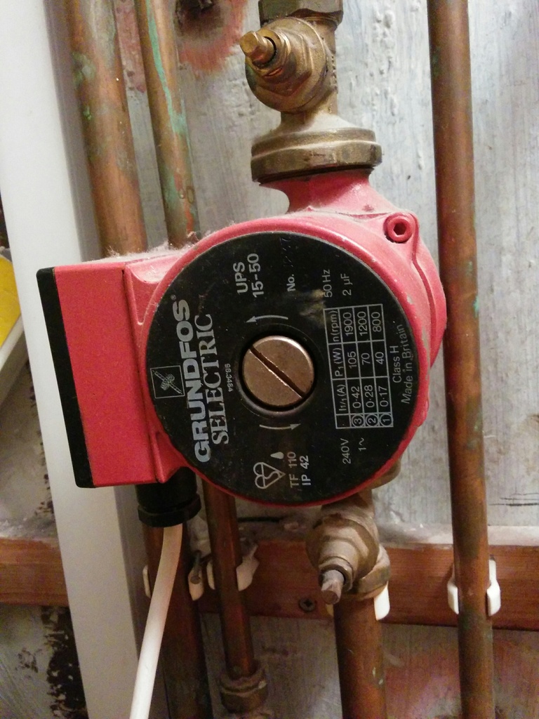

Also, my Baxi boiler fitted by BG in july 2014 downstairs does not seem to be connected to the wiring upstairs in any way. No RF receiver/transmitter is immediately apparent, do I need to run cabling down to the boiler or does the pump somehow signal the boiler?

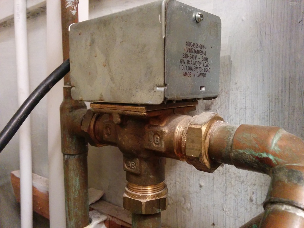

Cabling from left to right on the image below, FUSED SPUR, TANK, VALVE, STAT, PUMP
I fully intend to tidy up my wiring once confirmed.

You will need to run a cable from the junction box to the boiler, we need the model of the boiler to see if the pump has to wired to the boiler, this will show how many cores the cable will need to be.

Your wiring looks ok but that don't mean anything as I am not there, (your responability to double check all is ok) if you have to run a new cable to the boiler use 5 core, you only need 3 core but if you have to change the boiler in the future the extra cores will come in handy.

Anyone see issue with the wiring now?
Do the three cores from the boiler mirror the pumps? The boiler has its own fused spur downstairs now, idk if it had that before or not.

The fact you have a CPC connected to a line conductor is not a good sign. Do not power the system up.
edit: Is that the immersion heater connected directly to the relay on the nest??? Do not power the system up.
Yea my bad mate, I never noticed you had the immersion heater connected to the nest.

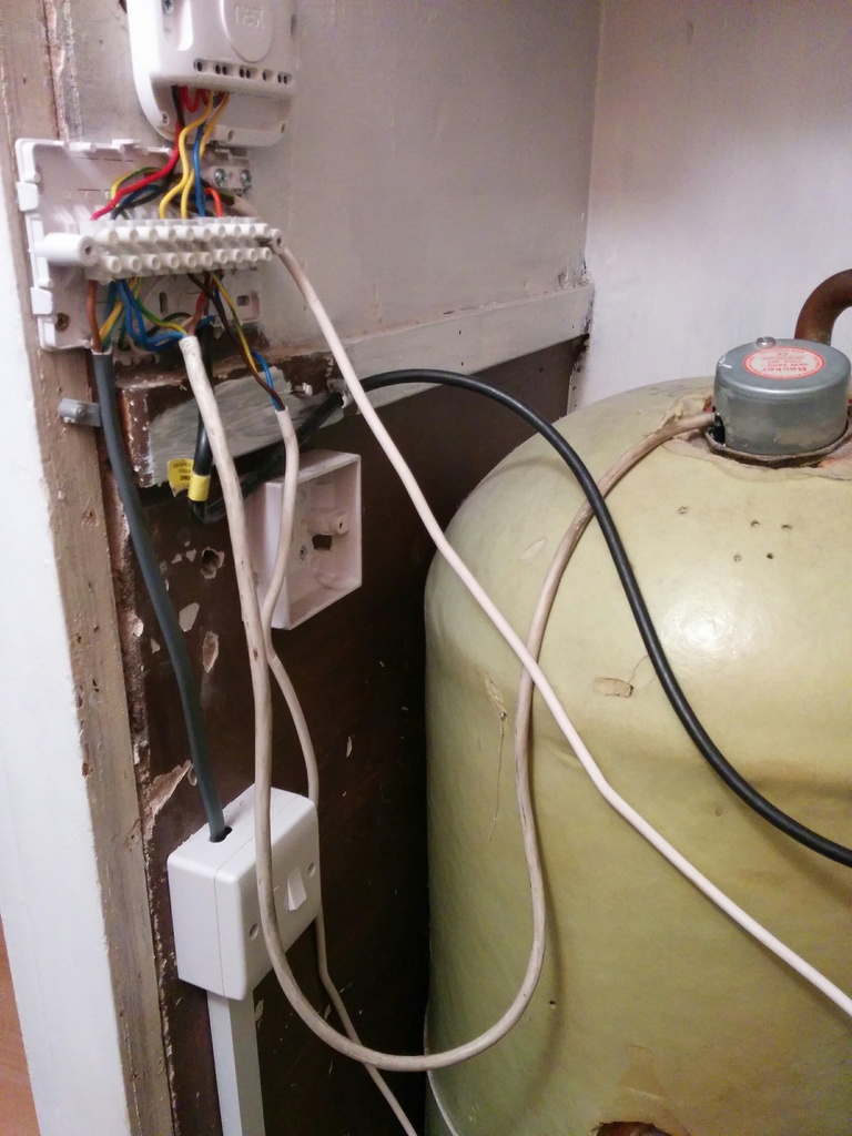

The "electrician?" should have wired the immersion heater (that's the silver box on top of the HW cylinder) to its own 15A spur fed directly from the main fuse board. What is the purpose of the empty box above/right the spur?

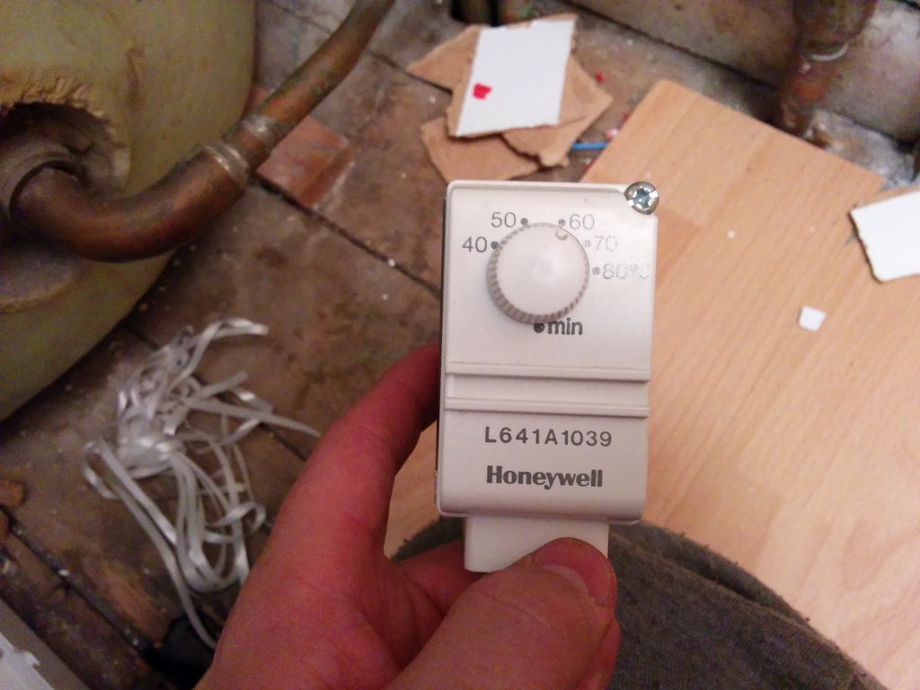

You are holding the cylinder thermostat, which doesn't appear to have any wire connected. What's that all about?

The "electrician?" should have wired the immersion heater to its own 15A spur fed directly from the main fuse board. What is the purpose of the empty box above/right the spur?
The electrician provided me with one spur, which feeds into the ten way junction box. This is a direct replacement of the box you see empty, which I am told was a single socket with isolation switch.
The stat I am holding in the image is one that requires no drilling or draining of the tank. Instead a small section of the insulation has been removed and it is held touching the metal tank with a wire that goes around the tank like a belt. It's just been taken off for the purposes of the picture mate. I assume the heat transfer between the plate at the back of the stat and the bare tank is sufficient
What was the immersion heater cable originally connected to? Even an electrician unfamiliar with heating systems wiring should know that an immersion needs it own 15A supply. The heating system needs a 3A fused supply, normally from the ring main.
Who connected the immersion heater to the junction box? I hope it wasn't you!
Why is the stat you are holding not wired into the junction box? It controls the temperature of the water in the cylinder.

Your electrician may have done a brilliant job; it would have been even better if he had arranged for a knowledgeable heating engineer to deal with the heating side.
