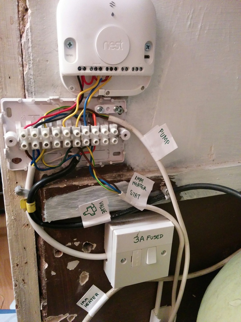

So if I provide 3A fused mains to the 10-way junction box at 1,2,3, and I connect the immersion heater to the spur provided we are fine from a mains current point of view?
The boiler downstairs must then connect to the 10-way junction in the connection in connections 2,3 and 8? Instead of the immersion heater setup I currently have?

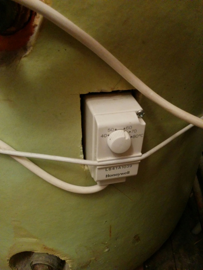

Why is the stat you are holding not wired into the junction box? It controls the temperature of the water in the cylinder.
It is connected mate, to connectors 6,7 and 8 on the 10-way which I traced to C,1 and 2 on the stat correctly? See image above. Does this thermostat talk wirelesly to the immersion heater then?

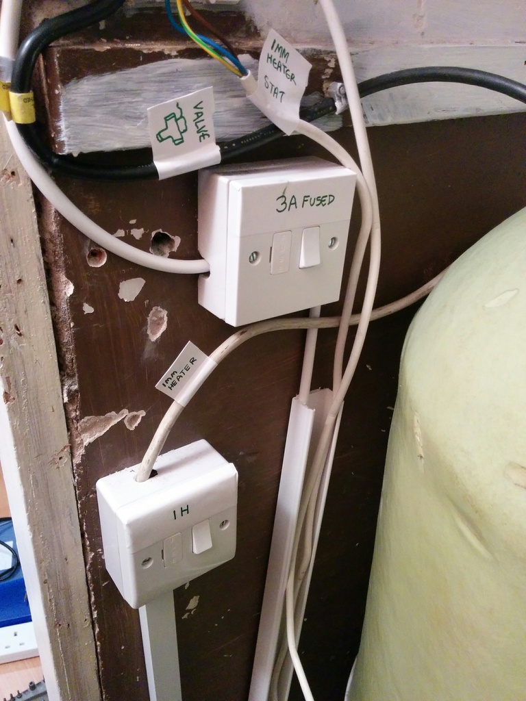

I've disconnected the Immersion Heater from the 10-way junction, and provided it the spur to itself.
I've also fed to that empty patress on the wall from the RM and changed its fuse to 3A.

Hows the wiring looking now? Boiler now has 3 core mains flex going down to it, will leave it as 3 cores for now. Does this connect to 2,3 and 8?

FFS mate seriously get a pro in to do this for you as you're clearly out of your depth! Your wiring skills are appalling, no strain relief on any of the cables, colour coding all over the place, too much exposed copper on show on some connections and i dread to think how you've supplied power to that new 3amp switched spur. Never ceases to amaze me how many people will 'have a go' at electrics when they have absolutely no idea, yet they would never touch gas 'as that's dangerous'. I'm not saying this lightly but please for you and your families safety get a pro in to wire that up correctly and safely for you, I doubt it would cost all that much either if you find someone local.

The spur is unlikely to be compliant with the wiring regulations. You must use 2.5mm² from the ring final to the fused spur. 1.5mm² may be acceptable if the length and mechanical protection afforded is acceptable. From the FCU to the junction box, the flex is fine.
I would not be happy with the single insulated cables between the junction box and the Nest, the flex to the cylinder stat should be replaced with 4 core - Green/Yellow conductor must never be used for anything other than the CPC.
You still need to supply the boiler. Too much copper is on show at the terminals on the Nest.
The rest looks like it could be OK, but I would suggest you sort out the basic issues first (mixed wiring colours etc)
The immersion must be supplied by a separate connection fed directly from the consumer unit not from the ring main. There should be an outlet on the consumer unit labelled Immersion with a 15A fuse.
PS The cylinder thermostat does not talk wirelessly to the immersion; the two things are completely independent. Normally the cylinder is heated by boiler water passing through a coil in the cylinder. The 3-way valve controls the route taken by the water (radiators, coil, or both) The Honeywell cylinder stat stops the flow though the coil when the cylinder water is up to temperature (60C). The immersion heater is just a standby, in the event of a fault with the normal method of heating, e.g a faulty motorized valve.

If this is the case, you should not be supplying your new arrangement in the way you have. There should be one common isolation point - i.e. this complete setup should be powered from the FCU at the boiler, and then you need to feed the boiler from your junction box.
Okay, I can do this easily enough.
So just to confirm, the Immersion Heater remains on the 16A fused spur upstairs.
The 3A fused isolation switch I fitted upstairs on 2.5mm to the ringmain is now disconnected and takes its feed from the isolation switch by the boiler.
Then I run flex from the boiler to the 10-way junction box, connections 2,3 and 8

I've re-attached the thermostat back onto the Immersion heater also.
Just read that; and I am very concerned.
If you are talking about the Honeywell L641A thermostat, DISCONNECT IT IMMEDIATELY from the IMMERSION HEATER. The immersion heater, which has its own thermostat under the cover, is connected directly to the 15A spur.

I've updated all the wiring as above. This includes the spur downstairs, which now feeds the 10way, the nest, and the boiler as discussed. Thanks for all your help on this guys
Just read that; and I am very concerned. If you are talking about the Honeywell L641A thermostat, DISCONNECT IT IMMEDIATELY from the IMMERSION HEATER. The immersion heater, which has its own thermostat under the cover, is connected directly to the 15A spur.
I've just reattached it to the side of the tank mate, i just used the wrong term sorry. It's not connected to the wiring for the Immersion Heater, nothing is.
