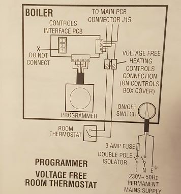

Post a picture of the electrical connection diagram for the boiler
Ditto for the NEST

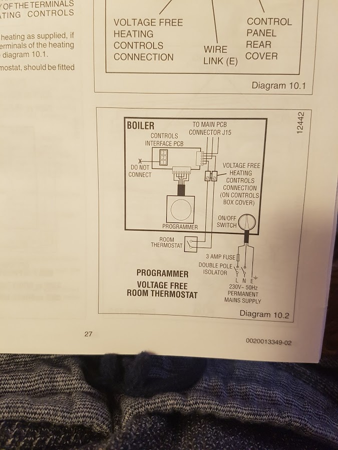

Step one read the instructions for boiler which on page 23 shows volt free on/off control, I have looked for the opentherm connection and as far as I can see the boiler does not have the option of an external control page 30 confirms it is a modulating boiler, but like many it seems it can only be modulated by the return water temperature.

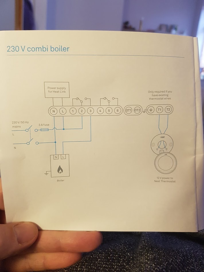

So back to your boiler it seems there is both a no volt and a mains voltage option. I would use the volt free option. It would seem 2 and 3 on Nest replaces the link on the boiler. But consider where to fit and if TRV heads will be added latter, clearly if a TRV head is to be added to living room radiator then the Nest thermostat should not be in that room.
If the Nest is to be using standard mains switched control (which is the only thing Nest supports if the boiler is not OpenTherm compatible) then the Heatlink acts like a standard 240V switched thermostat. You should follow diagram 12440 on page 28 of the manual.

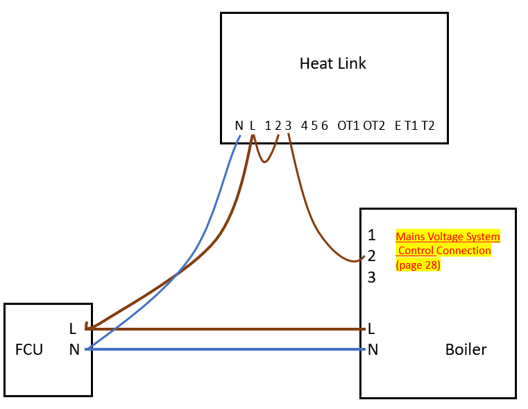

It appears for your boiler you need the following:
1. Ensure the boiler circuit it isolated at the Consumer Unit.
2. 2-wire flex from the boiler FCU load terminals (or alternatively the line terminals on the boiler L+N) to the Nest Heat Link terminals L+N. Caution - 240V.
3. An insulated jumper wire from L on the Heatlink terminals to terminal 2 (common) on the Heatlink terminals. Caution - 240V.
4. 2-wire flex (only using 1 wire - or single wire flex if you can find it/have it) from the Nest Heat Link terminal 3 to the boiler "Mains Heating Controls Connection Plug" terminal 2 shown in diagram 12440. Caution - 240V. If using 2-wire flex, best practice would be to connect the spare conductor between Earth on the boiler line terminals to Earth on the Heatlink terminals (sheathed in yellow/green).
5. Optionally, 2 wire flex/T+E from the Heat Link terminals T1 and T2 to carry 12VDC to the Thermostat terminals T1 and T2. OR you can power the thermostat from the 5V USB connection and skip this.
Alternatively - if you can't get two wires into the L terminal on the Heatlink in step 3 (they are small) use the other conductor of the wire in step 4 to connect the L line terminal of the boiler to terminal 2 in the Heatlink.
You can of course substitute the multiple 2-core flexes with multi-core flex. If using the jumper method, you could replace the other two 240V cables with a single 3-core flex and use the insulated earth conductor as the terminal 3 connection - however you MUST clearly mark the cable with brown sleeving at both ends as it will carry 240V. Just make sure you know what is what, personally I always avoid putting 240VAC and 12VDC down the same flex to avoid the possibility of mistakes.
Provided without warranty - check this yourself before powering.

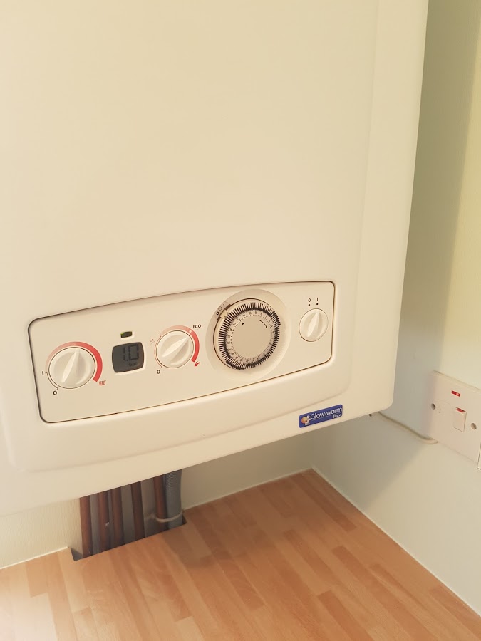

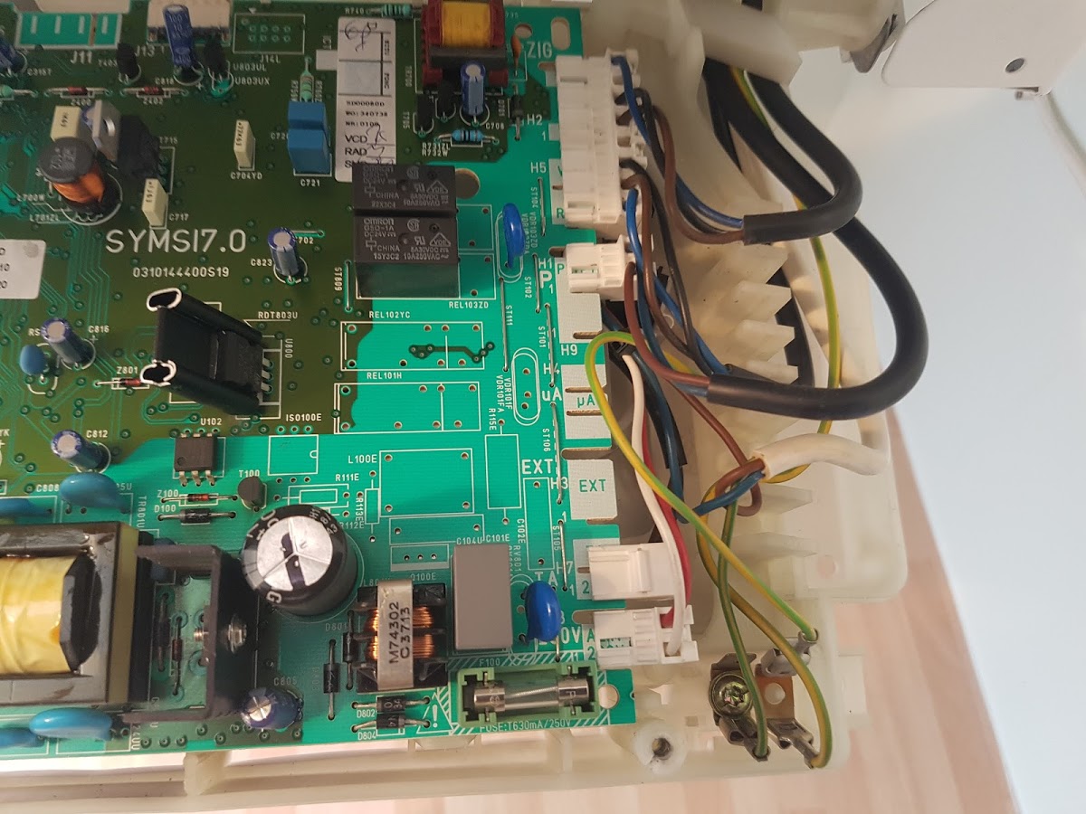

Thanks for the info everyone. Belated photos attached. The mains in is the white whire and seems to terminate at the on/off switch at the front of the boiler (ie behind the PCB)
Based on the diagram you posted which I have copied below.
Connect the Nest Heatlink L N & E to the "permanent mains supply" L N & E, so that the Heatlink is powered from the same fused spur as the boiler.
Then the two wires from the "Voltage Free Heating Controls Connection" shown going to "Room Thermostat" connect to the Heatlink terminals 2 and 3. [if there is presently a link between the 2 terminals, that should be removed] It doesn't matter which way around, and that's all you need to do. Do not add any links.
The boiler built in timeswitch should be set to be permanently 'on' 24/7, so that the Nest can take over control.
Oh what a horrible way to do wiring - having all those board plugs instead of screw terminals makes it harder.
See my post above. Because of that board you will need to use the FCU load terminals to get the L+N wiring to the Heat Link. Then a jumper from 'L' to '2' (Common) on the Heat Link.

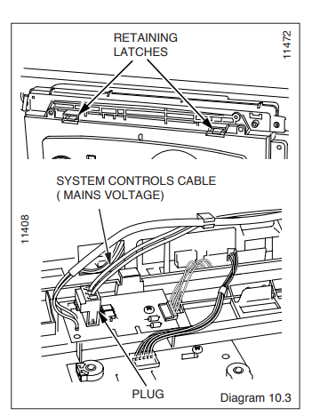

Then you need to find the 'controls interface board' mentioned on page 28 of the manual (it sounds like its a separate board) and follow this instruction from the manual:
"Remove the MAINS VOLTAGE HEATING CONTROLS CONNECTION PLUG from the fittings pack and install on the control interface PCB as follows"
If you don't have the fittings pack, you might be out of luck.
Then I assume, there will be bare ends on the other end of the supplied connection plug wire, which you can put into a terminal block and attach terminal 2 on the connection block (the middle one) to terminal 3 on the Heat Link.
The boiler design has made this more complicated.
I am not sure this works - AFAIK the Heat Link switched connections are designed to work on 240V load, not 'voltage free'. This might work, and shouldn't do any damage if you try it. My method will definitely work.
However don't mix the methods, if you connect 240V to the voltage-free terminals it will fry the boiler electronics. As it says here:

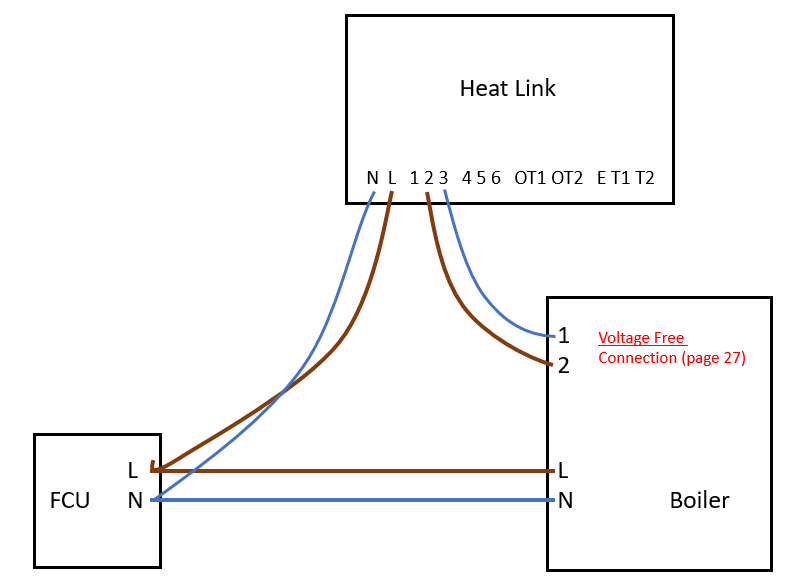

Don't worry it works. Terminals 2 and 3 of the Heatlink are potential (voltage) free contacts i.e. just a switch. They do not get any voltage from the Heatlink, and perfect for use with the "Voltage Free Heating Controls Connection" as shown below:
Ignoring the optional satisfied terminal (which isn't required, and shouldn't be connected) and you will see that the Heatlink provides exactly the same function as the OP's diagram from the boiler manual. It's just a switch.
However you are right when you say:
Which is why I made the stipulation earlier about not adding any links between the Heatlink terminals. That is so that the 230V is kept completely separate from the isolated switching circuit that uses terminals 2 and 3.
Don't worry it works. Terminals 2 and 3 of the Heatlink are potential (voltage) free contacts i.e. just a switch. They do not get any voltage from the Heatlink, and perfect for use with the "Voltage Free Heating Controls Connection" at the Heatlink as shown below:
Fair enough. Your method looks easier then!
So just to avoid any doubt. Either do this:
(voltage-free switch method - NO JUMPER)
OR
This (240v switch method)
But do not mix the two.
All things considered, Stem's voltage-free method will be easiest with this boiler.
