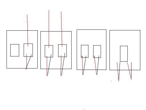

ok, so power off, take the red and black from switch 5 and connect together in a connector block..
now, take out the wires from 6 and 7 and with the multimeter set to ohms or continuity, test between the red and black of each wire.
the one that reads close to zero or bleeps is the one that goes to switch 5.. mark it with some tape or something..
report back when you've done that.

right coljack lets have another go thanks for your reply, this is where i am
on this drawing switch a gang 1 is complete which switches upstairs hallway 2 way with another switch. Switchs 2 and 4 are also working correctly 2 way for the hallway wall lights. 4,5,6 and 7 need sorting. I have belled through the cables and found that the red/black at 3 goes to switch d on my last drawing. The other red/black at switch d goes to 5 on switch c and the red/black on 6 at switch c goes to under cupboard wall lights.
your drawing is useless without numbers.. and is different from your last drawings so be consistent.
View media item 21294
you appear to have left off a switch and added another one..
you've missed off switch labled 1 in my picture and added another switch 8 to the end..
i left off the completed one and there is another switch in the kitchen which i forgot because its never used but obviously needs to be taken into consideration sorry

OK new drawing.. I'll use my numbers and letters..
the switches ticked are working correctly yes?
right..
switch 4, cable A goes to switch 8 cable E or F?
switch 8, cable E or F ( other one to above ), goes to switch 6, cable C?
switch 7, cable D goes to the under cupboard lights?
now.. with the ends all made safe into terminal blocks, turn the power back on and set the multimeter to 250Vac..
do those wires have earths? are they connected to the backbox?
if they are then put the black lead on earth and test with the red lead on all of the reds, including the one in the com of switch 4
make a note of any that are 230 or more volts..
now many holes in switch 8?
